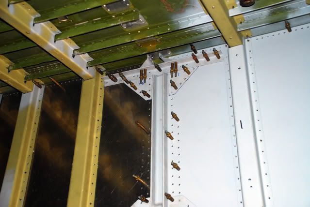

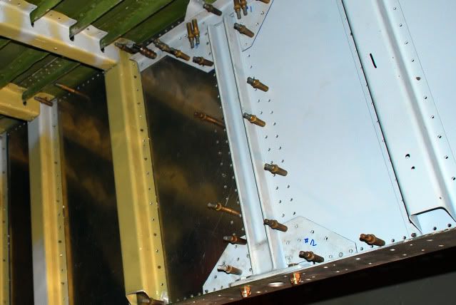

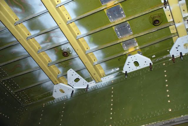

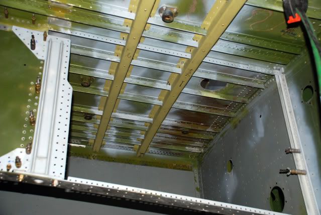

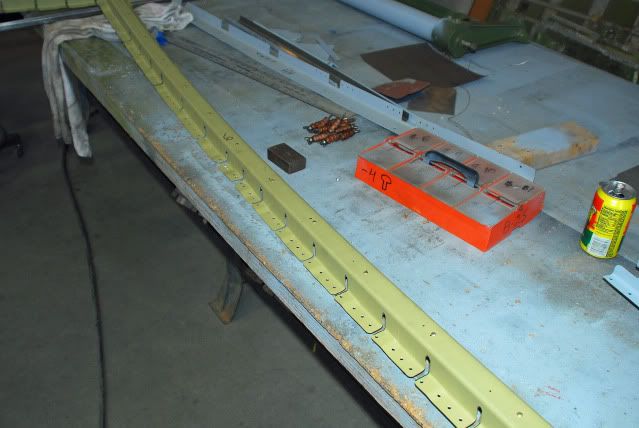

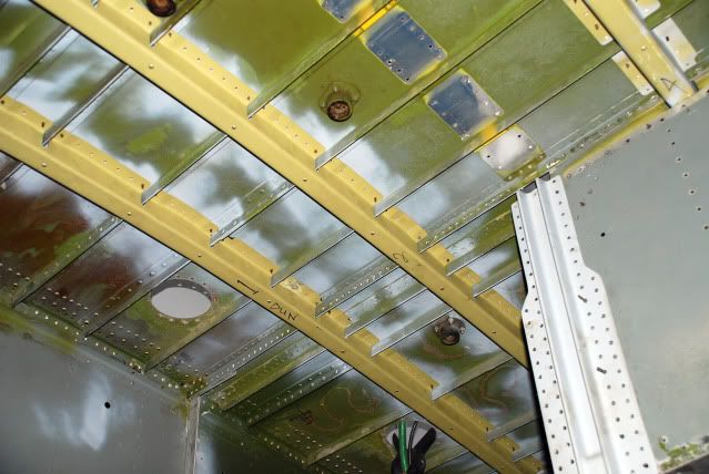

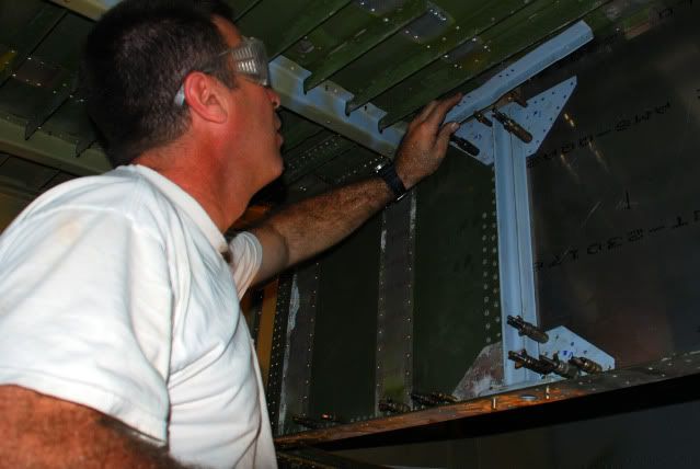

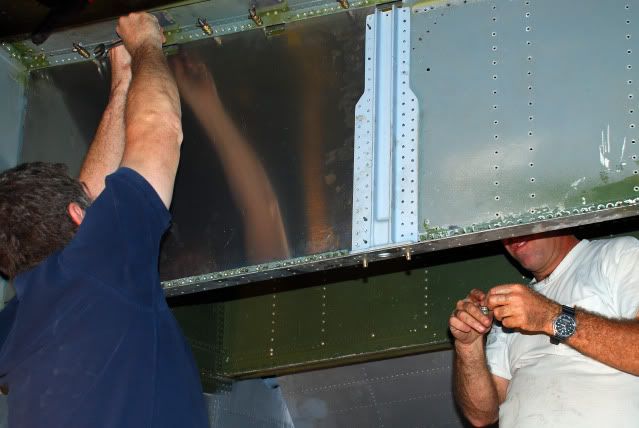

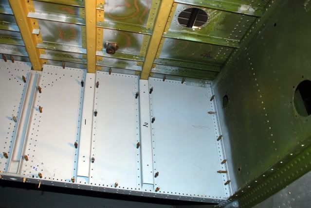

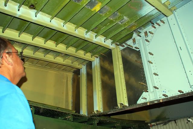

Now while all this was going on progress continued on the PBJ. This is an attempt to bring folks up to speed. As spring turned to summer we finished rebuilding the right wing. We need to attach the wing to the airplane to drill out the new attach angle but before we can do this we have to rebuild the structure in the left fuel bay.
If you have been following this thread you know all about corrosion and that the worst area we found was in both main fuel bays. We spent over two years rebuilding the right bays thinking that the left side was good to go. Well once we started looking at the left side we found we weren’t going to get off quite that easily. We had to replace six hat channels and two webs. This little job has taken all summer to get to the rivet shooting stage. After we finish with the bays we will once again have enough structure to move the airplane. We plan on hanging the right wing in a few months as well as getting the wiring done. Soon we will start surveying the left wing. If it is in the same shape that the right wing was in that will mean another years worth of work on that assembly. Meanwhile work on the nacelles and the nose flooring and several other projects goes on. We have a great crew and one day I hope to look at the parts storage shelves and find them empty!

We had a big crew this week and made good progress. We are focusing on getting the bird ready for the electrical wiring. The fuel bays are now finished and ready for paint. We will get the right nacelle back in place in a few more days. We pulled the nose back off to give better access for the wiring. We still have quite a few little details to finish before we can wire but we are getting there!

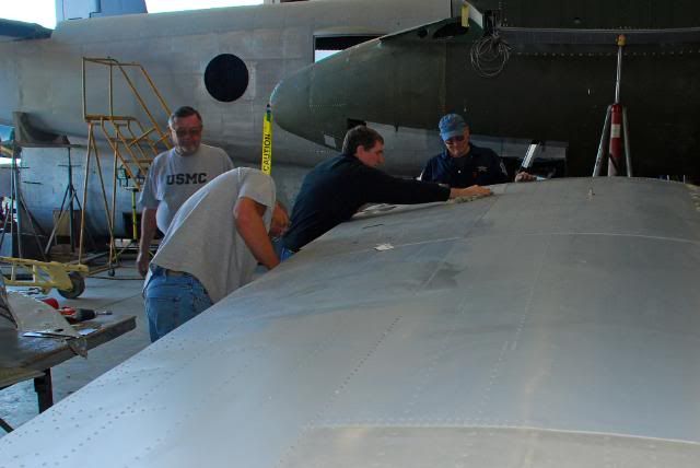

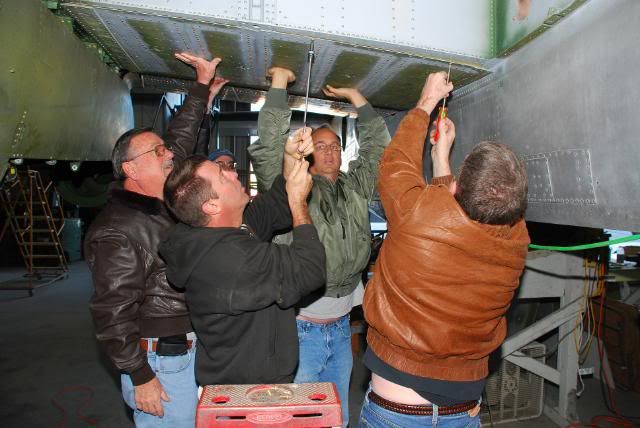

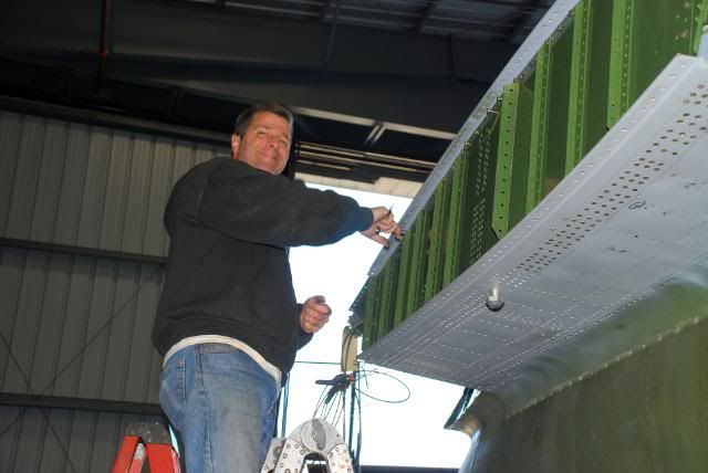

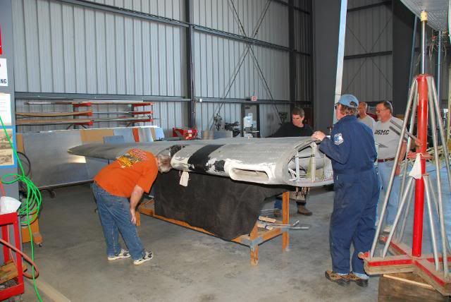

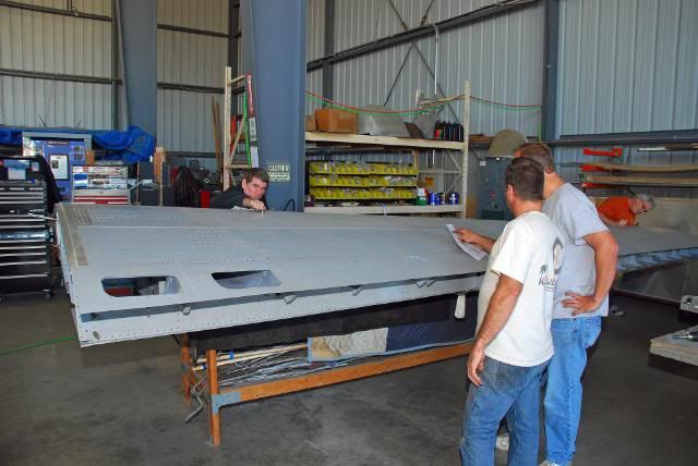

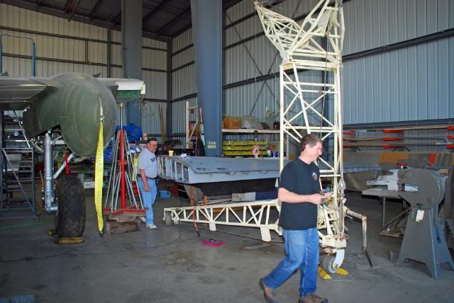

Unfortunately the web crash on this site wiped out two months of updates and pictures. Yesterday we started to set up for our right wing installation that should take place next week. I love putting big parts on airplanes!
