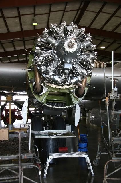

Would you be able to post at one point pics of the engines without the cowlings on of both the new & old set-up side by side ? Will make for an interesting point of view.
I am mostly curious to see all the changes related to the custom exhaust and how much it also affected the nacelles.
Again, tks for sharing

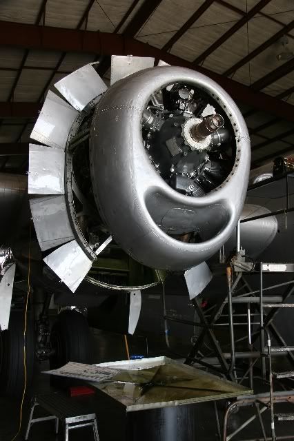

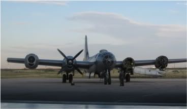

I know this isn't what you are looking for but my wife took this shot and noticed that it represents all 4 engines in different stages of disassembly or reassembly, as is the case with #3.
When I have the #4 cowling off, I'll get pictures of that and the new engine for you.
Dave

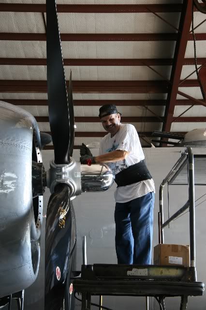

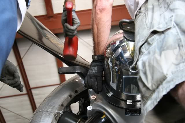

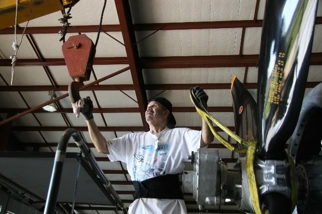

Well the test run is complete and now it is time to put the finishing touches on the number 3 engine. This is a typical day for us here in the ol' hangar. It was decided that all the holes in the cowlings (where the old front facing exhaust used to go into the cowling) needed to be covered. We want to do this so that we can have maximum cooling to the engine. In order to do this, we had to pull the prop and the cowling. After spending quite some time rounding up the proper tools and getting them in the proper locations we were ready to begin. Rudy disassembled the cowl flaps from the control rods, and removed the nuts from the main hangars. (Yesterday we removed sheetmetal from the cowl and removed control cables etc.) Today we had Rudy, Dave and Mark in the crew. Rudy is the most photogenic in the group, so he gets to star today.
Here is Rudy preparing to remove the prop.
A little persuasion and the polished hub begins to move.
Dave drives the lift while Rudy directs. "Just this much more Dave!"

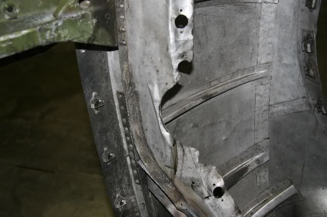

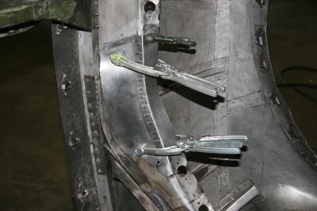

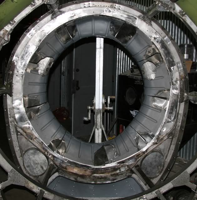

And here is the reason for the disassembly. Look at the cut out on the edge on the inside of the cowling. Air would go through this instead of through the engine. We want max air in the engine, so we need to cover up where the old front facing exhaust went.

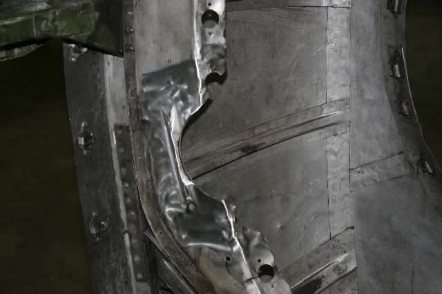

Here is where the repair will be. The metal has to be cleaned very well, so that we can spot weld new metal in place. It has been buffed and cleaned with solvent.

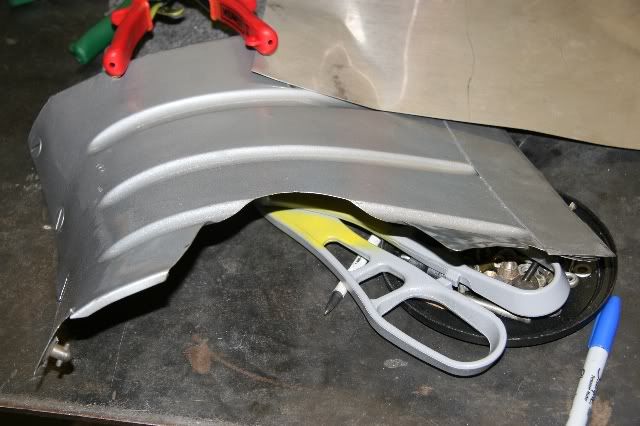

New sheetmetal parts had to be fabricated for each hole in the cowling. Here we show the new sheetmetal in place! One down and many more to go. Tomorrow we will start spot welding the new metal into place.

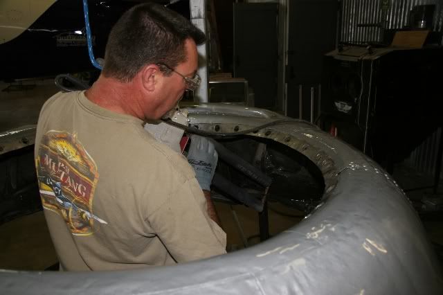

Well we have worked and worked, and worked. Doesn't look like it should take that much time, but the cowling is now just about finished with the air seal procedure. We used all stainless steel, and spot welded each new custom piece into place.

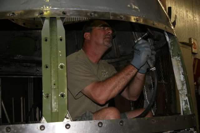

Each place the old exhaust went into the cowling had a new stainless steel plate installed. In order to spot weld the stainless, the cowling had to be clean on both sides of the weld. Here Dave is cleaning with a buffer pad.
Each new piece is spot welded into place. Here Dave is using a portable spot welder.

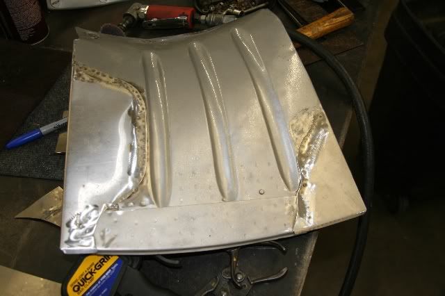

After the main cowling was done, the removable sheet metal parts had to be filled in. Here is one before the new metal was added.
The new metal is spot welded into place.
Wow, that was easy! Well maybe not so easy, but it sure sounded good.
Here is the completed assembly. Note the multiple new pieces of stainless steel. We still have a few cracks to fill, but we will get those soon!
