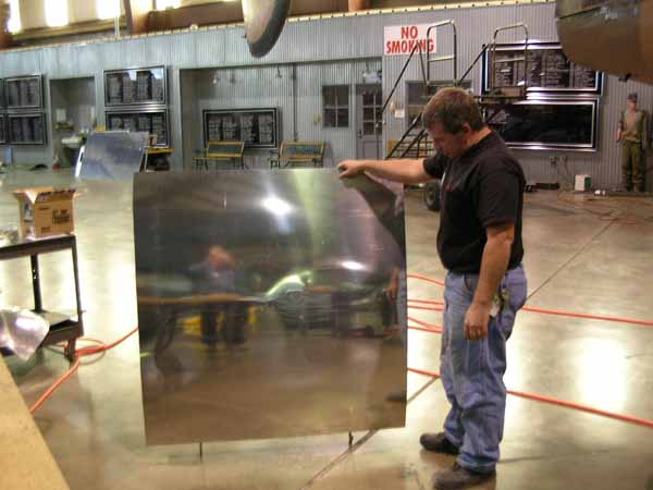

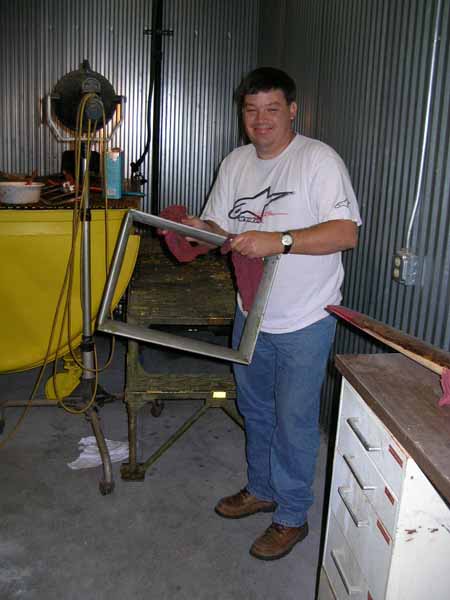

Just a quick update on Gary's continued work on the B-24. Today he had three helpers, one of whom is, if I got his name right, Jason Fisher, who is a WIXer from Midland - he was stripping paint like mad when I saw him.
Another helper was long-time B-24/29 member Shorty DeWitt but my photo of him didn't turn out due to some lighting and camera operator issues, however when I asked Shorty if I could climb in and where not to step, I loved his answer - "Don't step on anything that looks new!"
Gary continues work on the new crew door as seen here - or perhaps is it a fun house mirror? With Gary, we never know :D

Well, as you saw from Randy's earlier post, forward progress was happening this past weekend. The volunteers were doing some of the dirty, but much needed work and didn't complain once about it. Shorty DeWitt was able to get the inside of the airplane all lit up with a string of lights, and you gotta know is hugely helpful when working in the dark confines of a big 'ol bomber. Daniel Collier was one of my two main helpers that I had with the FIFI project and was here yesterday and today working. It's awesome to have him here helping with the sheet metal work. He has already finished the relocation of the radio operator's floor that I had previously started!
As for me, I am still plugging away on that stinkin' door. I know Randy posted a photo or two of it yesterday, but here's how the process has gone so far since the last update.......
I started raising the door to where the bottom of the left waist gunner's position will be by making the internal structure...........
The next thing was to make the outside skin for the door. I used .063" thickness aluminum (2024T3) for this. It's going to make the door heavy, but I will need the strength if folks are going to be walking on it. :?
The only real "custom" thing I've had to do to this skin was to make the cutout for the door handle and lock........
To make the holes in the skin, I just back drilled the holes from the structure. Most of these were located in such a way that I was unable to use a "standard" drill on this. I had to use what's called a "pancake drill." You can probably see why here.......
And here is the door with it's new height and new outer skin. Believe it or not, the latches and hinges still work the way they should. It's better to be lucky than good I reckon.......
