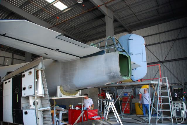

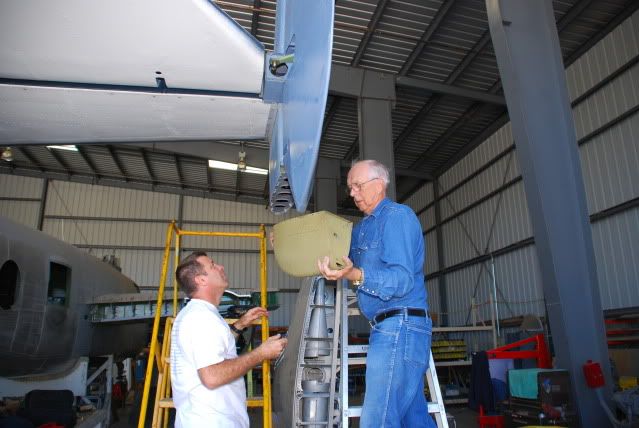

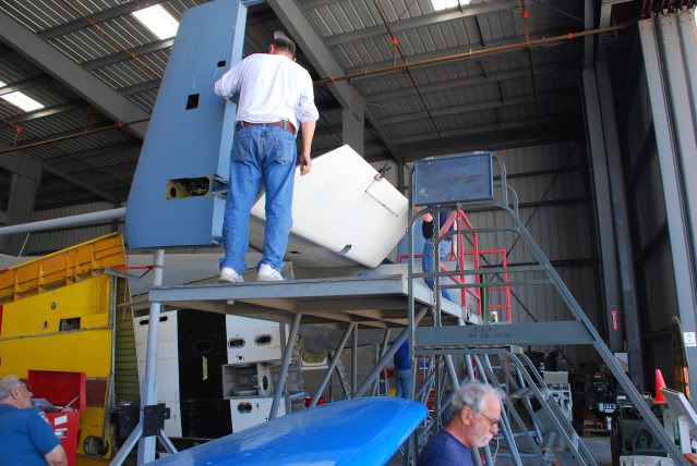

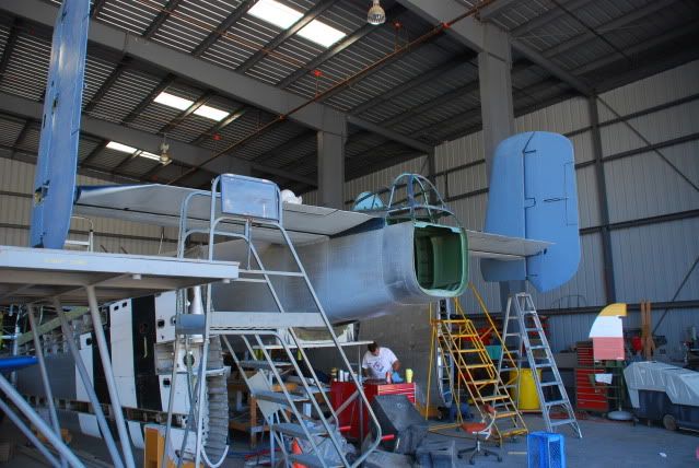

We worked slowly and carefully not wanting to mar the superb work done by our fabric department. Now Iran and Jerry can do their “cable magic” and start hooking things up. In a few weeks the rudders will go on. Jeff and I will go back to working on the right wing next Tuesday.

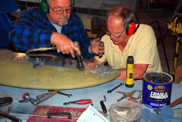

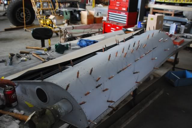

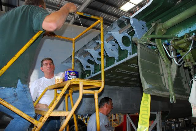

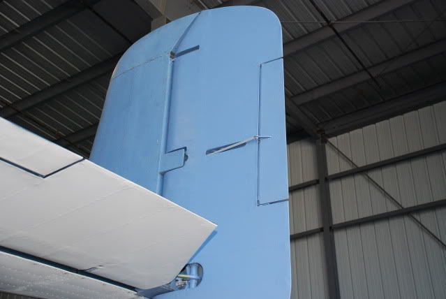

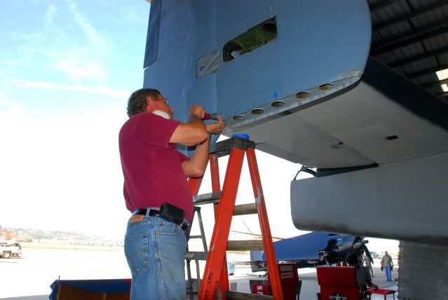

Marc and I worked on the right inboard flap assembly. We should be done with it in a couple more hours. When we opened up the assembly we found “ALCOA AUGUST 1944” stamped on it. We hung the right rudder last week and the left is soon to follow.

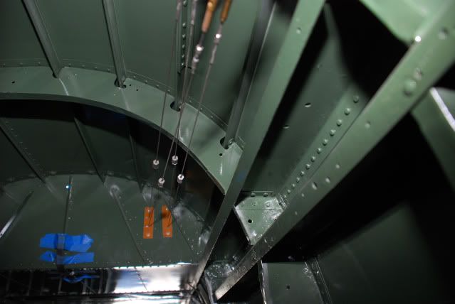

Work schedules, flight schedules, relatives, back to school, weddings, you name it is making it tough for the crew to get together these days. However Ken, the two Jerry’s and others have continued work on the bird. Both rudders are now in place and this last Tuesday Jeff, Scott and I hooked up the control cables to the elevators. Well in truth I really didn’t do much but watch Jeff hook everything up. Jeffrey was in his element. He just loves bolting things together. If Jeff has a wrench in his hand I advise you to get the heck out of his way before you find yourself bolted to something.

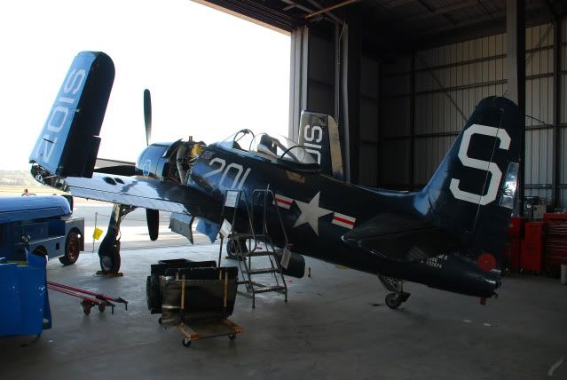

In other business our Bearcat is back home with the new engine! Gary Barber flew it last weekend and he was really, really pleased.
For you Spitfire fans. The Griffon is on the hoist! Soon, real soon.

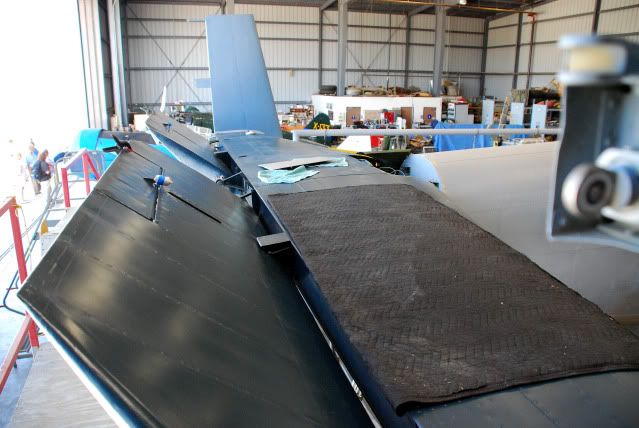

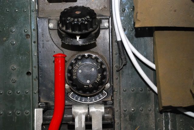

Things went very well for Jeff and I until I jinxed us by commenting that things were going very smooth, almost too smooth. For years the joke has been that when we finally hooked all of the cables up a pull on the yoke would actuate the ailerons and the rudder pedals would control the elevators etc., etc. Well never fear. So far things work as they should except for one small issue, and it isn’t as bad as the joke.
Cycling the elevator trim works great except the tabs work in opposition! I must admit I had to laugh. Jeff soon found the problem. The diagram in the book clearly shows that a twist in the cable runs in the right stab was called for and unfortunately had not been done. While I had visions of tearing the tail apart Marc and Jeff assured me that we wouldn’t have to take such drastic action. It shall be resolved as all our other problems have been over the years.

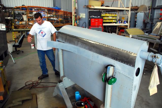

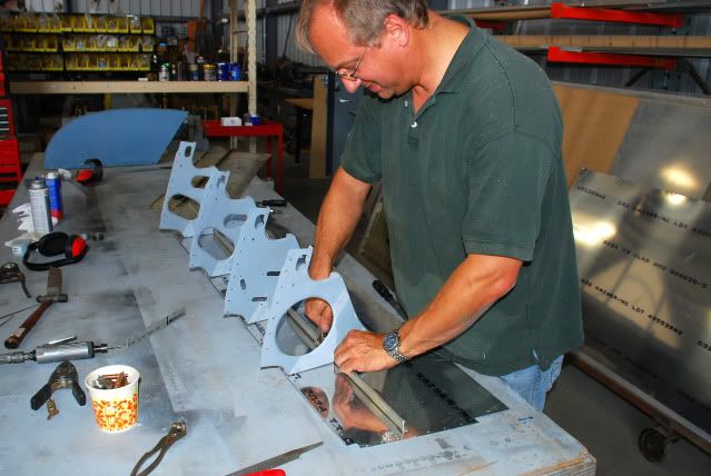

Scott and Marc continued work on the inboard aft right wing. Jerry-2 and Ken worked on the tail and Jerry-1 on the wing. Mike continued with prep for fabric on our right aileron.

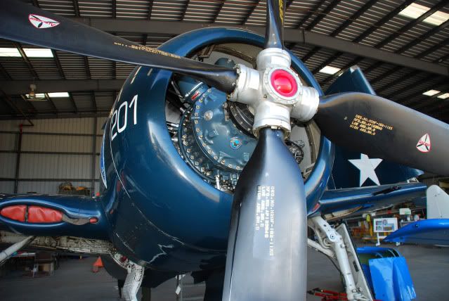

Also here are some Spit pics and a couple of the Bear with the new engines.

Jeff and I got an early start yesterday and by late morning we had solved all of the issues with the elevator trim. It really turned out nice. After lunch, (Muy delicioso! And the Carta Blanca attitude adjustment didn’t hurt either!), we tackled the rudder trim and finished with that in about two hours. Sweet!

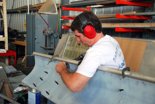

Jeff and I will be back next Tuesday and finish shooting the right inboard flap and then it is back to work on the right wing. It was nice to get a break from riveting for a couple of weeks but I think sheet metal is more up my alley as opposed to rigging. I don’t have the patience for it!

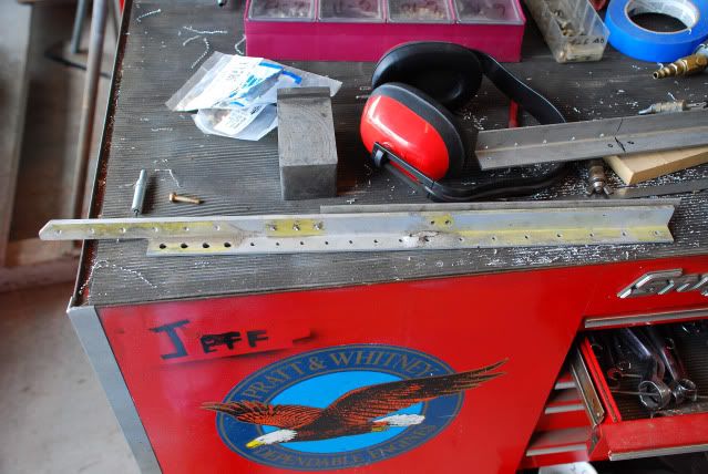

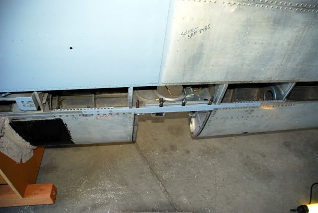

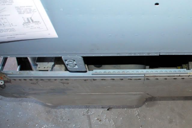

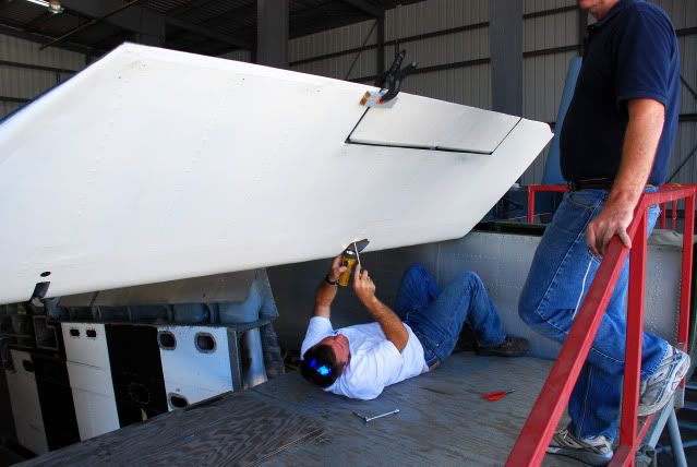

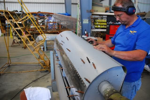

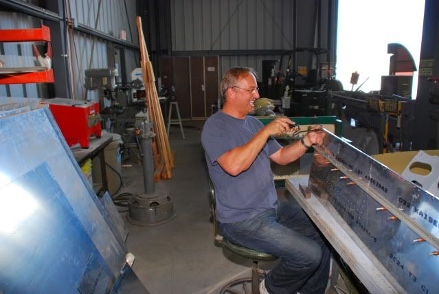

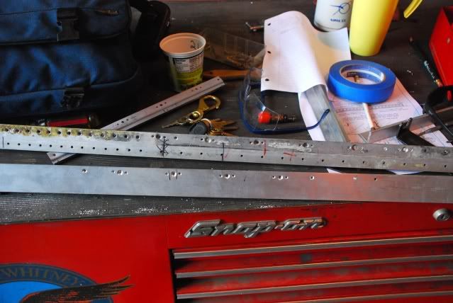

Jeff and I finished the right inboard flap yesterday. Next week we will go back to work on the right wing. I think Jeff has come up with a great plan of attack for repairing the lower T-channel.

Jeff, Scott, Ken, Jerry-1 and Jerry-2 joined me at the hangar yesterday to bang a few rivets and turn a few wrenches.

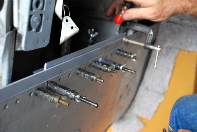

Meanwhile, Stoopid and Stoopider (Jeff came up with that one) continued with work on the right wing. We (I am Stoopider by the way) managed to finish the first splice on the lower T-channel.

I’m sorry for the delay in reporting but I was on vacation. Work continues on the right outer wing panel. The lower T-channel has been replaced since my last report and Jeff and I are now working on repairing the upper T-channel. As far as I can see the rest of the work on the wing is pretty much sheet metal. Marc, Ken and Al are working on the right inboard flap area where we also found corrosion. While Jeff and I concentrate on wing repair the rest of the team will focus on completing the wing stubs. We want to have the nacelles up and installed before we start the electrical wiring. If things go well we will start wiring early next year.
