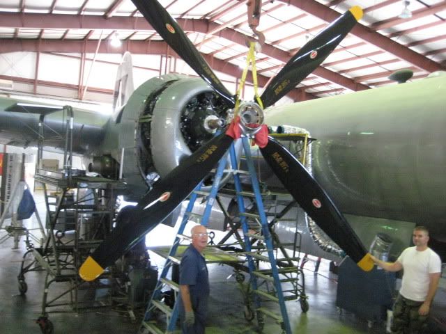

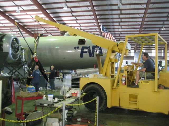

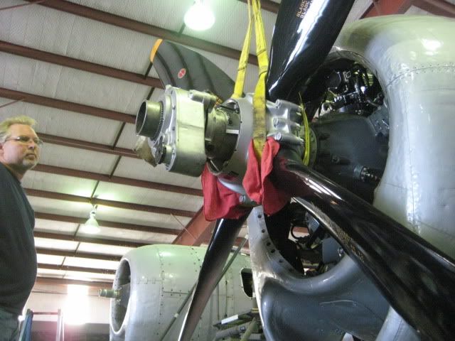

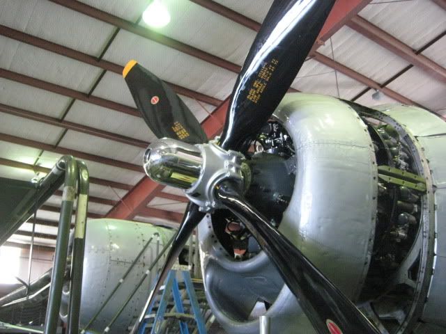

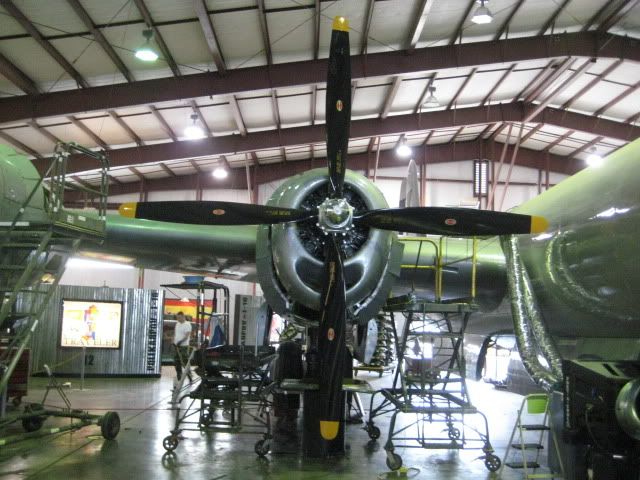

We've made some good progress with "FIFI" over the last few weeks. The following pics are from Sunday when we hung the newly overhauled prop on #3. Prior to that we struggled with the cowling and exhaust and had it off and on about 4 times trying to make it fit. Still have some minor issues but we'll work them out later.
I had quite a bit of help as you can see.

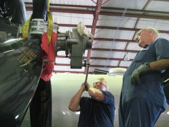

Here's the Sweeney tool installed for torquing the prop nut.
It's 1900-2000 ft/lbs but the Sweeney makes it 190-200 ftlbs.

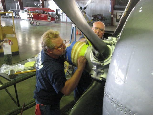

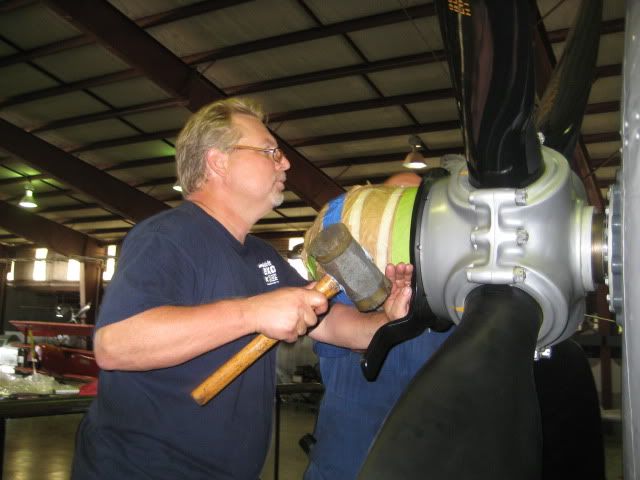

Safties in place, Rick places the dome on.
A few taps to line up the screw hole for the safety of the dome nut.

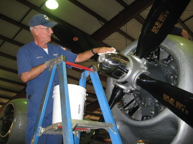

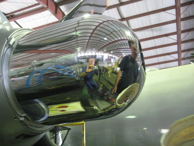

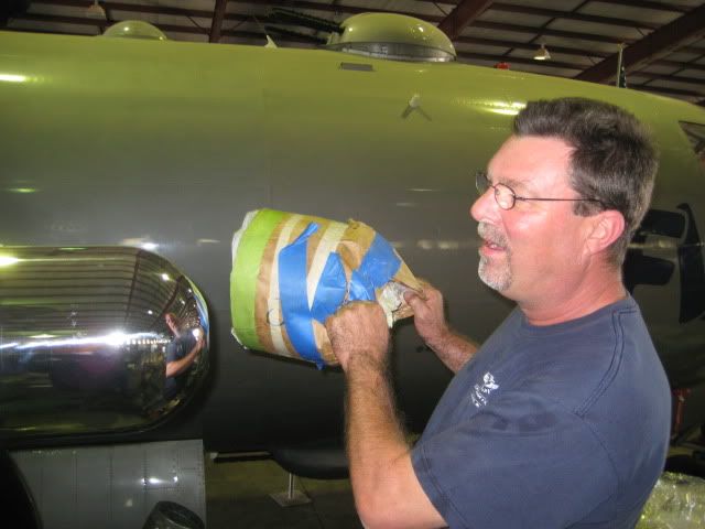

Crew chief removes protective cover. WOW!
John wipes off finger prints.
