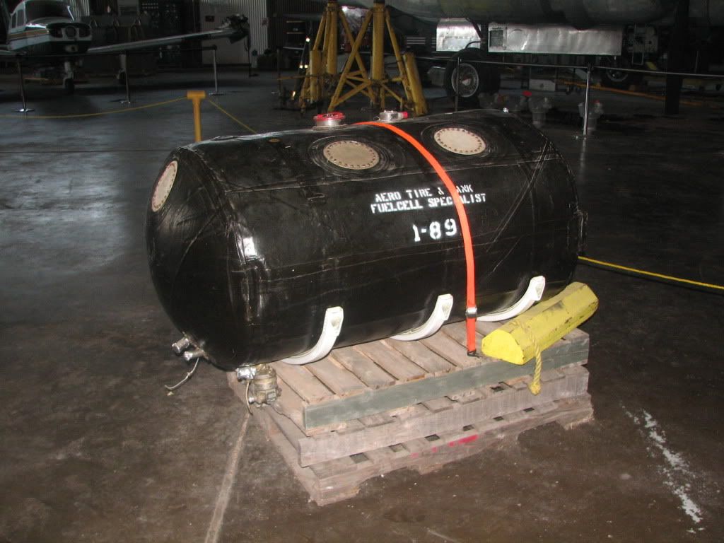

Here's the update on this weekends work. Scott and Rick were able to get the #2 engine turbo air intake duct installed, which then allowed us to install the #2 fuel main fuel tank.
It took a little work, but we had a lot of help. Even Dean (KD5H) helped out, it's good to have skinny people who can fit up in tight places (even if they are using our OSHA approved :roll: Home Depot bucket). Here Dean is helping Mike hook up the vent line and the vapor return line (fuel coming back from the carb) on the top of the forward end of the tank....where no human being is meant to go. :shock:

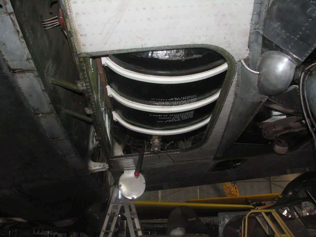

It was late in the day by the time we got it in and postitioned right so the fuel cap was aligned properly with the hole in the top of the wing and the fuel boost pump which protrudes out of the bottom of the wing (the teardrop shaped bulges on the bottom of the wing) all lined up and the tank cradle brackets tightented properly. We still need to connect the lines on the bottom of the tank and transfer fuel into it and leak check it.
We did get the RH inboard fuel tank stress panel installed yesterday also, note the bulge for the boost pump.

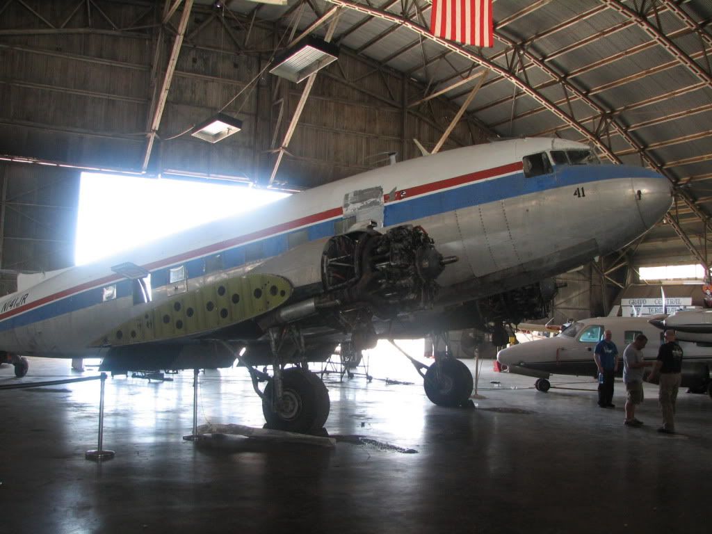

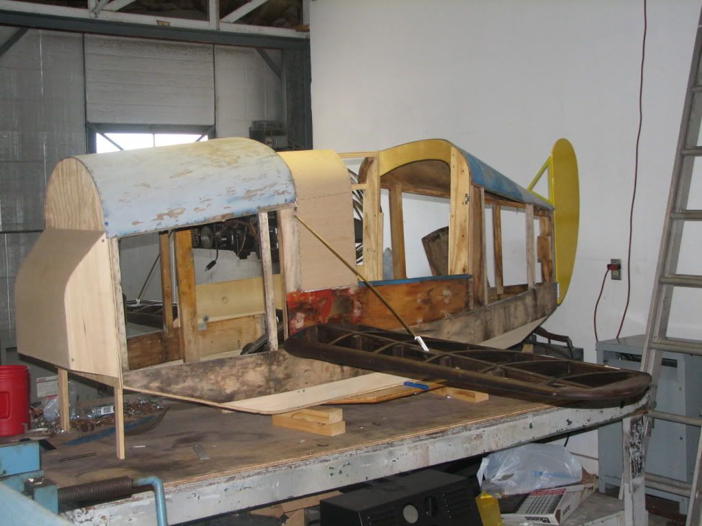

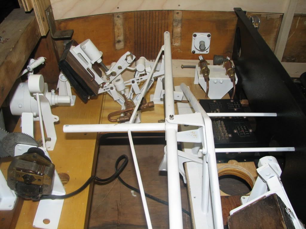

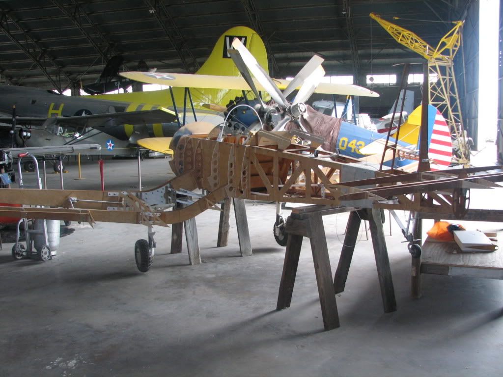

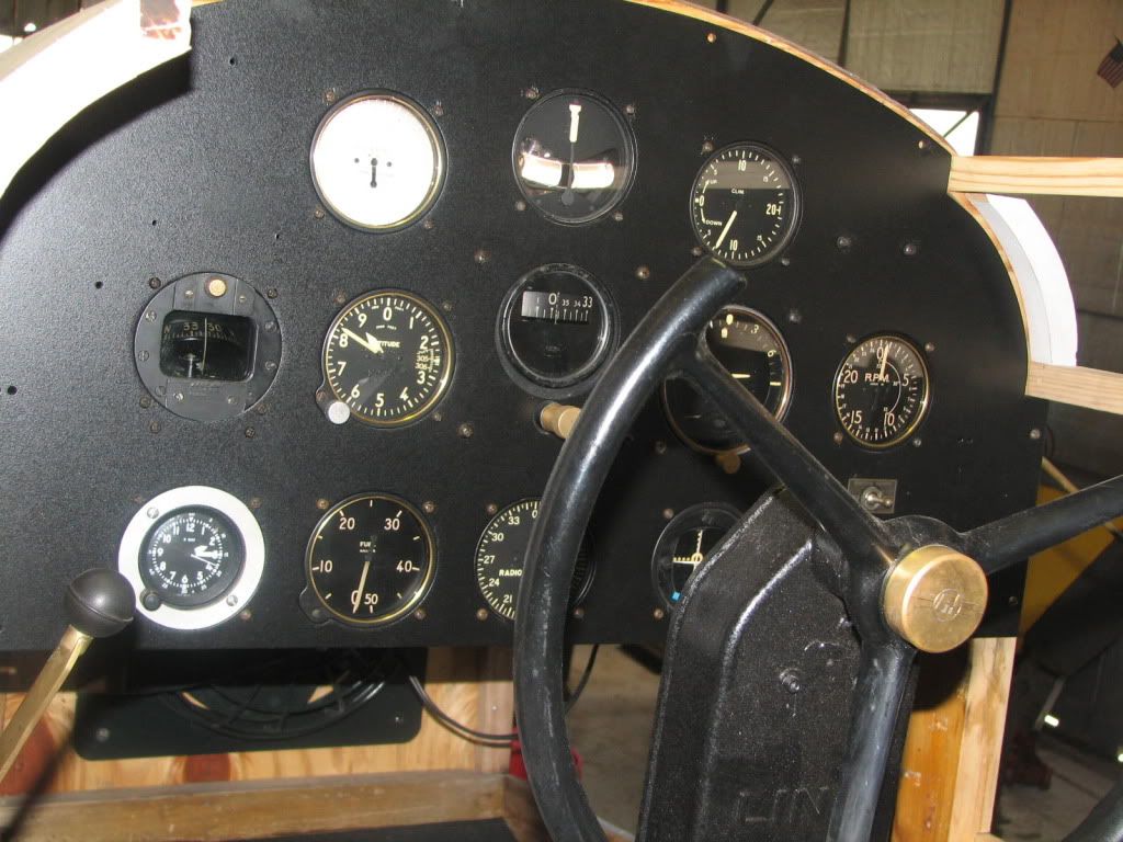

Here are some other shots I took around the hangar today, including the Link Trainer that our machine shop guys are restoring piece by piece. This thing was a basket case when they started! They are making just about everyting from scratch! Also there are some shots of the DC-3/C-47 that the Pacific Prowler guys are restoring for a gentleman up in NY. This is the one that they found the pin up girl glued to the inside skin, Ms. June '44 I believe. We believe that this plane participated in D-Day and Market Garden. It' in remarkably good shape and will be restored to WWII C-47 configuration. I have no idea what markings it will have. Also there's shot of our local EAA chapter's project, a 1/2 scale F4U Corsair.
Link Trainer Air Motor

What kit is that Corsair?

BTW Fouga, that's a scratch-built 1/2 scale Corsair, not from a kit! :shock:

I was wondering if those are new manufacture fuel-cells? Sorry if this has been covered earlier in the thread. I have not been on WIX as often as I used to.

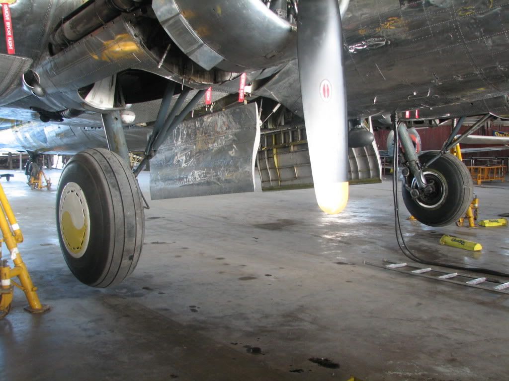

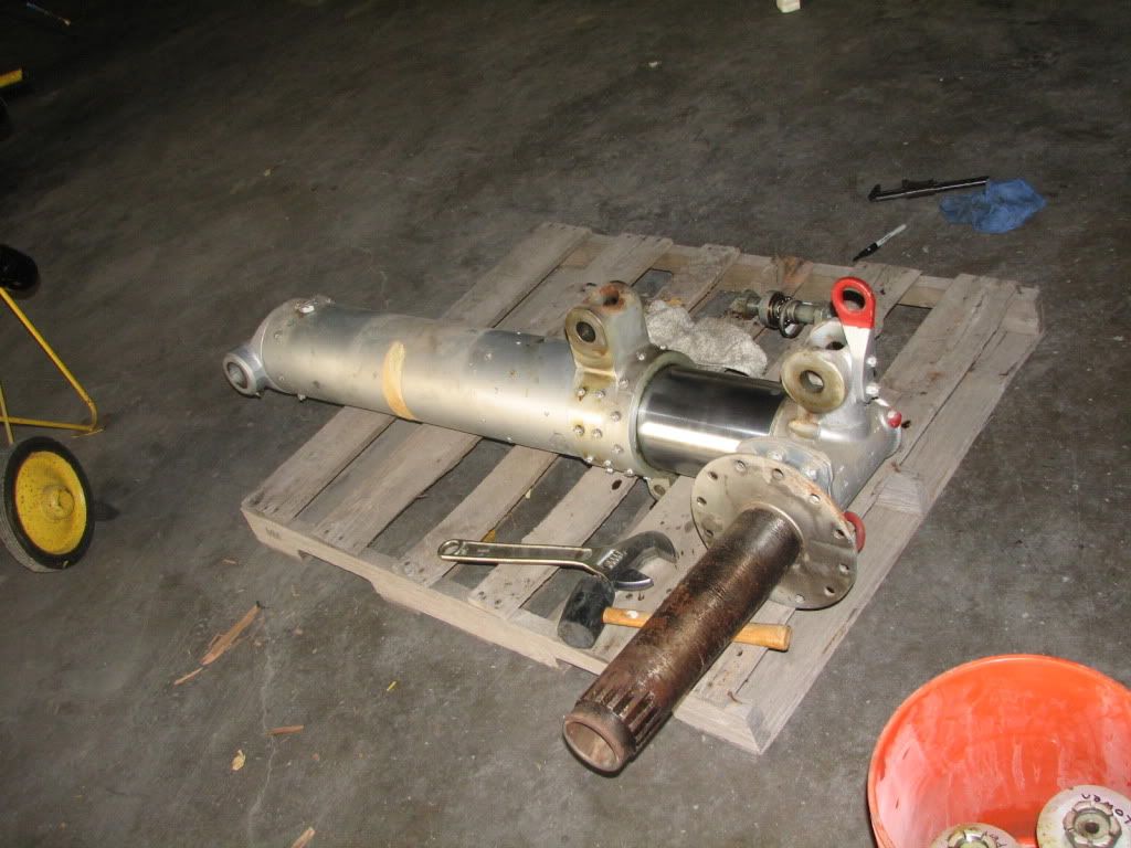

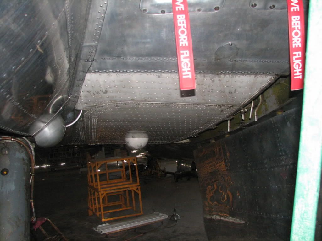

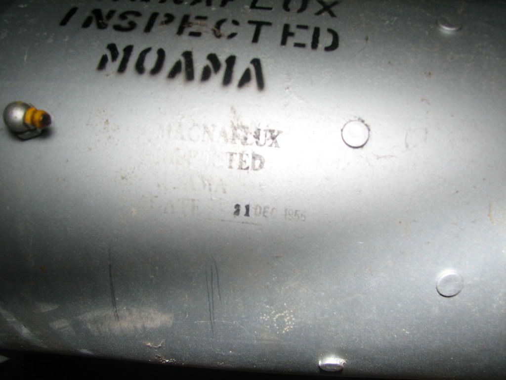

Well for those of you who did not check out the Thunder over Michigan thread yet, we are not going to make it to Thunder. A group of us came out to the hangar last night to jack up the plane and do the landing gear portion of the 100 hour (which had not been done yet, because we couldn't jack the airplane with the fuel tanks out). We got her jacked up and started inspecting the known wear areas on the main landing gear, areas like the trunnions (where the gear attaches to the wing) and where the axle attaches to the bottom of the shock strut and discovered excessive wear. Enough so that we now need to replace the LH main landing gear and replace the trunnion bushings on the RH main landing gear. The good news is that we had a "freshly" (1956) overhauled LH main landing gear in storage that is in almost pristine shape. We will be changing the LH gear and working on replacing the bushigs on the RH gear this weekend. This gear work in combination with several other factors is what is preventing us from going to Thunder. We would rather play it safe and miss an air show than gamble and make the 10 o'clock news in a bad way.
Here's a few pic's from last night. I guess you could say that Chuckie got airborne for the first time in 2 years :wink:
Here's the "new" gear. Dean and the guys had already taken the torque links off to start cleaning them up and greasing the bearings. That's not rust on the axle, it's cosmolene.

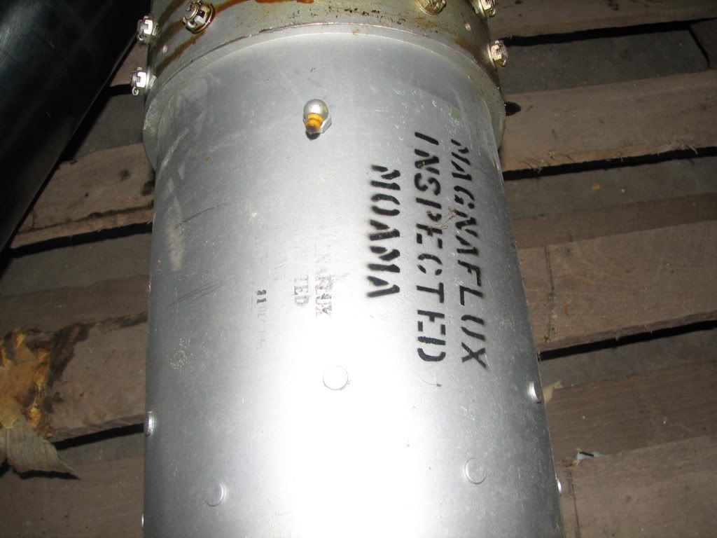

I believe that "MOAMA" is Mobile Air Material Area
