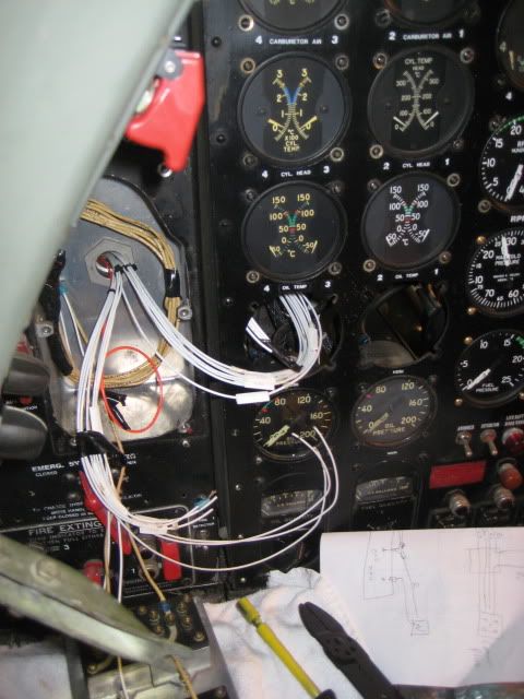

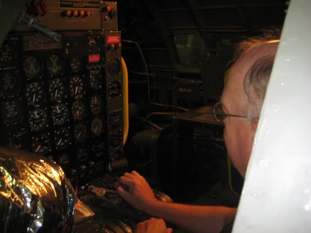

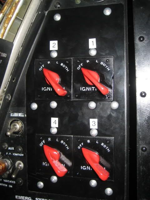

Mark came out to help again yesterday and got to wire the mag switches. Obviously, before that could be done, I had to finally decide how they would be numbered?? Having said that, here's how it went.

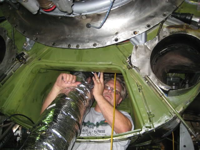

Once we got one of the conditioned air hoses up to the flight deck, Mark was happy, Like a kid in a candy store!
This shot shows the great work Shorty did pulling all the new wires to the engineers panel.
Of course, after mark got all the terminals on and put in there respective place, I had to inspect! Turned out to be an excellent job! No changes necessary.
Here is the arrangement I went with. Don't think anyone will have a problem with it and I do see the benefit of keeping with tradition. Just a side note before someone comments, the labels for numbering the switches is only temporary!

Guess I've been kinda busy and haven't posted anything for a while, so here goes! I had Rick Garvis here a couple of weeks ago to help with "FIFI". We got alot done and finally have about everything hooked up on the engine.
This is Rick putting in a plug on the rear sump. He's gotta stop wearing that B-17 T-shirt around "FIFI"! That duct is our portable A/C unit. You see he doesn't get to far away from that!

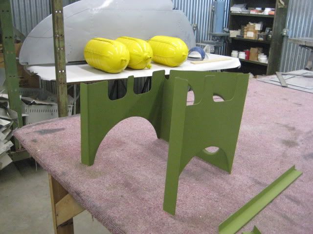

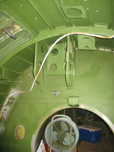

One of the students from Midland School of Aviation is working a sheetmetal project for "FIFI". I had him make this bracket to hold one of the O2 bottles we are installing in the aft compartment. He took the measurements, made the bends, cut out the lightning holes, flared them and made the cut outs for the wiring that it is going to be installed around!
I got it painted along with the bottles and all it needs now is some "L" brackets riveted on to hold the clamps.
This is what it looks like in T-Square 54. We had to change it just a bit to make it fit.

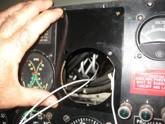

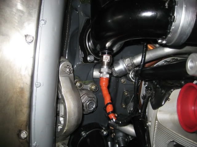

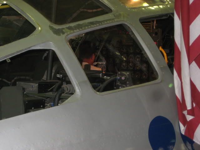

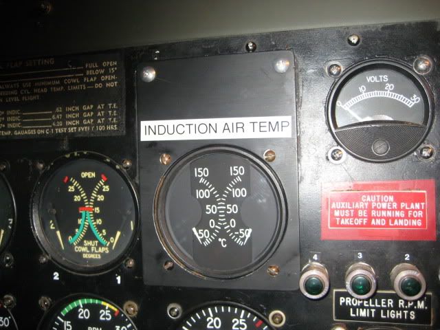

Another project I have been working on is the Induction temp. indicator, probe and wiring. The purpose of this is to see our air temp. just before it enters the cylinder. The induction tube on the #7 cylinder was chooen for the probe mostly because it is a rear cylinder and should be our hottest spot near the exhaust. It also was nice that there was a boss on the tube for a probe.
Wiring for the indicator had to be run from the wing junction box to the engineers panel. There was already extra wires put in before, from the junction box to the nacelle for such things, so the leading edges wouldn't need to be removed.
This hole was where a deicing gauge was installed that we do not use. It also had a cover plate above the gauge to cover that hole that look like a rat chewed it out?? The deicing gauge was 2-1/4" so I had to inlarge the hole for the 3" temp. gauge.
I made another cover plate to include the gauge.
And here it is installed!

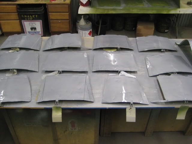

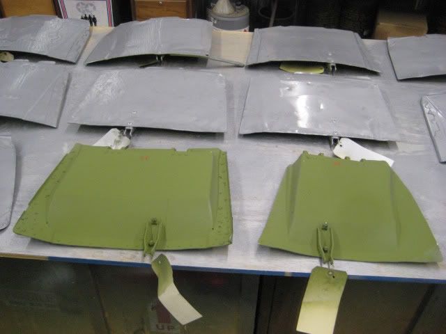

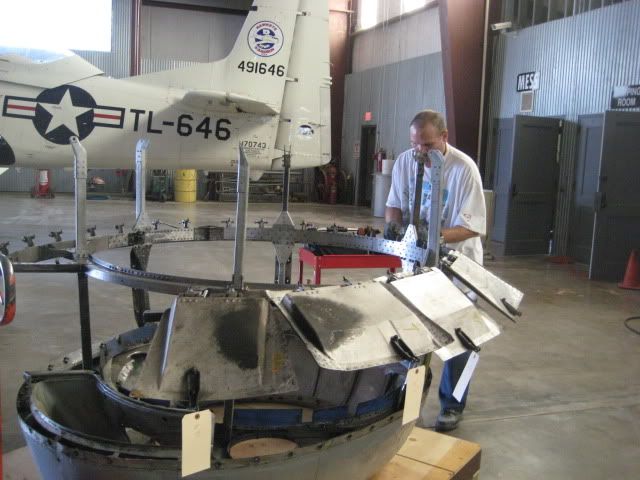

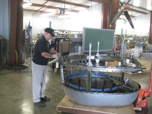

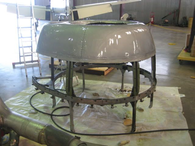

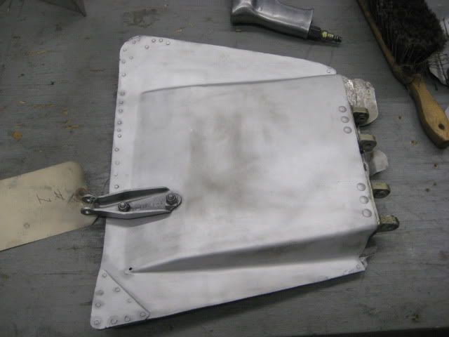

While I'm doing other things, Jim and Rudy were working on getting the cowling ready. They took the cowl flaps off and got them cleaned up.
Rudy replaced all the zerk fittings and cleaned out all the old grease.
I got the cowl flaps painted and they are ready to put back on.
Next was preping the nose bowl and painting that.

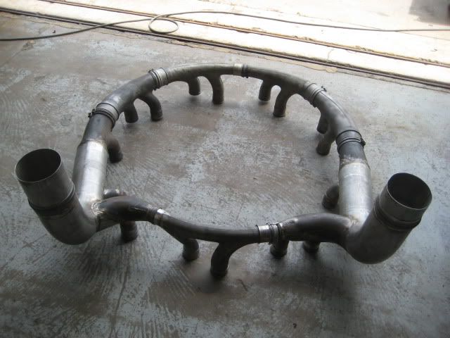

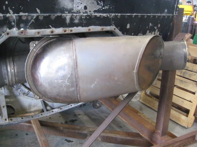

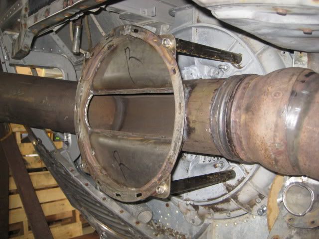

also if you were looking. the exhaust is here as well. Nelson's team did a great job figuring this one out.

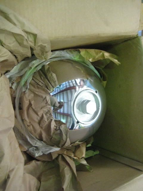

Here's the picture of the propeller!!

That prop dome looks sweet! Much better polished up instead of black...awesome!

I appreciate the compliment! I think its awesome and I will be able to post some pics of it installed very soon. Much more going on that I haven't had time to post but I will soon. Stay tuned!
