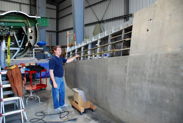

It was just Jeff, Scott and I yesterday and since it is not a normal workday and the museum is closed on Mondays we had the hangar to ourselves.
Scott removed an upper skin and cleaned and inspected the structure underneath and found things to be corrosion free. He found several broken stringer clips that probably comes from years of people walking on upper wings.

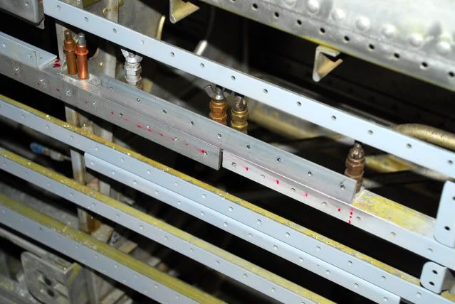

Jeff and I worked on stringer replacement on the lower inboard wing. In this particular area we remove the old corroded area and splice in new stringer material. Fortunately we only found three that we need to replace.

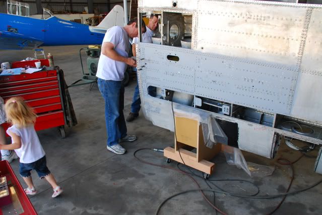

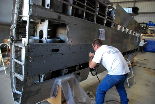

As things turned out we did have the place to ourselves. We couldn’t find the key to the museum to make coffee so we went to the Way Point and had breakfast after which Jeff and I opened up the hangar doors and then moved the right wing out into the sunlight. Jeff found a boom box and soon had it pumping out classic rock and roll. I suddenly felt like I was back in a garage rebuilding the engine of my ’57 Chevy. It was a good feeling.

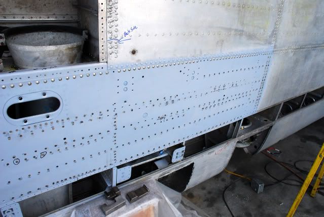

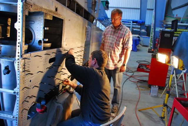

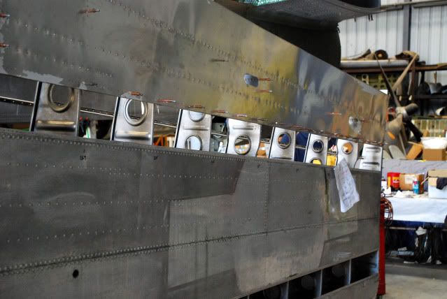

Jeff amazed me with his ability to reach some of the seemingly impossible areas to buck rivets. We shot all of the rivets he was able to buck on the lower skin panel. We still have a few holes to fill. We ran out of rivets in one area. The other holes will be filled with Cherry Max. Jeff put an order together for these and other rivets after we inventoried our rivet supply. Iran will place the order today. Jeff also has put together a library of all the informational sources he can find that pertain to our project. You all know Jeff’s motto. “Show me where it is in the book.”

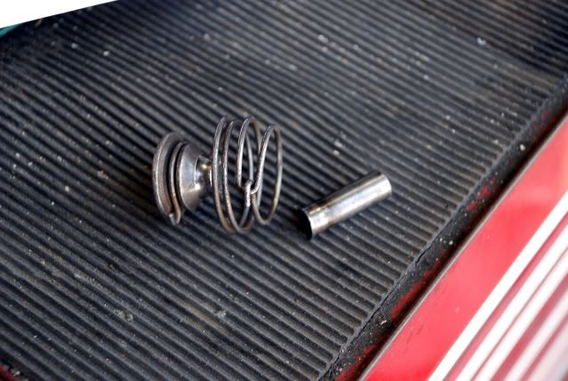

Yesterday I had something happen to me for the first time. In fact I have never seen it happen before. I had a rivet set break. Over the years I have shot thousands of rivets. I have shot all kinds and all sizes. As we were shooting flush rivets something just didn’t feel right with the gun but the rivets were going down just fine. I didn’t notice the break until I switched sets. The spring on the gun was the only thing keeping the set together!

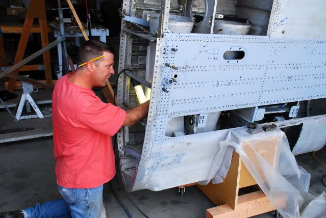

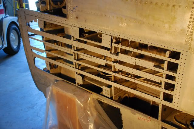

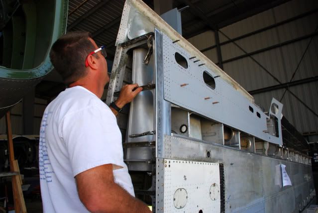

Hi guys,
Jeff and I all but finished the lower inboard skin. We lack just 4 cherries as we ran out of the proper length.

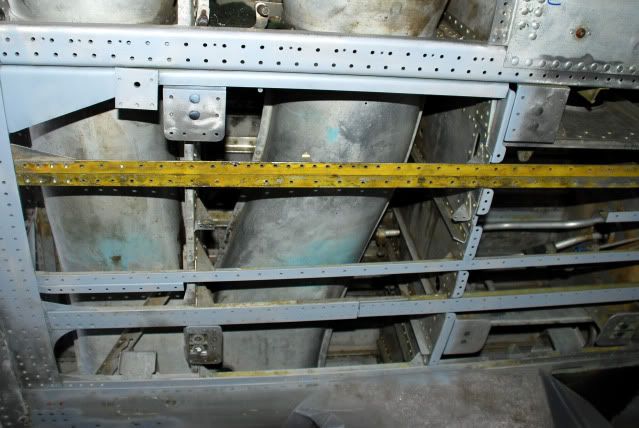

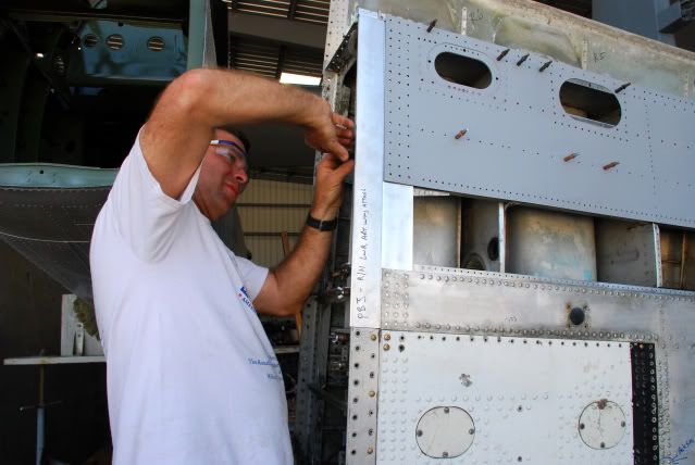

Scott surprised us by showing up later in the morning after getting in from a long trip. In the afternoon we tackled the ticklish task (you like that?) of locating our brand new $3,500.00 blank, lower aft, wing attach angle.
This critical and expensive piece of aluminum must be located precisely. If we are just a fraction of an inch off in our measurements the wing won’t fit. The old saying, “measure twice and cut once” took on new meaning for us. We measured about 10 times before we cut. I think we did our job but we won’t know for sure until we try to hang the wing. If we didn’t get it right it will cost us a lot of time and money. The long bright piece of aluminum that Jeff is working on in the pictures is the attach angle.
Looks like next Monday for Jeff and me.
