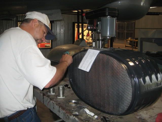

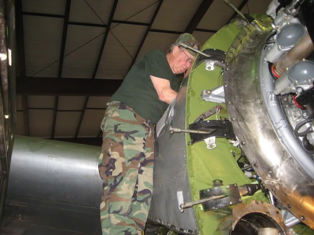

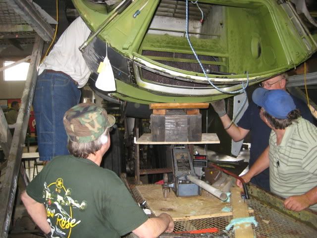

All the while that was going on, we were working on "FIFI".
Chris is getting the oil cooler fittings put on and saftied.
Shorty's working on connecting the starter and generator cables, the lines to the prop governor, the prop control box leads, the primer solenoid, the fuel pressure line and some other stuff.
This is our Local EMS!
The boys are getting an idea of how to fit a 40 lb. oil cooler in a 35 lb. box.
This is not the most fun they ever had.
At the end of the day, we had it pretty well in place but still had to get the lines hooked up.
