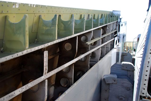

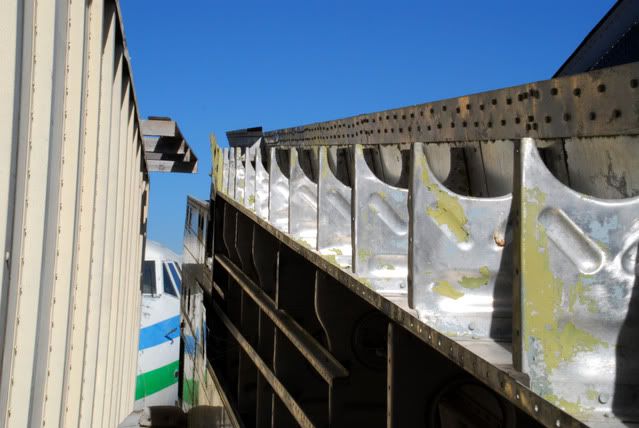

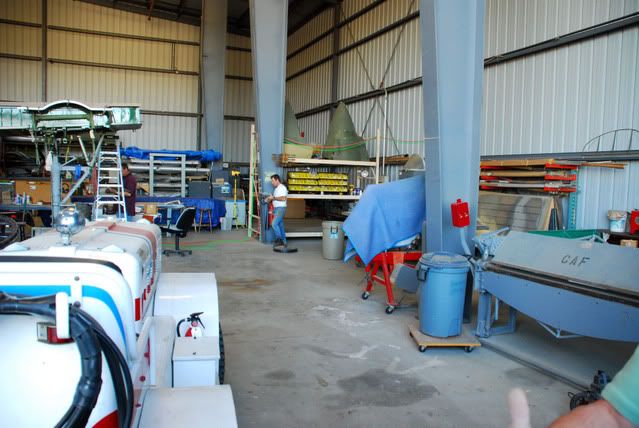

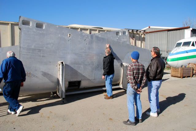

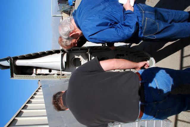

With all things considered, we decided to rebuild our outer wing panels. Years ago before my time, the SoCal Wing sent the wings to Aero Trader with the intention of Carl’s guys doing the work for us, eventually, when we had the money. The wings have been there for a decade sitting out next to a hangar. Last week some of us trekked out to Chino to look at the wings and talk things over with Carl and of course, lunch at Floe’s. Even with a howling Santa Ana wind blowing sand, mixed with cow poop, in our faces it was a worthwhile trip. We will bring the wings home next week. We will do as much as we can and if we run into something beyond our current expertise we can always send them back to Carl. We can’t afford to pay for work that we can do ourselves.

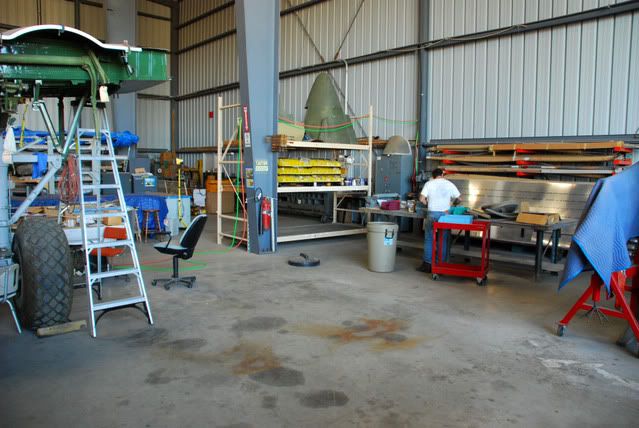

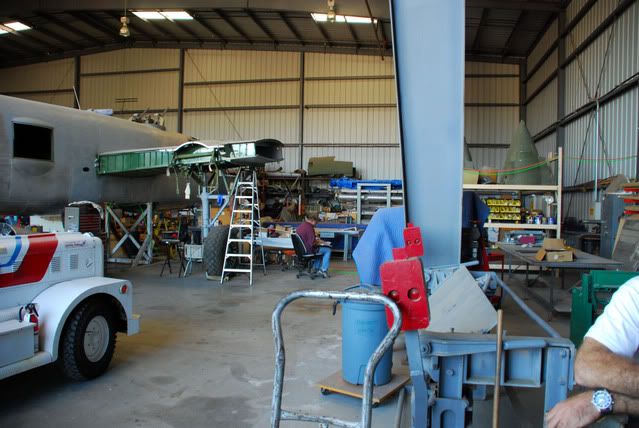

In the mean time we have spent several days reorganizing the hangar at CMA so that we will have a proper work place and storage area for both wings. What a job! I’ve never seen so much crap in my life! Talk about packrats! I’m just as guilty as anybody but how many broken battery chargers do you need? We found five. Or how many BROKEN welding facemasks? Six! It is truly amazing what you can find in the odd corners of a hangar.
Here are some shots of the Chino visit and our much better organized work area in our hangar.

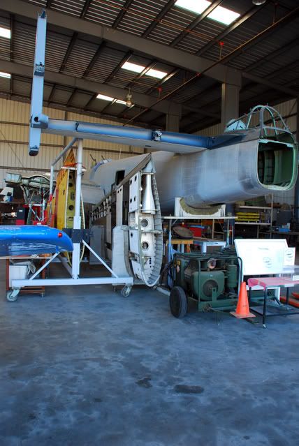

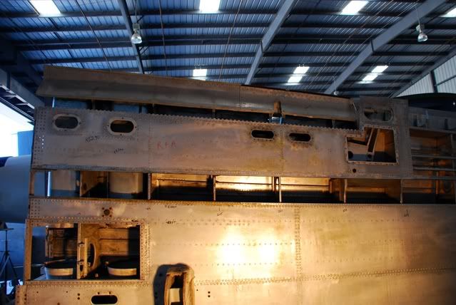

It was nice to see our wings back in the hangar after so many years. Now we will finally get a chance to thoroughly inspect them.
Instant Chino – Just add water!

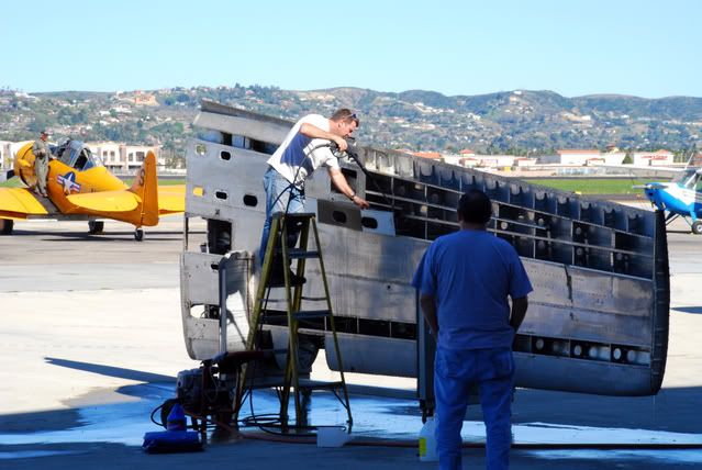

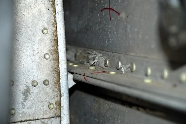

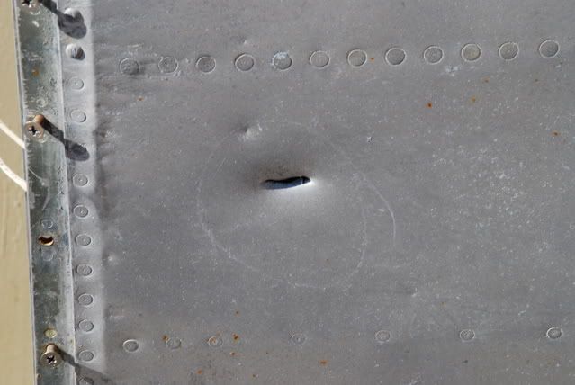

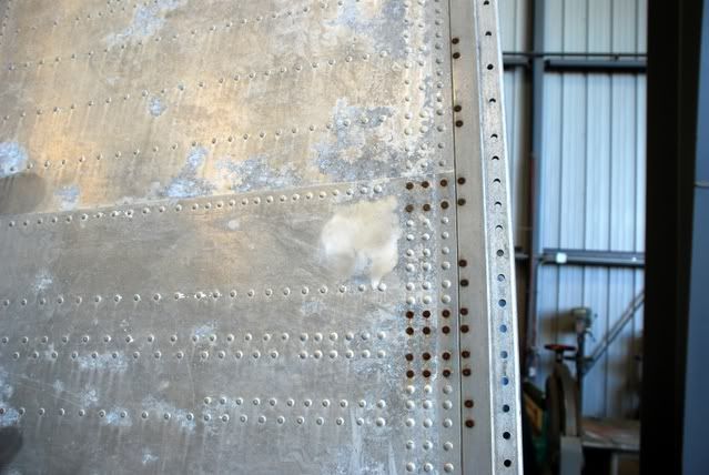

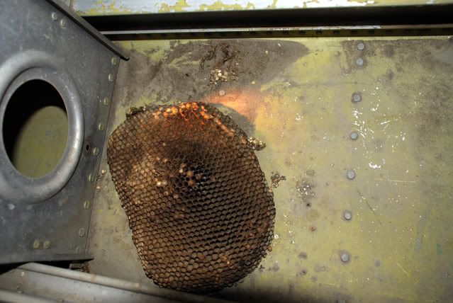

We put the left wing next to the fuselage on the left side for the time being and then pulled the right wing out to the ramp for a cleaning. What a mess! After sitting out in the Chino sun uncovered for most of a decade the wings collected tons of dirt, slime, nests and other things that Jeff and I decided we probably were better off leaving unidentified. When we hit the wing with water it turned all of this into nauseatingly fragrant brown-green goo. Jeff did most of the work but don’t feel sorry for him, he loved doing it. Jeff’s a dirt biker and he just aint havin’ fun unless he is filthy!

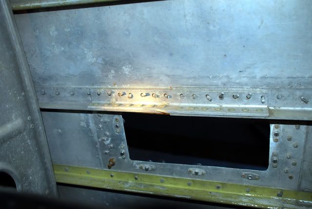

It is WAY too soon to know how good or bad things are but my gut feeling is that the wings are in much better shape than we thought. HOWEVER, things can go to hell in a heartbeat! Others have patched up both wings in past years and some of that work is pure crap! I will include a picture as an example. Jeff took a bunch of paperwork home to study and next week we will start examining and strategizing.

Nice bucktails on those rivets.... :roll:
PostPosted: Wed Feb 04, 2009 12:59 pm
Posts: 3442
Yes, interesting.
Dan, you're doing a service by letting folks see what can be found during a THOROUGH inspection by competent people.
Scott

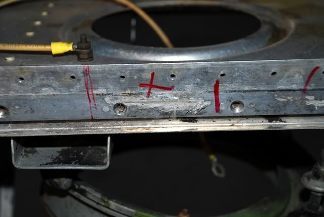

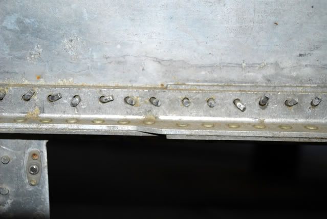

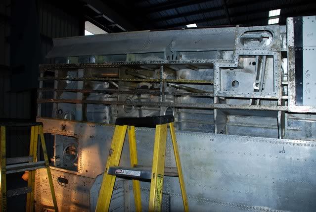

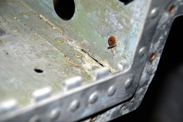

Jeff and I spent most of the day conducting a complete inspection of the right wing. We started at the tip and worked inboard. Visible damage was noted and areas of concern were marked. We will have to take a few rivets out here and there to see how deep some of the corrosion goes but at first glance it appears to be light surface corrosion. We have to look under a couple of skins and check a few stringers but it doesn’t look like a big deal. We did find three stringers that must be replaced and that means at least two lower skins would be removed to gain access. Both of these skins will probably go back on the wing as they look to be in great shape. Jeff has already started the removal process on one of the panels. At this point we think that we should only work in this area and not remove any more structure. Things may change, they usually do, but we want to start out conservatively. We will also have to do a couple of T-channel splices to correct corrosion found at the landing light. We also found the usual rusted out hardware that will be replaced. We pulled out all of the old electrical wire. I tried to find the worst area of surface corrosion on the upper skins to see how deep it went. So far it buffs right out. I am surprised. Pleasantly! I think we can save most of the skins. Next week we will finish removing the panel and then we will know how much stinger material we need and where to make our splice.

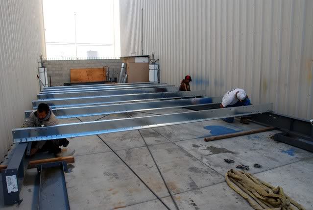

As I pulled up to the hangar two hours later I noticed a hub of activity between the buildings. We are finally getting the structure between the hangars built. Boy it sure will be nice when it is finished!

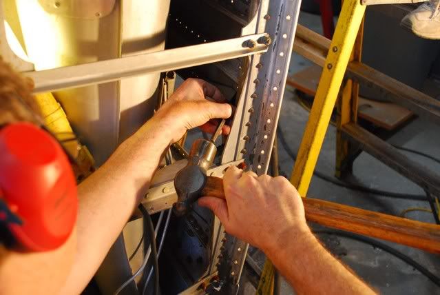

Scott and I went to work on the right wing. I concentrated on removing an upper skin and Scott worked on a lower panel. In the afternoon we had to pick the wing up and move it about six inches to gain access to some rivets. With the help of Mike in the afternoon we were able to finish removing the upper panel. Scott didn’t have things so easy due to several rows of huck bolts that needed removal. Removing these requires splitting collars with a chisel and then driving the bolt out of the hole with a hammer. Getting to the collars wasn’t easy. We will have to finish removal next week. I admire Scotties patience and persistence! I was about ready to get a jackhammer but he went about banging away with only an occasional monosyllable word or murmur! Amazing!

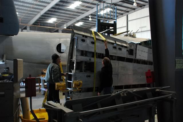

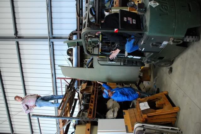

Good old Marc provided the wing with the days entertainment. Daddy wanted us to help him get the left nacelle down off the shelf. Simple. Not quite. We had to move the propeller stand out of the way after inflating two flat tires on of which would only hold pressure for about 30 seconds. That done we had to get the forklift in position. We used the electric lift and since Scott, Mike nor myself have ever driven it I naturally elected Scott or Mike to give it a try. I’m not going to make a fool out of myself! When they hesitated I used my great powers of logic and persuasion. I told them that if Scott could park a 747 on a ramp somewhere in darkest Africa at an airport with a name that nobody could pronounce, or Mike could fly a Warthog in Bosnia they could drive a simple electric forklift. You see after working with pilots all of these years I have come to realize that most of them will readily accept a challenge even at the risk of looking stupid. Since Mike had been in the military he knew that you never volunteer for anything. That left it up to Scott. Well, Scott didn’t embarrass himself. As other wing members lined up behind him taking bets on how long it would take for Marc to hit the deck, and I heard somebody talking about the Empire State building and King Kong, Scott smoothly and efficiently lowered the nacelle to the ground. No problem!
