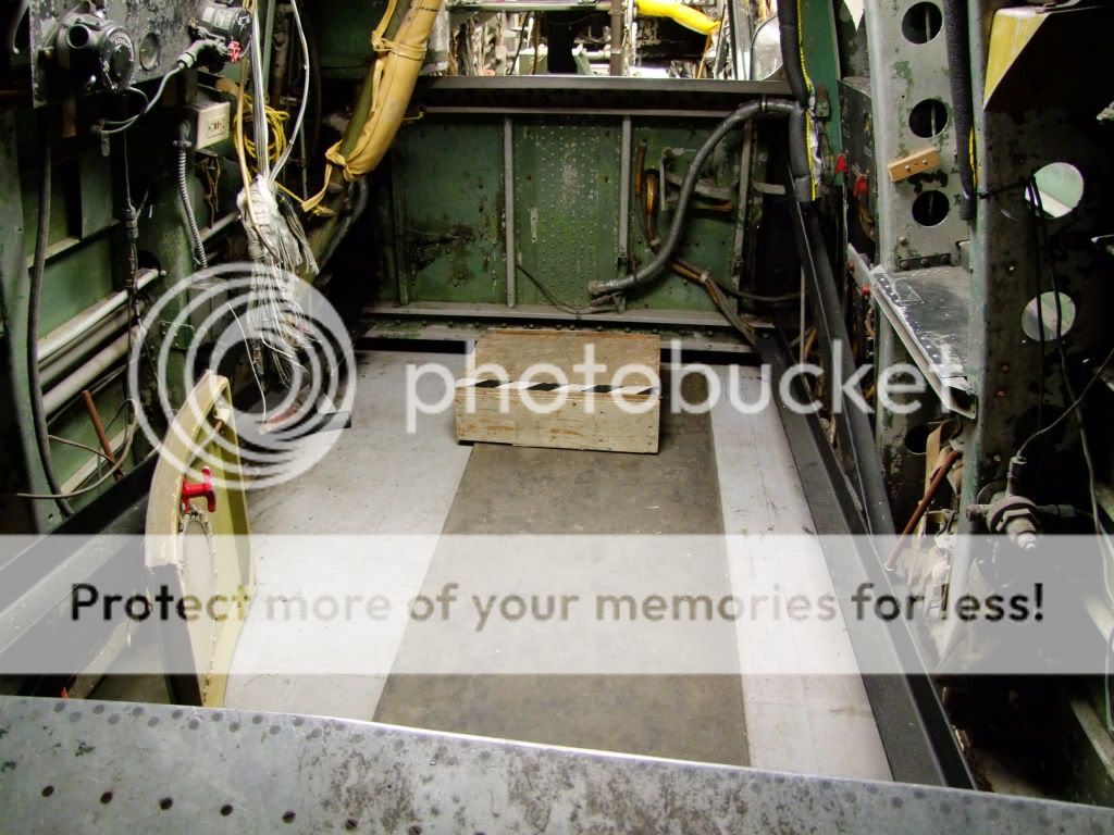

Here's the last update for tonight.
These pictures here show where the stand was located on the plane. The section is filled with a wood floor and steel support beams to support the fuselage and wings.
Here's the right tail, most of the paint has been stirpped off of it but the top right corner can't be because the covering is to thin. (it's starting to wrinkle as well)
Here's a shot of the wings, not much has been done on them that I know of.
And finally here's a shot of the inside of the plane looking towards the rear gunners position.

PostPosted: Sun Mar 22, 2009 9:20 am
Posts: 1695
Location: canada
Excellent pictures and update Ryan! Do you know if the floor repair is just a temporary thing? Also do you know what they are using to strip the paint? The metal is thin in areas from the sandblasting donw when she was on the post. First they used soda blasting which was expensive and time consuming so the parks switched to a more coarser product which ended up causing heat related wrinkling of the skin. You can see clear evidence of this on the underside of the wings and cockpit fuselage side skins.
Peter
________
PostPosted: Sun Mar 22, 2009 10:01 am
Joined: Thu Aug 21, 2008 3:29 pm
Posts: 351
Location: Windsor, ON
Thanks Peter!
The floor that they have put in is temporary. It was only put in so people are able to walk through the entire plane. I'm not exactly sure what they're using for paint stripping but I think they're just using an aircraft paint thinner and then scraping the paint off with plastic scrapers (I guess thats what they're called). This is what they were doing on a few parts last week while I was there. Also in a few spots they have used powerwashing to strip the paint (bomb bay doors). If you want I can find out for sure from Michael what they're using on most of the plane, but I'm pretty sure it's the aircraft paint thinner.
