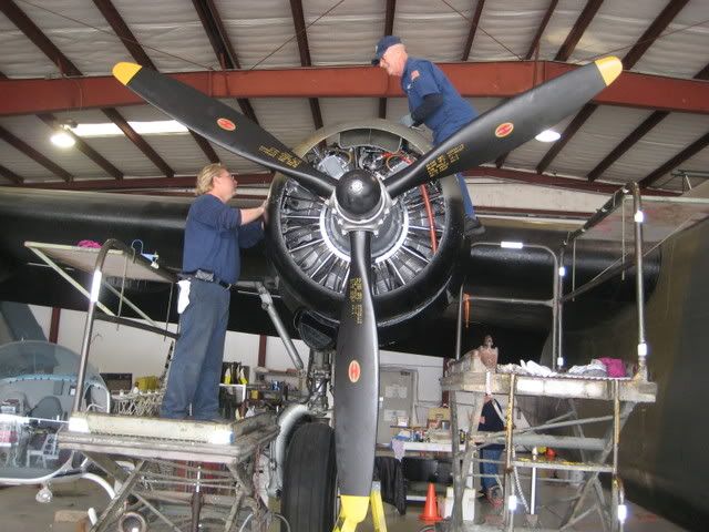

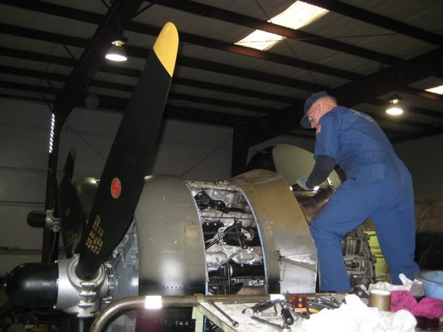

Here's a couple of pics I took when I was in Addison for the engine run last week.
This is John Flynn hard at work, rigging the #3 engine carb heat actuator.
I had the hard job though, I had to operate the switch!!
This is Rick Garvis and John reinstalling the spark plugs that were removed for the preoil. Is that man really our safety officer?
