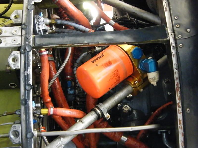

I was just out for a half day and had to leave for family (they're wanting to "do family stuff" here shortly), but during that time I was able to help John finish cleaning up the oil tank and re-install the #3 Oil Cooler shroud which I'd removed (along with the Oil Cooler) last week and flushed. Rick had re-installed the Oil Cooler the same day after modification to fittings on top to accept the new Air Wolf filter kit that we will be putting on all of the engines eventually to help simplify oil change procedures (this is the mod that allows you to put a FRAM oil filter in place of or as a supplement to the oil screens as I understand it).
John had the #3 prop almost fully rigged and ready for tomorrow and I think Rick said that the final oil hoses for the Air Wolf kit were supposed to come in today or tomorrow morning so they could put oil in the engine and get it ready for the run tomorrow.

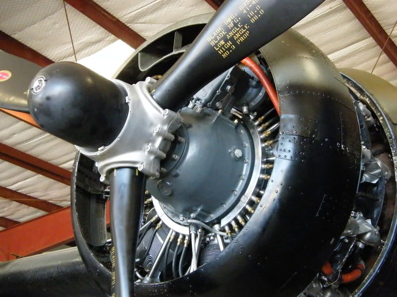

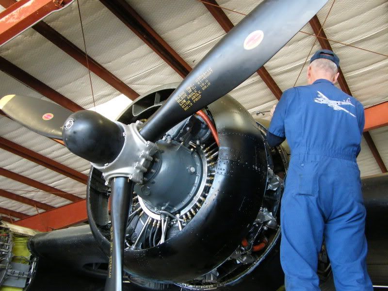

Welllllllll, since Chris did such a nice job with the text, I'll just supply the piccies........
John Flynn hard at work......
Close-up of #3....
All four engines will be getting pre-oilers along with the Airwolf spin-on filter system.......The "Fram" difference....... According to the literature, we only need the single filter setup, since we are under 2000 cubic inches. Anything larger requires the "Super Gorilla" double filter package.
