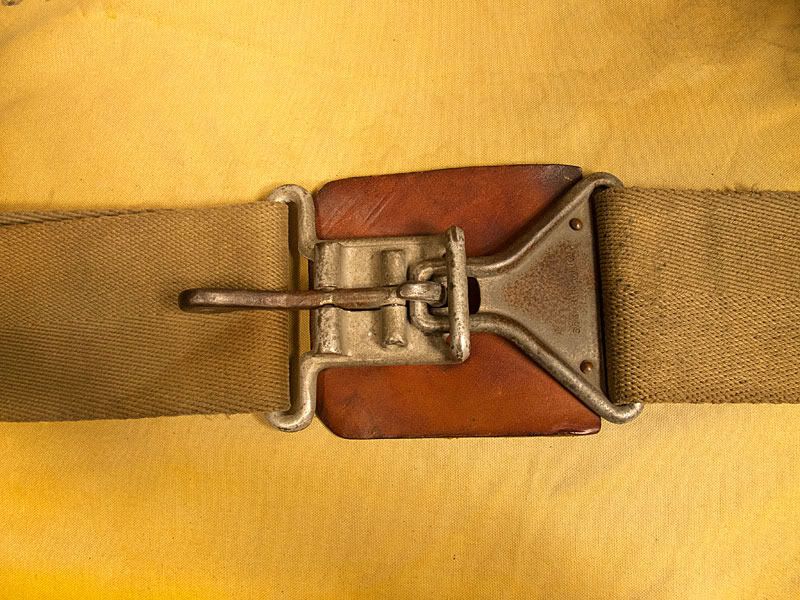

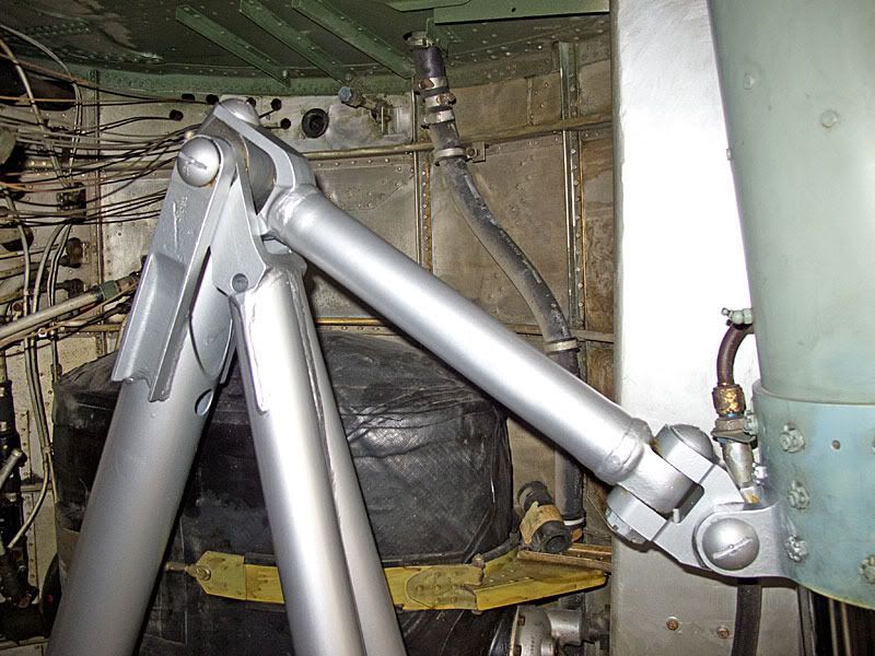

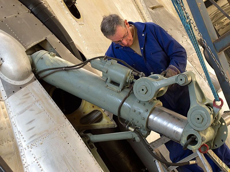

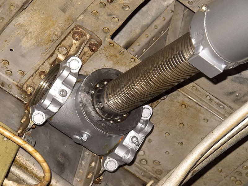

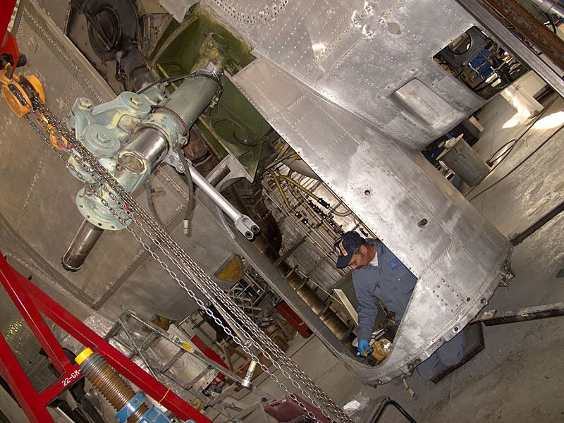

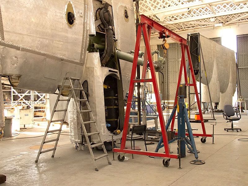

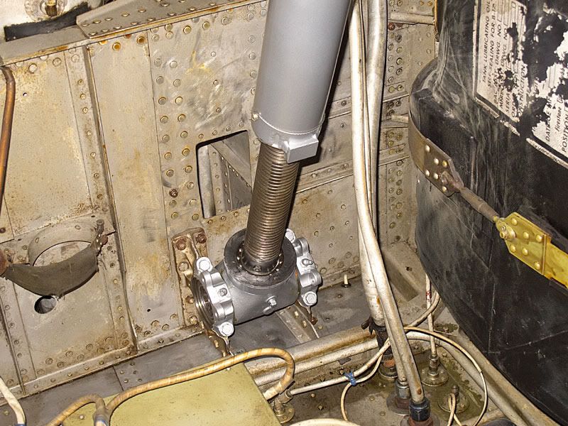

Fasten your seat belts for another update :D

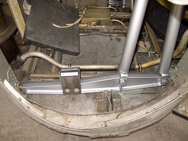

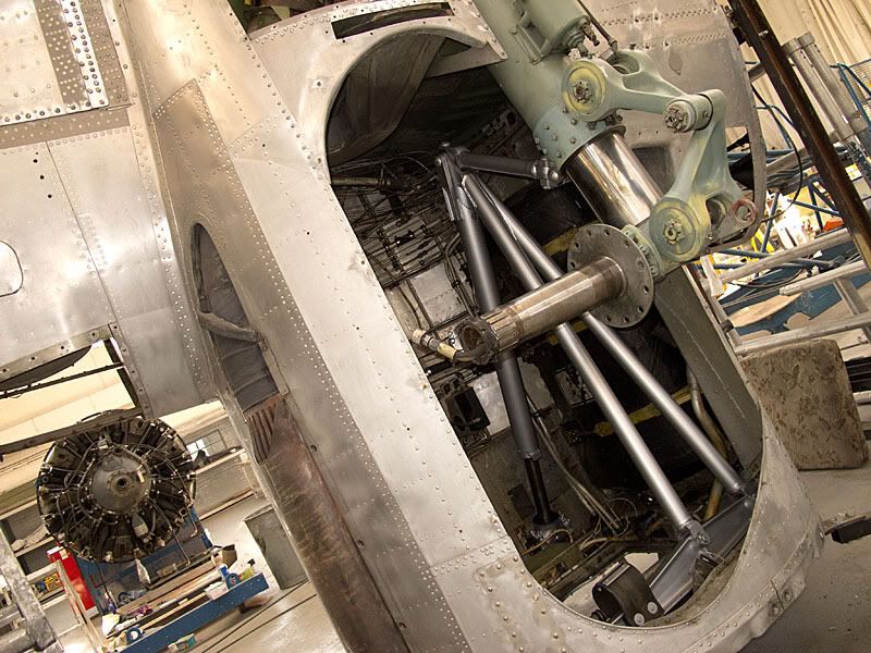

Work on the undercarriage leg is progressing ......
Even if sometimes ~ it appears there's no one working on it
There can't be many people who can claim to have nealt inside the firewall of a B-17 nacelle
We can see that the newly overhauled parts ( painted silver ) have been installed
Another update soon :wink:
Blue Skies .....
Peter

PostPosted: Mon Oct 03, 2011 9:10 pm
Posts: 472
While you've got the gear off the ground and the wheel/brake off, take a look at the bottom of the chrome cylinder where it joins the lower axle fitting. You'll see at least one small circular lead plug in the chrome that is about a 1/2" in diameter. The lower axle fitting is threaded into the bottom of the chrome cylinder, a hole is drilled and a pipe plug is threaded into it to prevent the two from unscrewing ( :? :shock: ) from eachother. Lead is then melted over the pipe plug to form a smooth surface for the strut seals. If there is only one plug, that means that the gear is basically original and has not had any issues in this area. If there is more than one plug, that means that the original plug started to wear in the hole and it was repaired. The repair is to separate the two pieces, rotate the cylinder 180 degrees (I think :roll: ), drill a new hole and replace the plug. You're only supposed to do this repair once and then the strut is unserviceable if the plug loosens again.
The reason I know this is because just before Chuckie went to Virginia, we found the left gear was loose here. We just happend to have a servicable gear in stock.
Bill Gorin
Vintage Flying Museum
PostPosted: Tue Oct 04, 2011 4:30 am
Posts: 830
That's a wonderful insight Bill ~ many thanks for sharing that info :drink3:

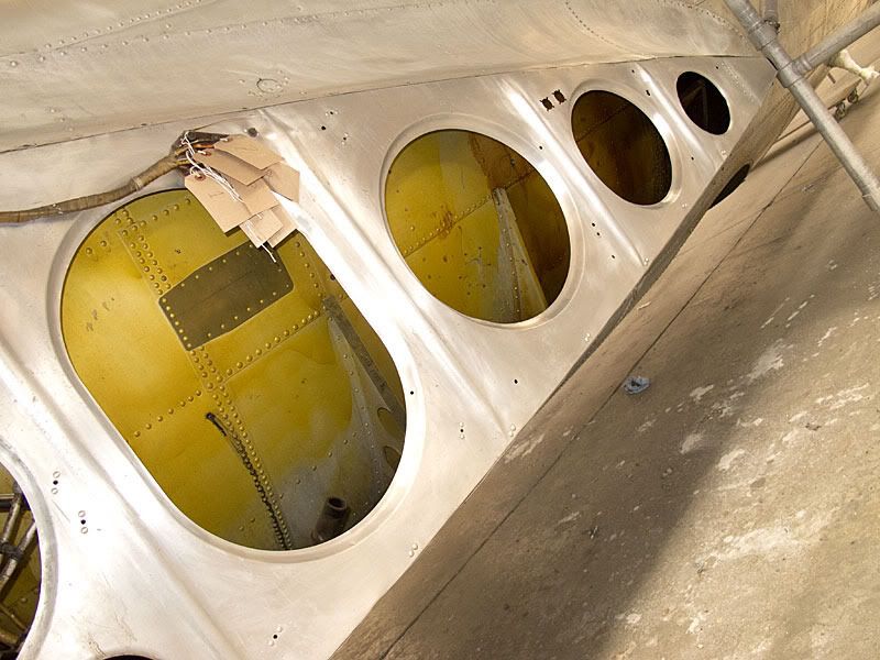

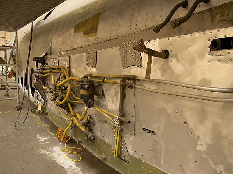

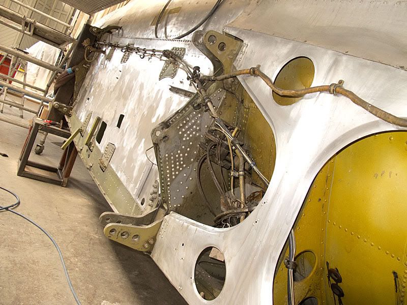

PostPosted: Wed Oct 05, 2011 2:11 am
Posts: 830
Time for another update !

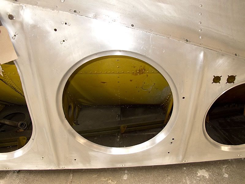

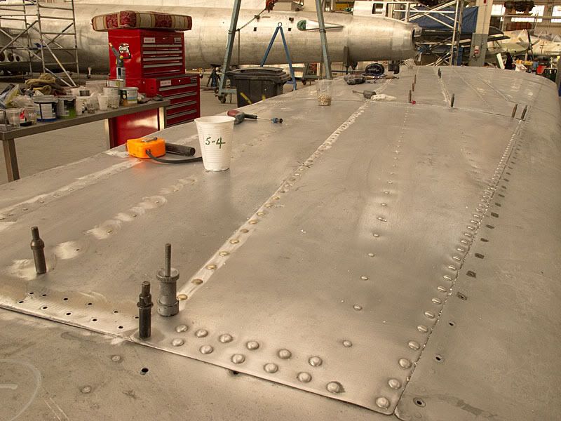

The inner wing sections are now looking like new
Though there's still plenty of detail work to do
Skins are being riveted back in place around the life raft hatches
The wing stubs are now being cleaned ......
You've gotta love those curves

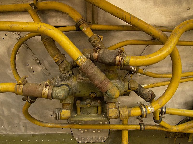

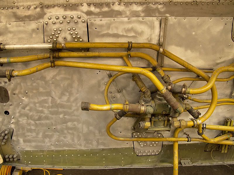

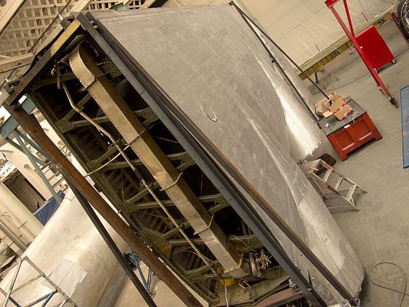

Around the other side ~ cleaning has highlighted much of the pipework for the de-icer system
This pipe system has to be inspired by genius ~ how on earth did someone figure this out and make it work

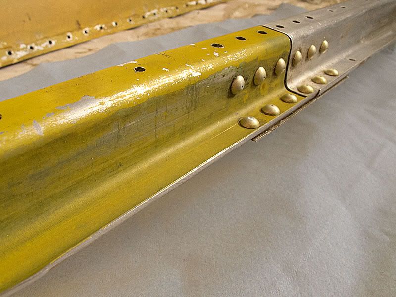

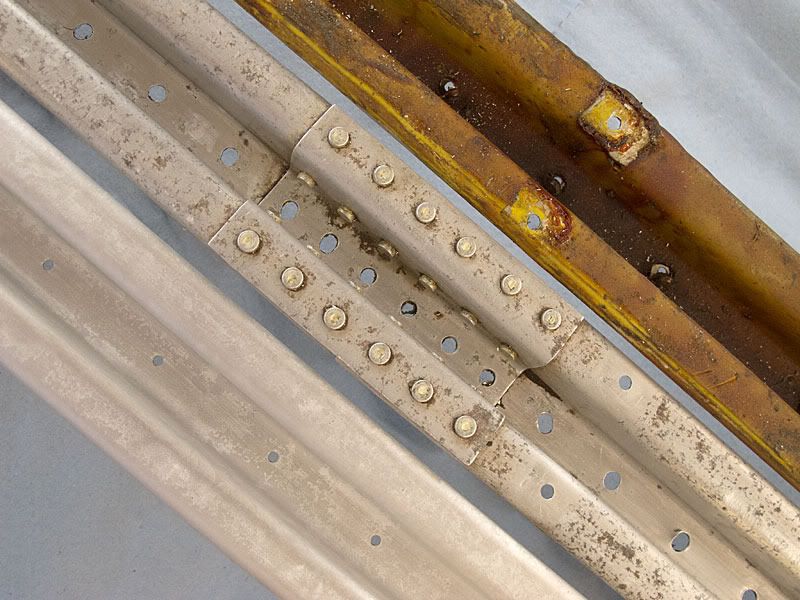

I'm assuming this stringer is all original ~ even though one section is painted and the other isn't
Here's a posed picture of stringers ( right to left ) before ~ during and after the cleaning process .....

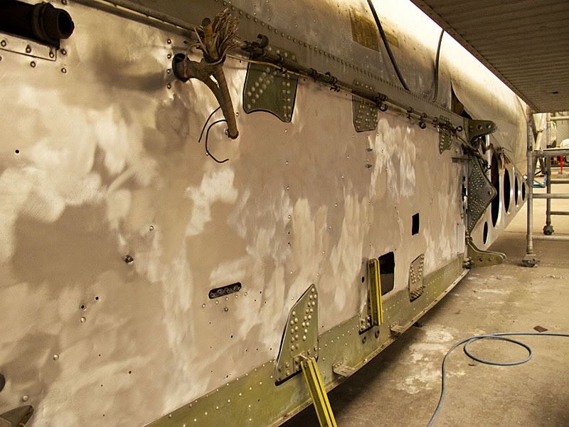

PostPosted: Mon Oct 24, 2011 3:37 pm
Posts: 830
I'm back ~ finally :D
Let's kick off with the question from Ken ~ as of today ~ Oct 24th 2011 ~ there is still no final decision about what paint scheme will be
selected for the the B-17 when it goes back into the American Air Museum. The plan is to have the major sections back in the AAM
before the Spring Air Show in May 2012.

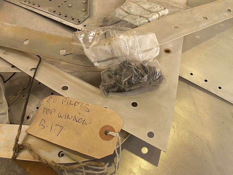

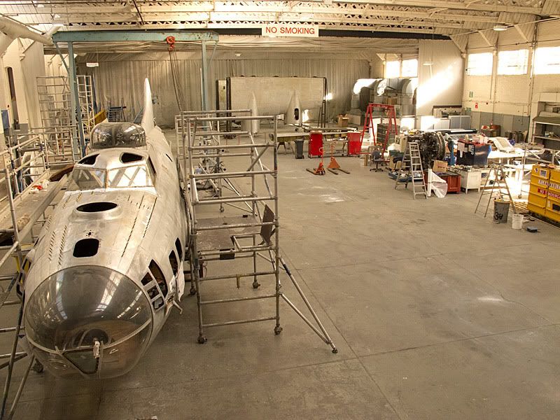

There's quite a bit to update you guys on ~ so let's get started .....

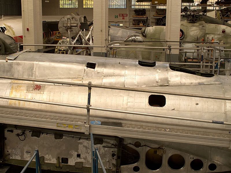

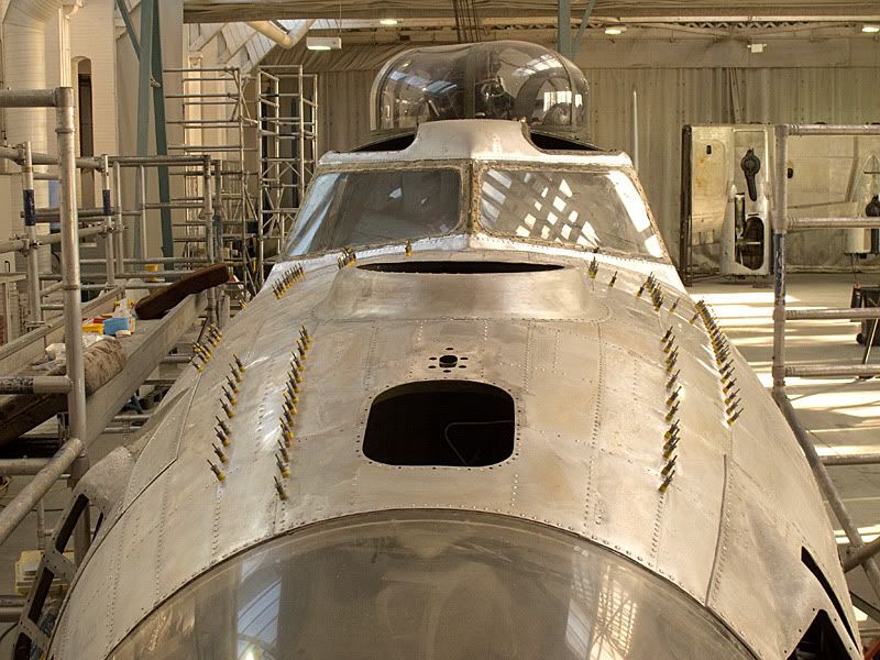

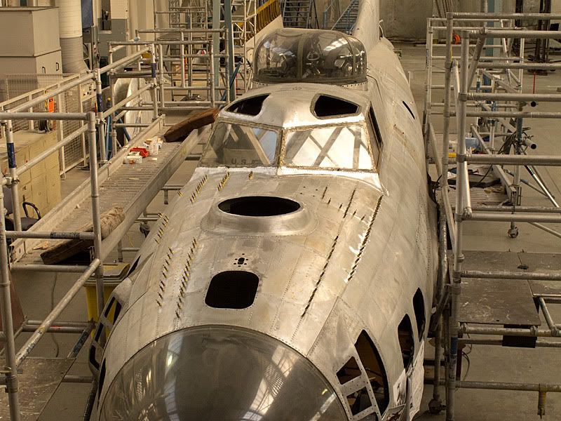

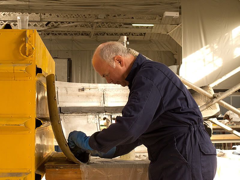

Corrosion was discovered in the top of the nose section
And this has been treated and is almost ready to be buttoned up again

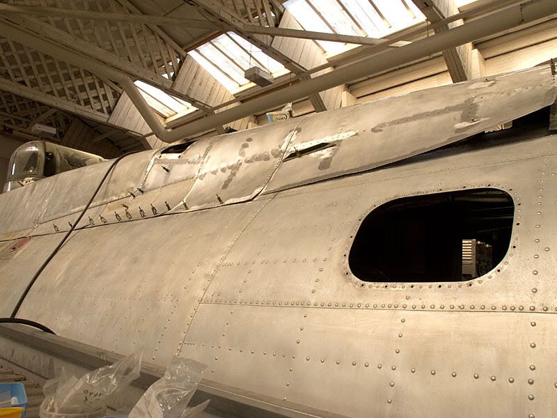

Restoration work on the inner wing sections has been completed and they have been shifted across Hangar 5 into the paint area
All that empty space next to the fuselage didn't stay vacant for long .....
As work gets underway to paint strip the rear sections of the inner wings
Meanwhile ~ detailed work continues on smaller components
Including the second horizontal stabilizer
Another update coming soon :wink:

PostPosted: Mon Oct 24, 2011 3:55 pm
Posts: 2673
An example of what NOT to do: In the latest group of photos, there are two fellows who are obviously working with chemical stripper. They're wearing protective suits and chemical-resistant gloves, as they should, but they're not wearing SAFETY GLASSES. Danger, danger, danger. . . :shock:
Dean Hemphill, K5DH
