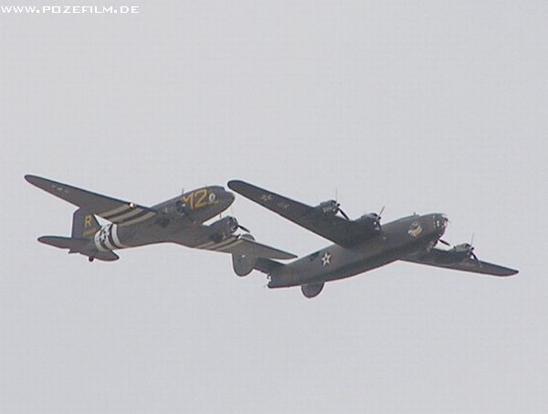

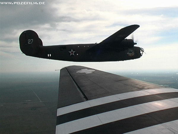

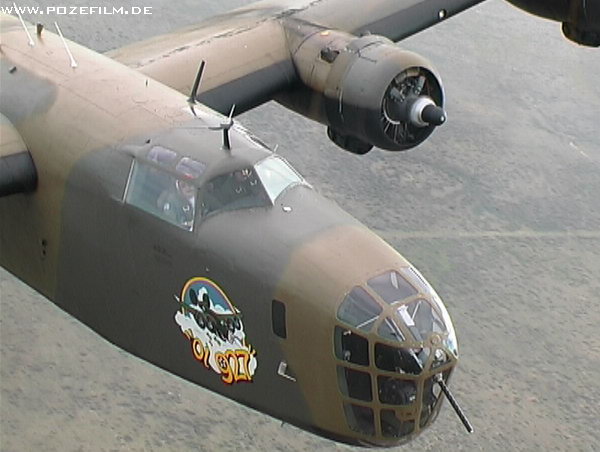

While the first operational year of “Ol 927” will come to an end, I think it is time to show a small video.
Please have a look here:
http://www.pozefilm.de/video/b-24a.wmv
Happy new year all,
Manfred
Close formation with camera ship Douglas C-53
Warbird Videos:
viewtopic.php?f=3&t=34289

Great video. Real nice air to air stuff in it...
PostPosted: Sat Dec 29, 2007 10:30 am
Posts: 4468
Great video and pictures. Thanks for sharing.
