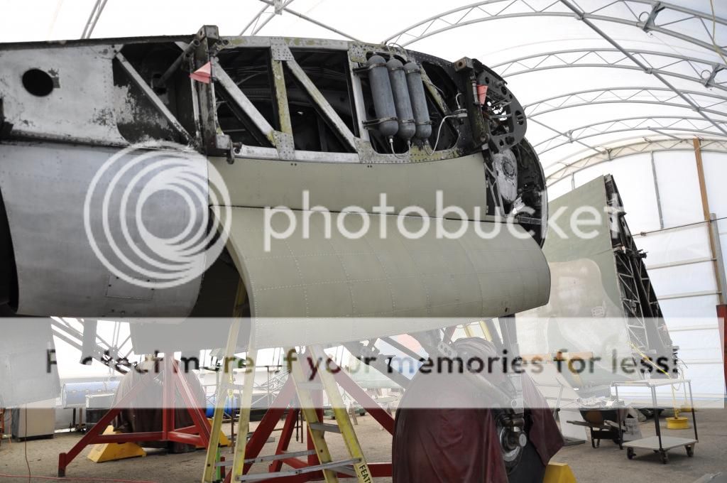

Today we accomplished a pretty big achievement! We were able to reinstall 2 gear door valances and 2 gear doors! These are the first pieces to be put back on the aircraft after being completed. :) Though they will have to come off again down the road it's nice to be able to have them back on the aircraft for display purposes.
We also managed to reinstall the tail wheel assembly into the rear fueslage today after one heck of a fight over the last few weeks to get back in working order for our move into the main hangar in November.
Prior to the tail wheel reinstall we had to repair some damage to the fueslage just aft of it. I spent a few days last week taking care of that issue. We figured it would be best to add another inspection hole here as well to gain access to several bolts that previously were not accessable.
Cut out of the damage.
Repair temporarily in place.
More to come soon!

PostPosted: Fri Sep 27, 2013 3:53 pm

Nice update Ryan! What was the square cutout for ??

PostPosted: Fri Sep 27, 2013 10:15 pm
Joined: Thu Aug 21, 2008 3:29 pm
Posts: 351
Location: Windsor, ON
If you're talking about the square cutout on the fueslage that's where the damage was originally. Then I put the doubler/new inspection panel over top of it. If you're talking about the one on the repair, that's the inspection hole.

PostPosted: Sat Sep 28, 2013 9:11 am
Posts: 1694
Location: canada
So you have to install twp patches then? Far left looks like the hole for the downward ID light then your new patch, but what is the one on the right hand side?? Camera mount?

PostPosted: Sun Sep 29, 2013 7:48 pm
Posts: 351
Oh I see what you're talking about now! The round one on the left is just a circular inspection hole and the one of the right is actually where the tail wheel strut comes through (there are two inspection panels that screw on there with a half circle cut out on each of them for the strut to pass through).
