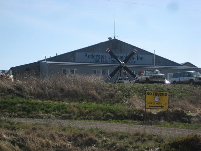

This is the Anderson Aeromotive Shop in Grangeville Idaho.

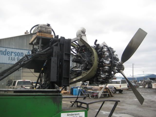

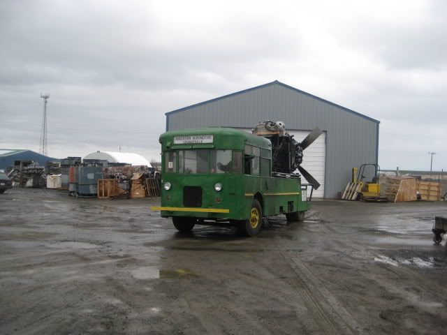

This is the test wagon with the new engine in tow.

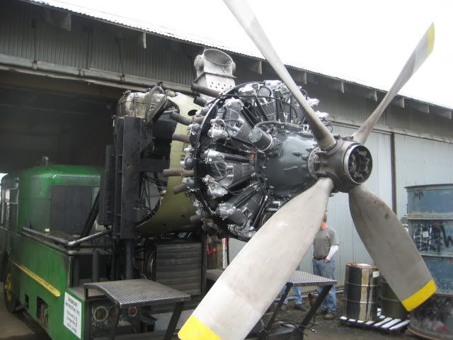

The engine is mounted on the test stand with a Sky Raider mount.

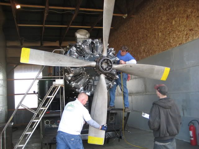

Isn't it beautiful!! That prop is off a Howard 500. It makes alot of wind!!

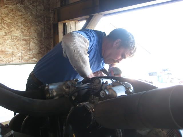

This is Dan on startup! I got to run it too!! :D

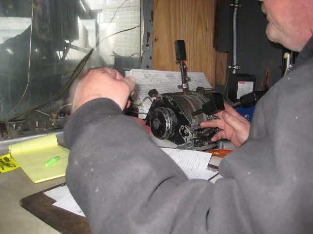

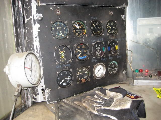

This is the instrument panel where we both monitored the temps, pressures, flow rates and RPM.

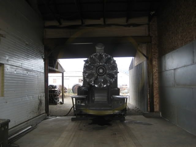

Makin' noise!!
We checked the oil screen about every hour of running and it just kept getting cleaner and cleaner. After running 15 hours, they did a compression check.
This is Ray!

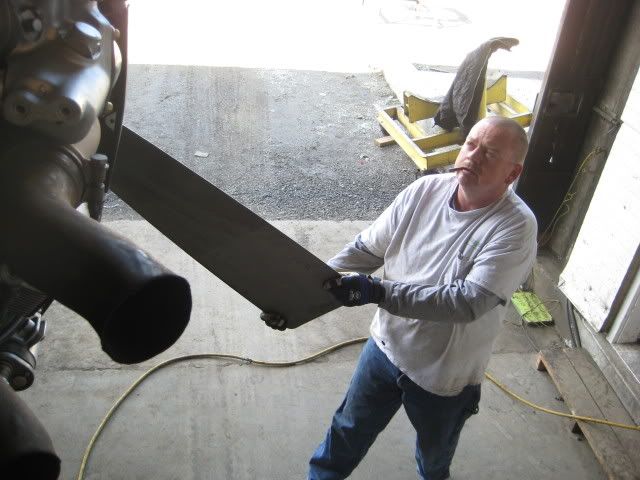

Dan's pulling the prop through for Ray to bring the pistons up to TDC for the compression tests.

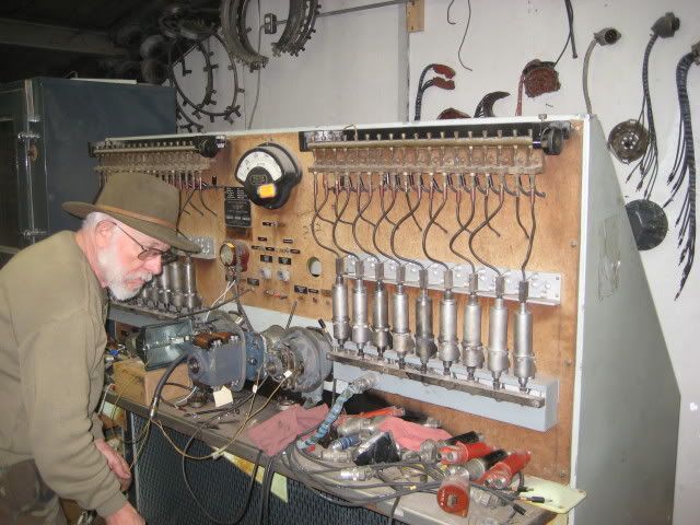

One of the really cool things up here is that most all the tooling and equipment is old but made for this stuff and working. This is Jerry, testing the coils and mags.

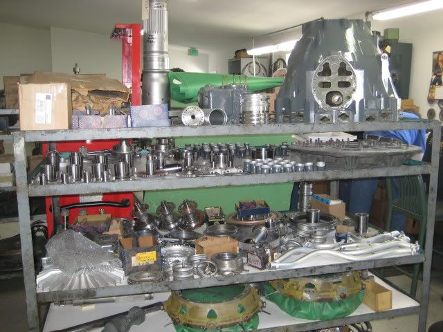

This is a portion of the parts for the next engine that have been cleaned, inspected and preped for assembly for Dan.

Do they run it in that tunnel, and must be for cooling?

15 hours was over a 4 day period. Yes it ran in the tunnel and the fuel consumption is based on what power setting we were running at. We ran at 1000 rpm,1200,1400,1600,1800,2000, 2400 and finally at 2850 with 51 inches to prove the blower. Fuel flow ran between 200 pph @ 1200rpm to 1800 pph @ 2850! Not on an Airport. Dan does most all the 3350 assy.
