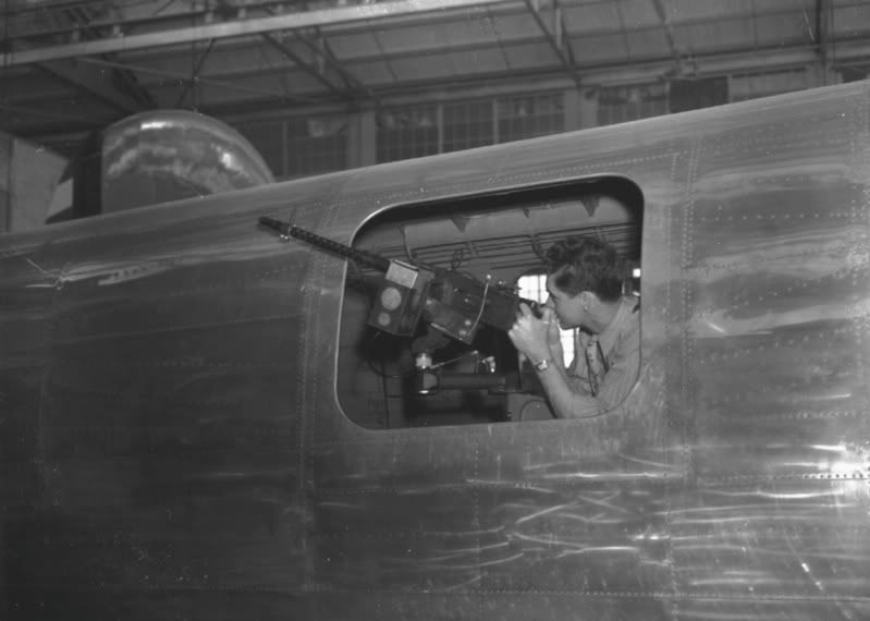

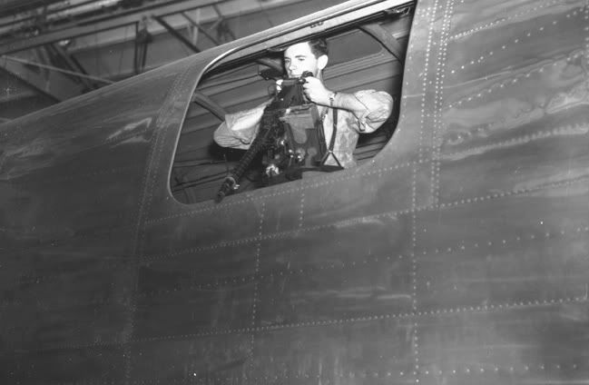

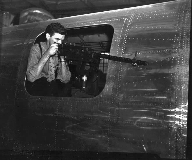

gary, This does not show the actual height but it gives an idea.
PostPosted: Sat Nov 18, 2006 6:40 am
Posts: 4468
Yeah, I have that same drawing. I to know that the floorboard just aft of the current entry door is the right height, so that is what I went by when making the bulkhead for the "new" waistgunner's floor. I think it'll be pretty dang close to what we're looking for. :wink:
Thanks for the cool waistgunner pictures. Do you have any from the inside? I'm also needing inside pictures of the tailgunner's compartment.
Gary
