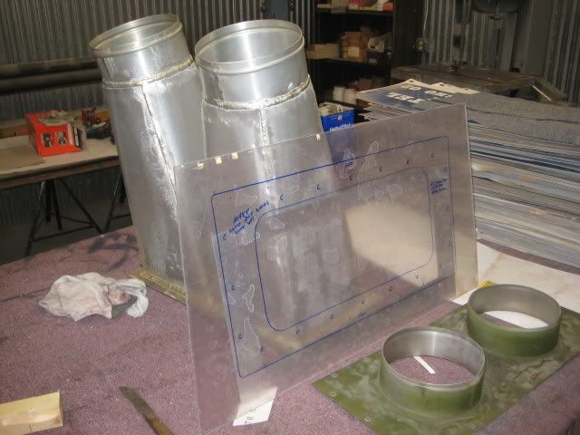

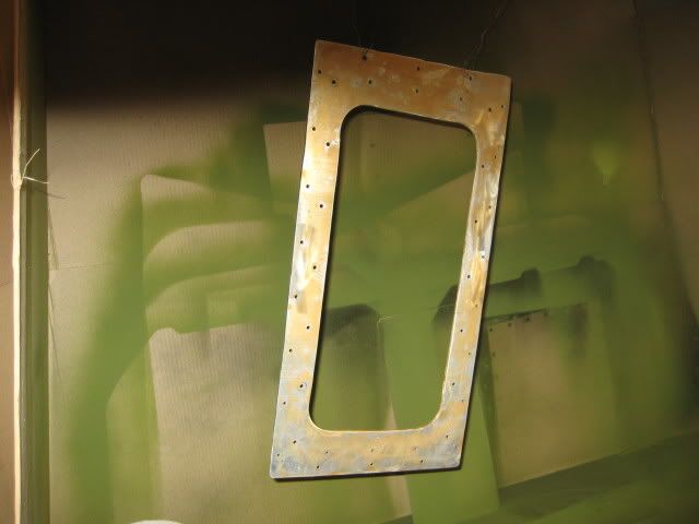

This is Brads handy work. As before, we had to make an adapter plate for the new induction trunk. We can't just go and make 4 of them because each is slightly different in hole locations. Brad made this one for the #2 engine and then made a tool out of Plexy, to make it easier for the other two to be fabricated.
By the way,before you ask, that's not rust, it's alodine treatment that discolors the metal. It's for corrosion resistence!

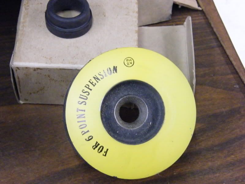

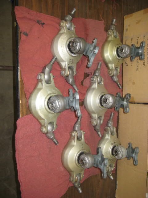

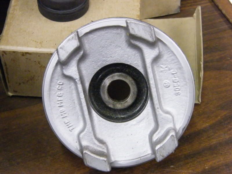

While Brad was doing that and then everyone was working on getting the #1 engine cowling off, Mark was in the shop working on the Dynafocal "LORD" mounts. He got all 6 taken apart, I inspected them and he got them all put together with new rubber cores and new rubber snubbers. This is his second go at it, so it went pretty well. The first ones he did were for the #3 engine with some help from John Meyer, so he learned alot.

New cores for the Lord mounts....

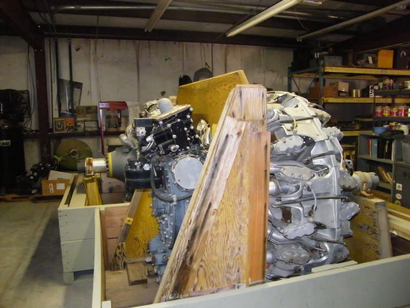

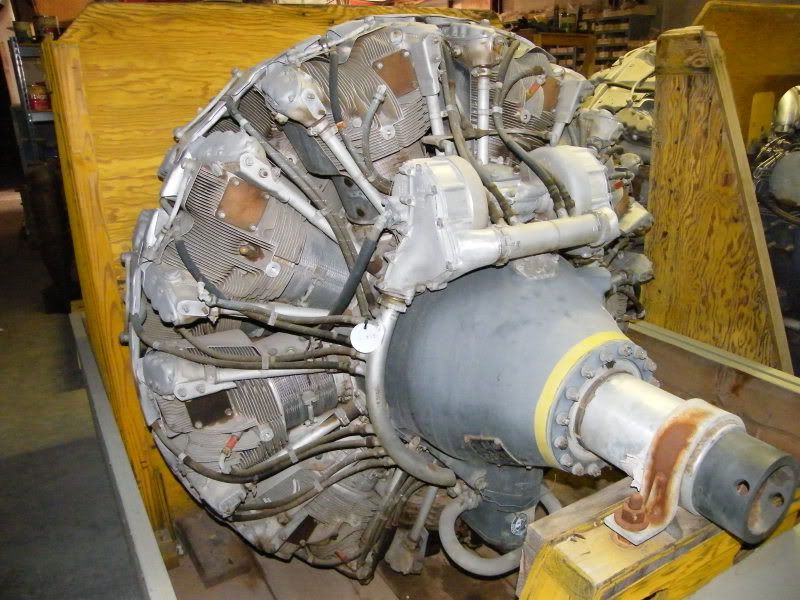

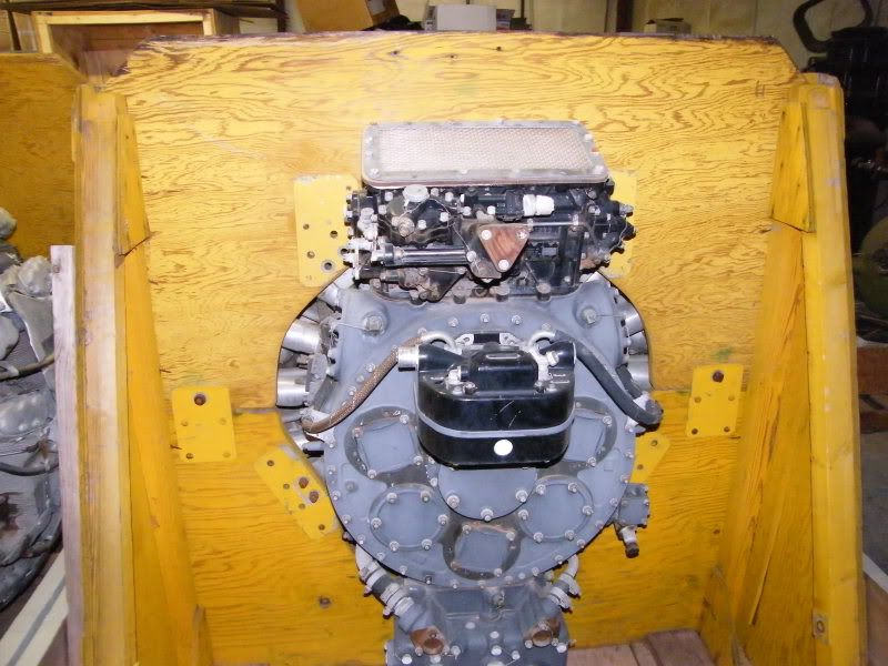

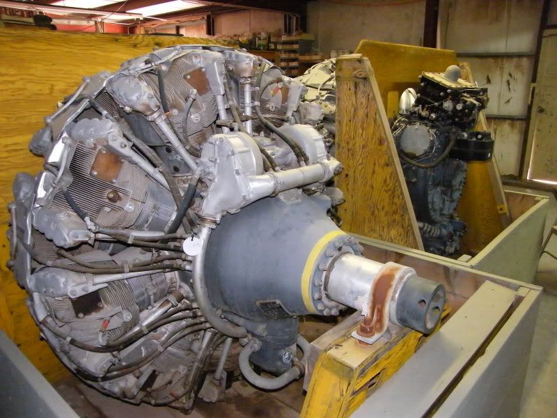

The next item(s) are something that are (or soon will be) for sale.... Two! That's right, TWO R-3350-57 B-29 engines. Not sure of all the details, but Dave and I have talked about this quite a bit..... These are complete engines (less some accessories) and would be a great addition for any museum.

Alan, those aren't -57s. One is a -23 and the other a -59.
Gary

Thanks for the correction Gary, now you know why I'm an RN! :oops: :oops:

Yes they are a -23 and a -59. They are in perfect condition and would be a great addition to any museum. PM me with an offer and lets get them out of this dusty warehouse!
Dave
