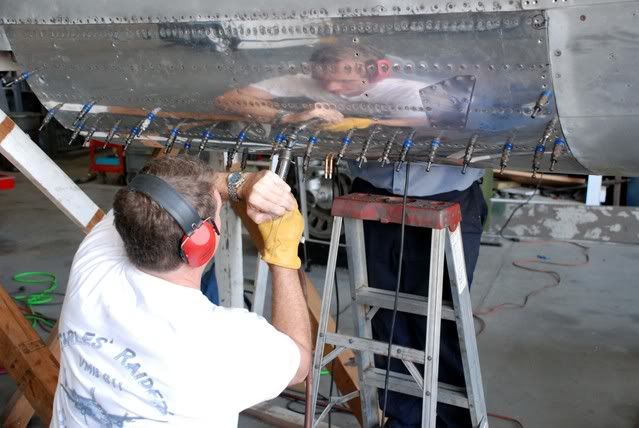

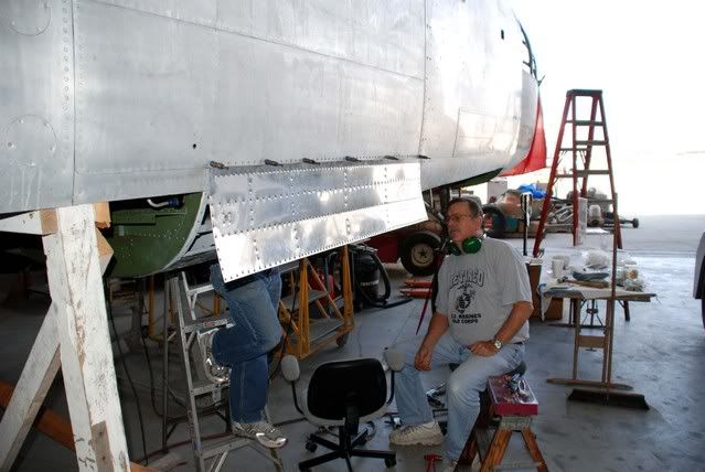

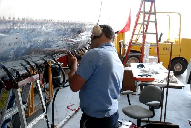

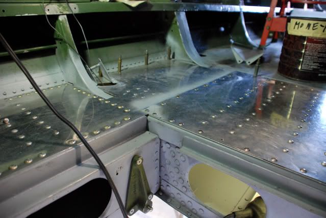

We are almost done with the two forward belly skins. I know the rest of the guys will join me in saying goodbye to dimpled skins! I hate working with them. I have much better luck with counter sinks any day. It was a struggle all day long to get on the rivets to buck them. Several rivets had to be shot two or three times and we found that many areas are impossible to get at and will have to be cherries. Jeff surveyed the areas of the left wing that were exposed when we removed the hat channels and found (SURPRISE!) a few areas of corrosion. The good news is that there appears to be only one area of concern. That is a whole lot better than the dozens of areas we dealt with on the other side!

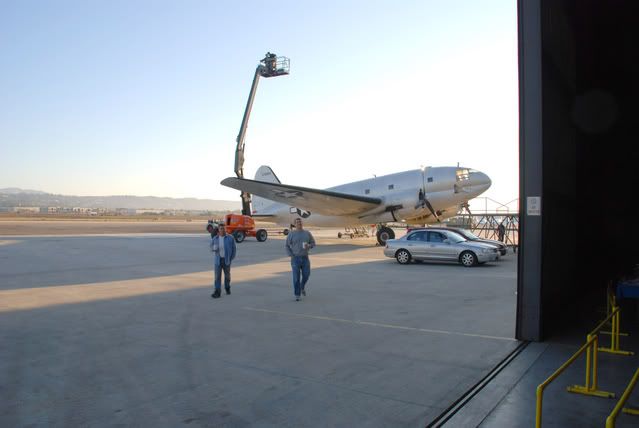

We got together yesterday for a rare Monday workday. It was a fortunate thing we did. When we got to the hangar we were met by a production crew setting up to shoot a television commercial involving our C-46. Sound wasn’t involved yesterday so our riveting wasn’t an issue. They shot stills using a cherry picker for most of the day. They will be doing sound today and tomorrow but we won’t be there to create problems for them. I almost made the decision not to post today. Not a lot of exciting progress to report I’m afraid. I realize most of you probably wouldn’t get too excited about us shooting new floors in the nose or replacing the bolts on the right gear or dressing out the surface corrosion we found on the left wing but that is what we did. It was a typical day really. That is what we have been doing for years now. That is what we will be doing for a few more years. At this moment I really envy Gary Austin and his winter project of modifying the B-24 927. This year will be my sixth year, my sixth winter on our project. I wonder how many more winters we will spend before we fly?

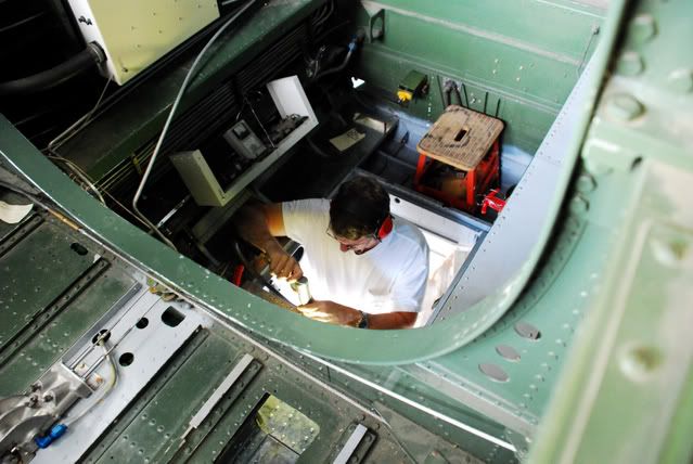

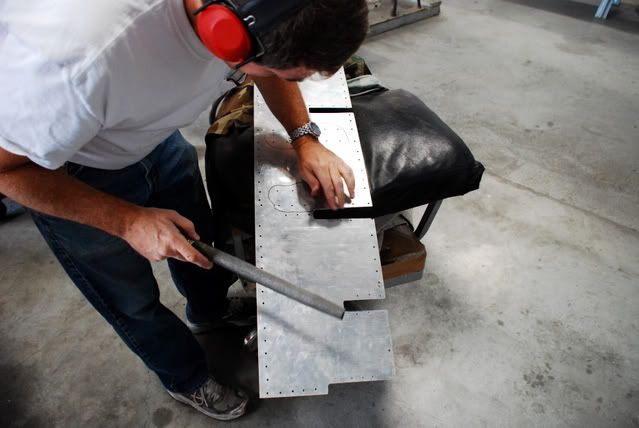

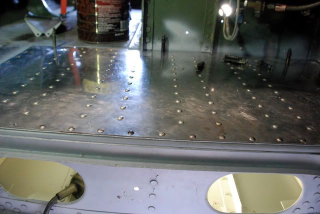

Jerry continued working on cable runs. Ken started cleaning up and repairing the close out panels for the tail. Scott and I spent the day working on the floor behind the cockpit. Scott is really something. Bucking rivets in this forward area is a real bear. Stuffing two pleasing plump bald headed old farts, (wait a minute he has a full head of hair at least it looks like his) in such a small space is no easy thing to do. I know it hurts like hell to buck some of these rivets but Scottie never complains other then an occasional “Ouch”!

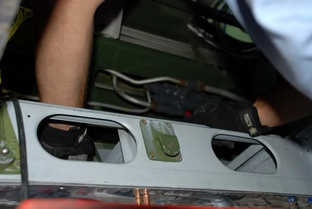

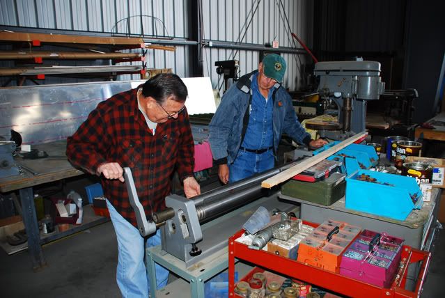

The most exciting part of my day at CMA was just getting there! During my drive over the Grapevine I experience rain, heavy winds and thick fog, all at the same time! Ken and Roger made some new close out panels for the tail and Jeff and I started formulating our plans for running the hydraulic lines. Jerry is working on the cable runs for the engines. Jerry’s work is so beautiful he should be making watches!
Dan
The watch maker
The old and the new
Ken and Roger bending metal
