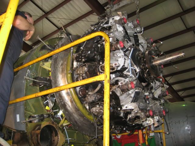

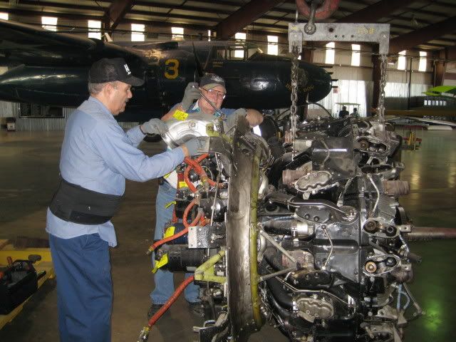

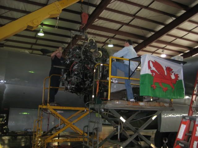

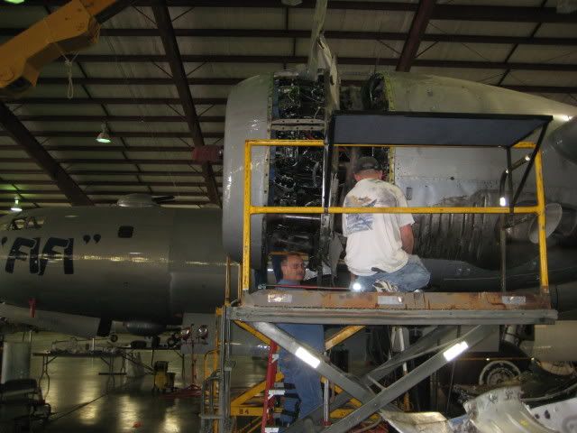

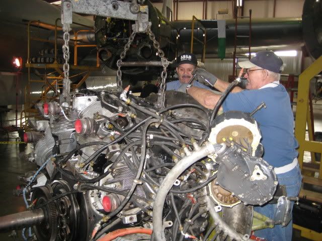

Here's some of the pics from yesterday that I promised!
Don't worry guys, there's plenty of stuff to do!!
It was St. Paddy's day!
She's loose!!
Off she comes!!
Rudy and Jim

You don't need a crane for an engine change.., you need one of these!!!
In the 330th, they called this a Cletractor.., not exactly sure why or what.., but necessity is the MOTHER of invention!

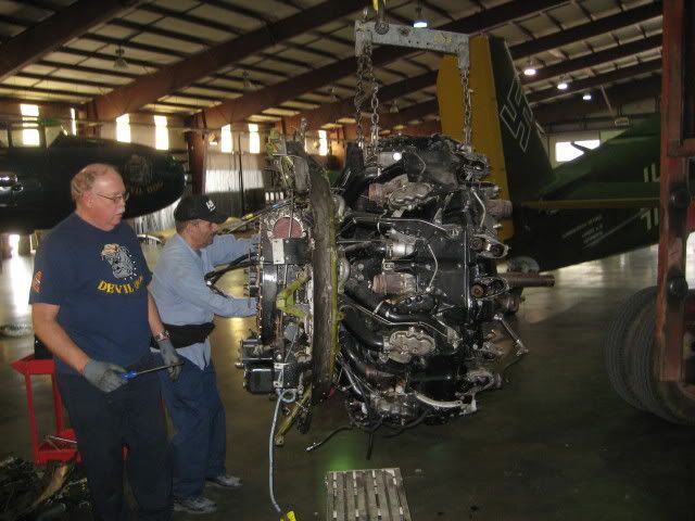

Very cool, thanks for the pic. Ours is called "The Pettibone" She's really getting a workout lately! Last week the P-82, this week, the B-23 engines.
Then the 3350 yesterday and today a 4360 off the Mauler. Shes worked her butt off.
Dave

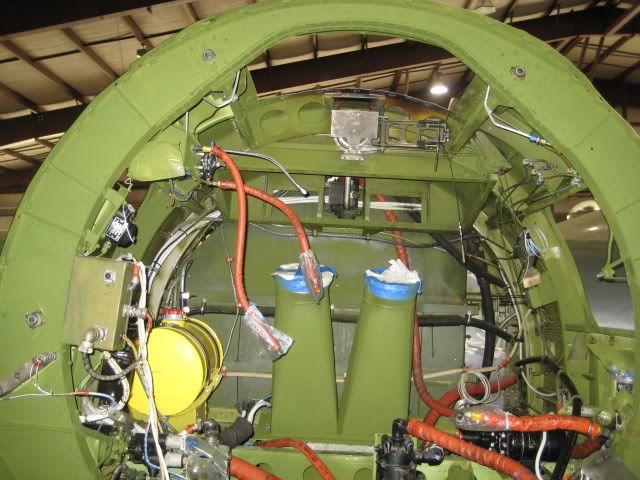

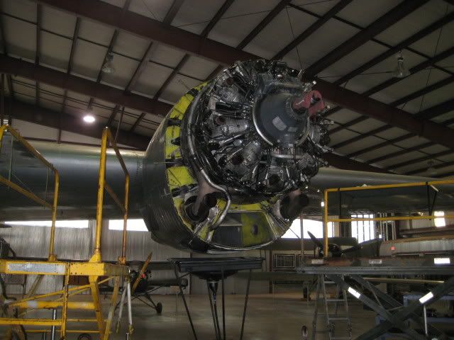

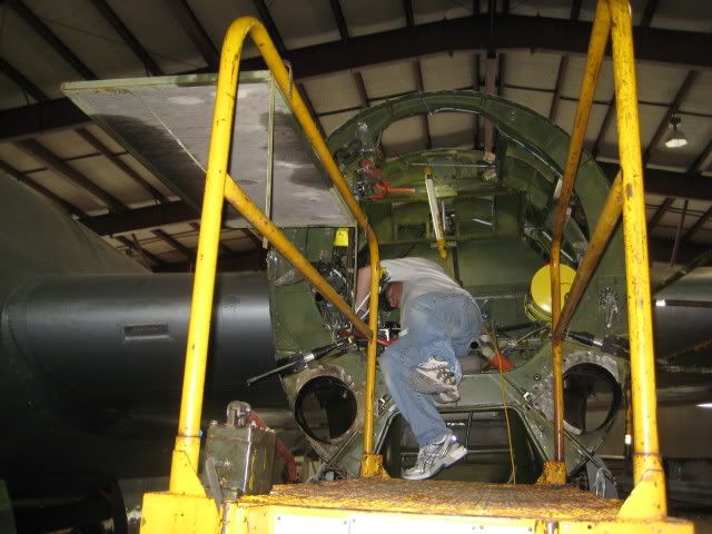

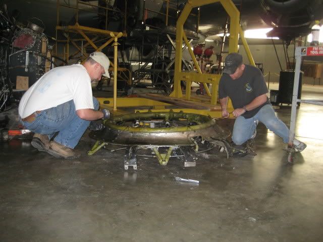

This is the #3 nacelle now!! No more Boeing Primer!!!
Thanks to Chris for removing all the tape from the "tape party"!!
Mark and Rudy finished removing the engine mount yesterday.
This is Marks daughter, Hope, out helping with some flyer stuff! She's been out before and is a great helper!!
Yeah, Brad's here and he and Chris are kickin ass! They are some really awesome help!!!

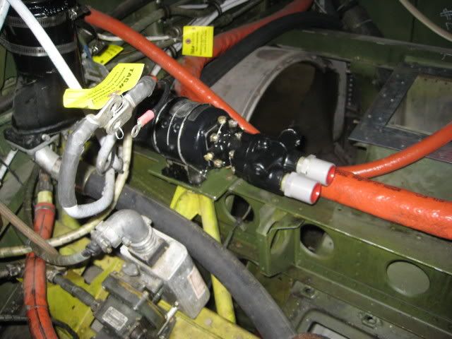

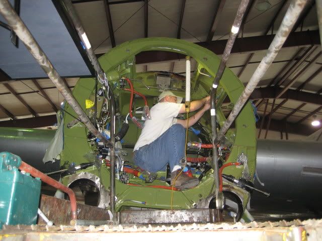

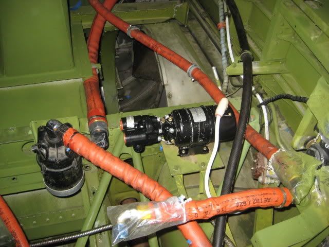

Brad removed the feather pump on #2 and installed a newly rebuilt one in it's place. Chris did the same on #3 with the preoil pump.
Then Brad did the #2 preoil pump and kept going on the mount ring with Chris!
There was a question about the preoil pumps earlier and I'll answer it now. They are the same as the feather pumps but are set at a lower pressure. They just pump oil into the engine and nose case to provide pre-lubrication before engine start.
Dave

Is there a filter before it goes into the engine? What kind of pump? Gear?
And whats 4360? Pics?
PostPosted: Sun Mar 22, 2009 8:26 am
Posts: 1817
Location: Irving, Texas
Yes, it goes through an oil screen before going in to the engine. The pre-oil pump helps to lubricate the engine before angine start. The engine has a large plain bearing surface that can be damaged before the ne driven pump can get oil to it during start. It can save having to tear the engine down for overhaul prematurely.
Electric driven gear type pump.
4360 is a Pratt & Whitney R4360 engine, with 4,360 cubic inches. The R3350 is built by Wright and has 3,350 cubic inches. The "R" indicates an engine of radial design.

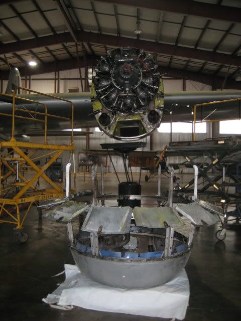

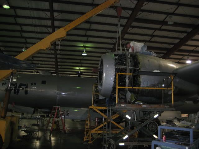

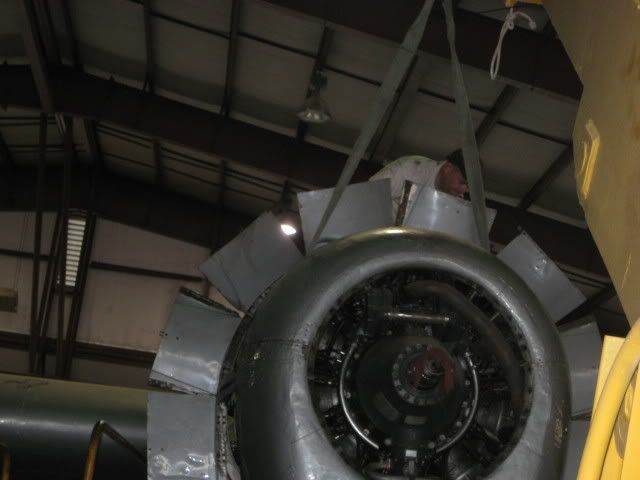

Work continued yesterday with alot getting done. Among them was taking off the #1 engine cowling. Brad was here with his Dad helping and Chris was assisting as well.
Oh, more yellow primer? That's gotta go!!
Getting this done this week was a real bonus.
Thanks to Chris, Brad and his Dad, Mark and John!!! I really enjoied having you here and you can come and play, anytime.
