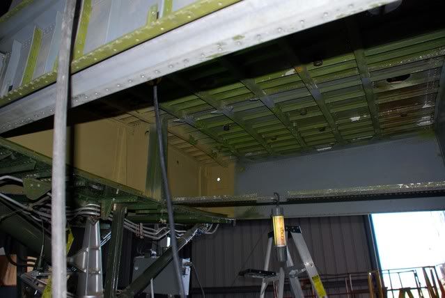

Yesterday was my first work day since the roll out at the air show. Finally, after 29 months under the right wing I would be working on a different part of the airplane! Finally, after over two years, I would move to the other side of the fuselage, the side that faces east, the side with a beautiful view out the hangar doors and all of that fresh air! I would no longer feel like the troll living under the bridge. Finally out of the darkness of the west wall and the ugly view of the metal shop. Finally I would be out of hibernation! Finally…what? They BACKED the plane in? You want me to work on the left wing now? We are going to rebuild part of the left wing? But that means the same old scenery. Oh well! I guess it isn’t so bad being tucked away on the west side after all. It is private and I get enough sun light on my drive to and from Bakersfield. I am very familiar with the guts of a PBJ wing so even though it is like working in a mirror there should be few surprises. Right now I am thanking God that PBJ’s aren’t biplanes! Someday, someday, I will run out of wings to rebuild and noses to rebuild and fairings to rebuild and flaps to rebuild and floors and skins and landing gear and tails and engines and………fly! Someday.

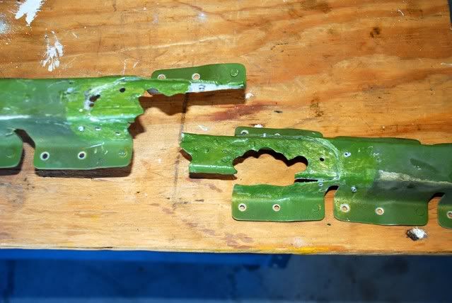

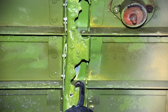

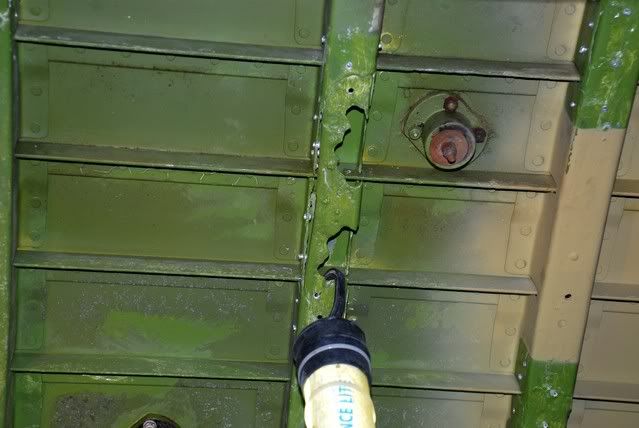

Where would you hang that trouble light if you didn't have all that corrosion?
PostPosted: Wed Aug 29, 2007 6:25 pm

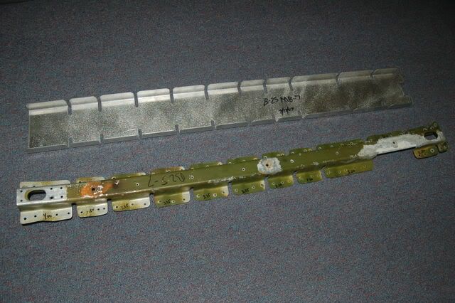

What are the plans for manufacturing that former? Will you guys send that out or do it yourself? Pound it out over a mandrel or brake form and then curve it in a die with a press? Just curous about the process you will use!
PostPosted: Thu Aug 30, 2007 10:37 am
Posts: 789
When we replaced the hat channels on the right wing we farmed the work out ( I think you know the guy he has a little operation in Chino lol) and it cost us thousands. Each one is a different length and the curve varies with the wing. We only have to replace six on the left side and will send the work out. We can do 90% of the work but unfortunately these are beyond our capabilities to manufacture. We have the talent but lack the necessary machinery to do the job right. This area of the wing structure carries the highest load and we won’t do anything to compromise the strength of the structure.
Check out our new website.
PostPosted: Sat Sep 01, 2007 12:12 pm
Posts: 789
Here is step one...

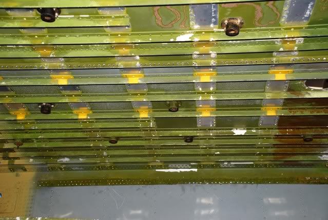

I felt like I was back on the DC-8 line in building 80 at Douglas Long Beach yesterday. We had multiple air hoses strung and 4 guys drilling and hammering at the same time. The sound of progress! If it was only possible to work more than once a week! All of the corroded hat channels have been removed from the wing and are ready to be sent out. Jeff and I started shooting the rivets on the lower skin at the front crew door area. I’ll be out of town next week but I am planning on being at CMA on the 18th.
