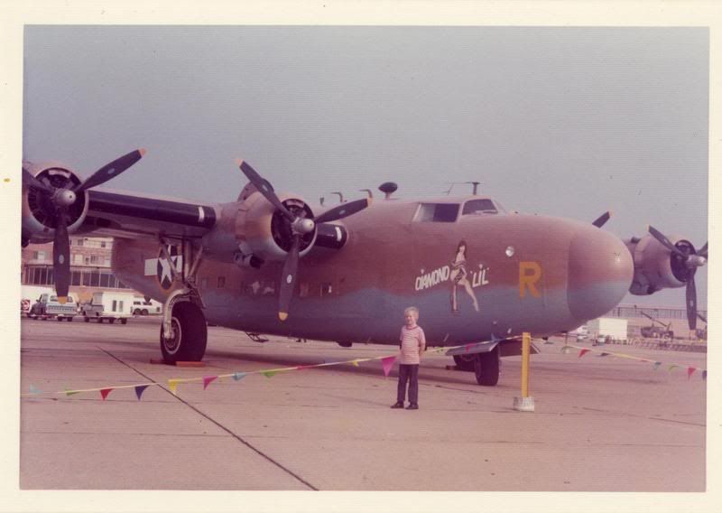

It is really interesting to watch this thread as one of my first warbird experiences was with Diamond Lil back in 1972 when I was 7 years old.
PostPosted: Wed Nov 15, 2006 6:43 pm
Me Too!
(believe it or not I found the show ticket stuffed behind the photo page! )
