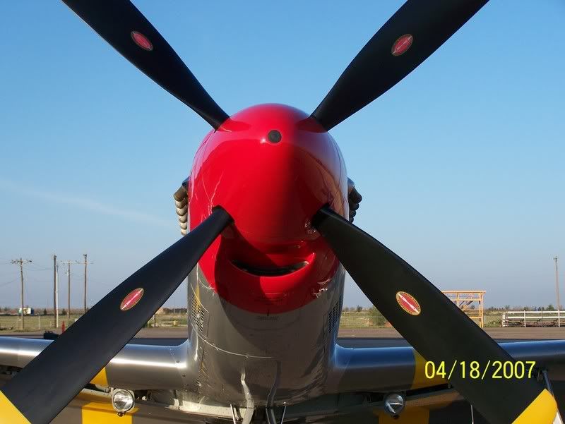

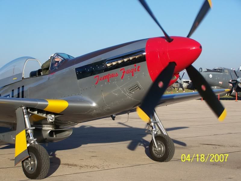

Found this photo day.

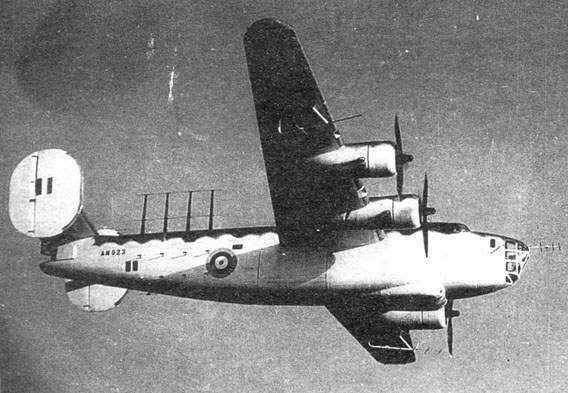

bluethunder28...Cool picture, thanks for posting. And, yep, that's the squadron that AM927 was going to be in had it actually ever made it to England.

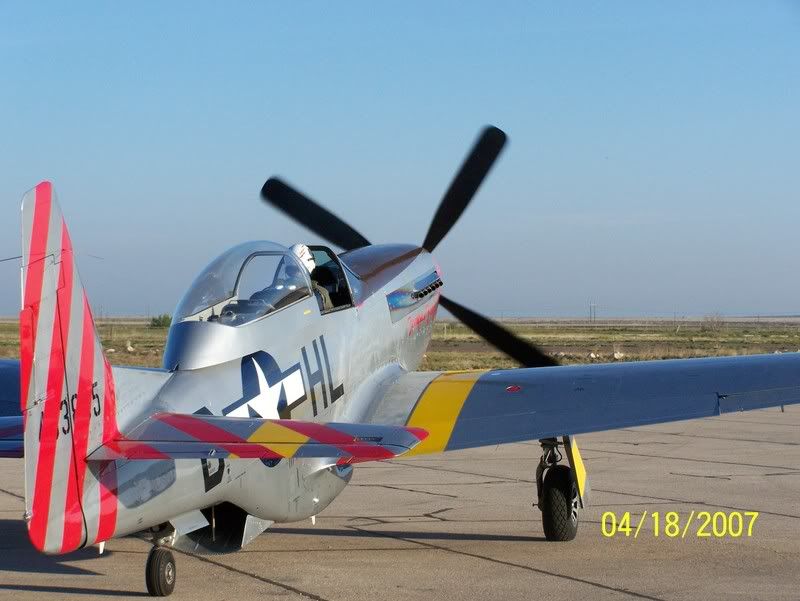

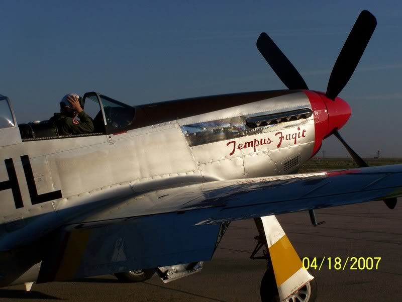

Now sometimes there is a work break or two,especially when a TF-51D is pulled from the hanger and about to depart, so out comes the camera and pictures appear. This bird was really sweet, and so..............smooth, almost beyond description....... here goes...... Alan
Early morning glow.
Engine idling smoothly
The taxi out
Just call me Al.
