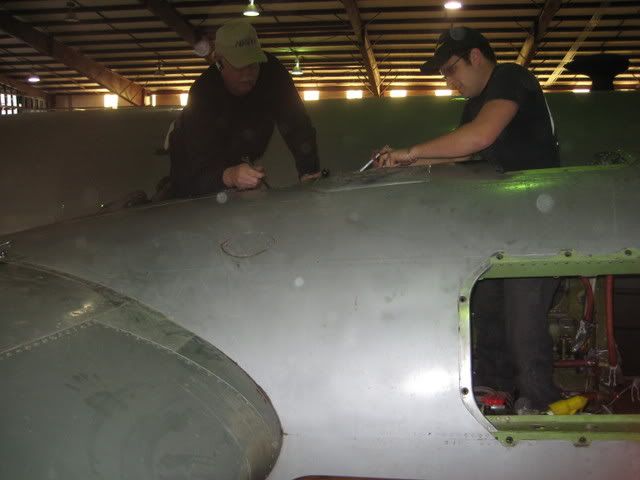

Today is my day to get caught up so here we go. The first thing we got done was to get the mockup 3350-95w up to Nelson's.
Also pictured is an old dimpler that Nelson's team will repair/restore and put to good use.

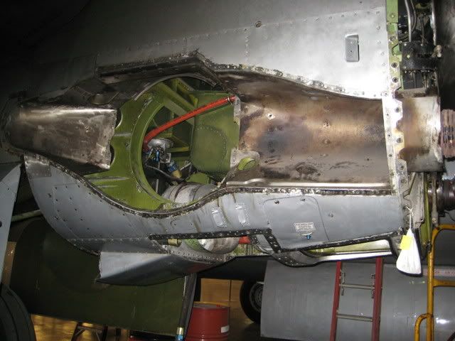

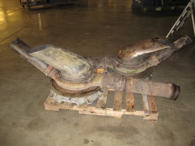

Then I got to get started with the real project! FIFI :D I choose the #3 engine as a starting point, mainly because, it was already uncowled and it is also the first engine started when we go flyin'. It's #3 then #4 followed by #2 then #1. Anyway, the rest of the exhaust needed to come off.
This is the full exit exhaust reassembled. it shows the hood attached to the turbo housing. Nelson will try to eliminate the excess parts like the turbo housing and make an exhaust that will look the same but under the hood, it will be a much cleaner and lighter assembly. Probably be more efficient as well.

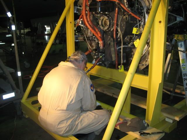

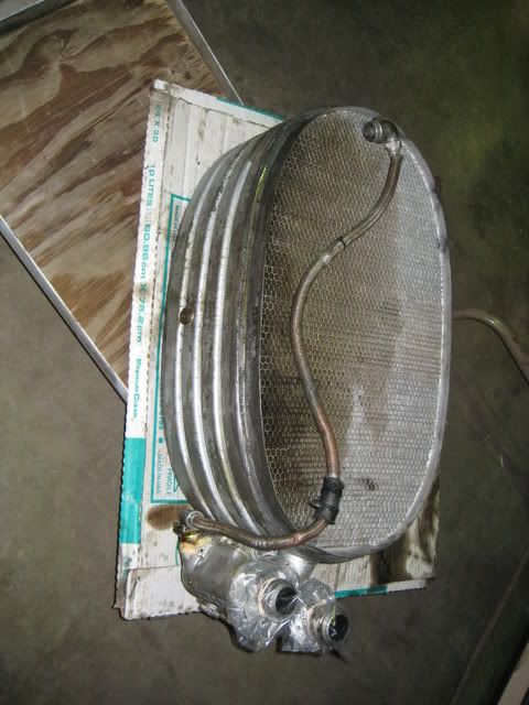

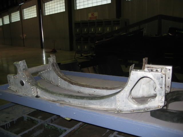

Next I drained all the oil from the tank and from the oil cooler. Then I had two volunteers (not pictured :oops: ) remove the oil cooler.
The oil cooler sits on this cradle which has to come out with the cooler.

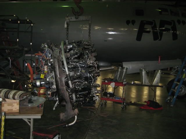

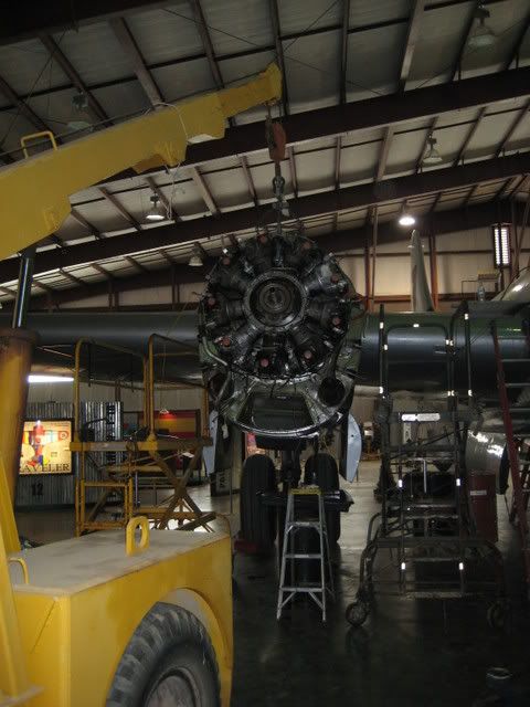

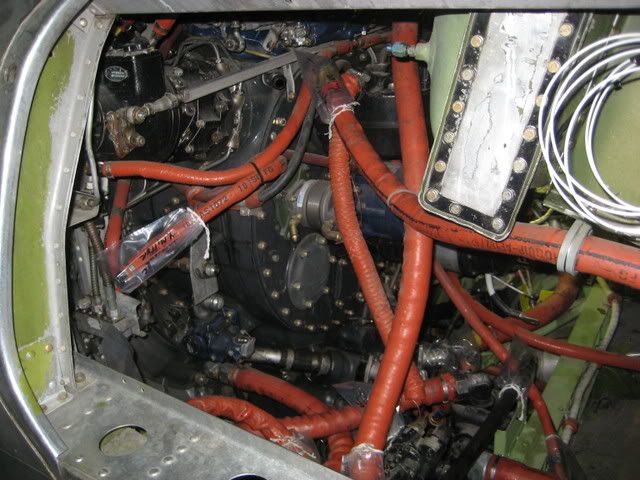

Now comes the fun part!! Engine removal. The book says " the engine and the mount are removed as a unit. Disconnection points are marked by international orange colored bands" :lol: Well there are no orange colored bands??

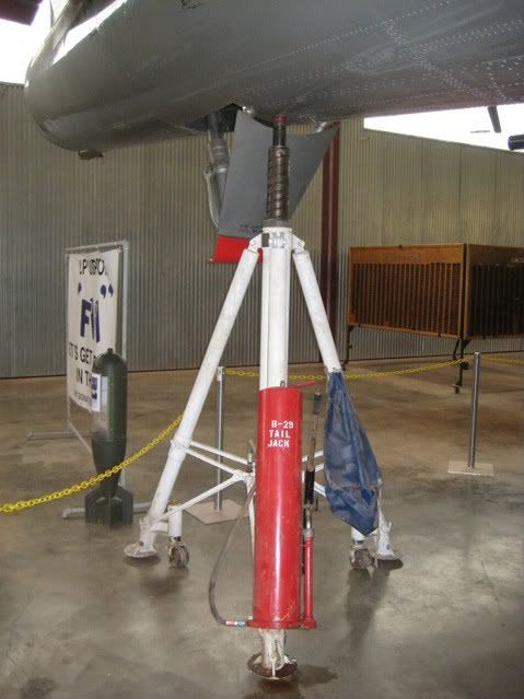

It also mentions to put a jack in place, to support the tail, which I did. You know I don't want to be "that guy" that let FIFI sit on her tail!!

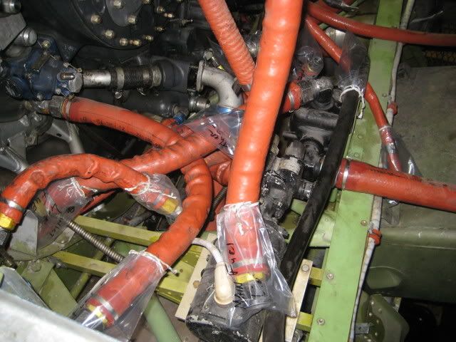

Mark and I started disconnecting hoses and wires and all the stuff needed to remove the engine. I make it a common practice to bag, cap and mark all lines, fittings and hardware. It just makes it so much easier when you have to put it all back together.

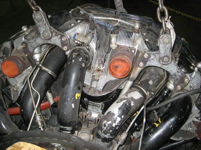

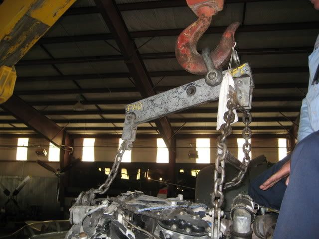

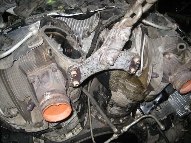

Bring in the crane!! The lift bar has 6 attach points, 2 on two cylinders on the front row and 4 on three cylinders on the back row.

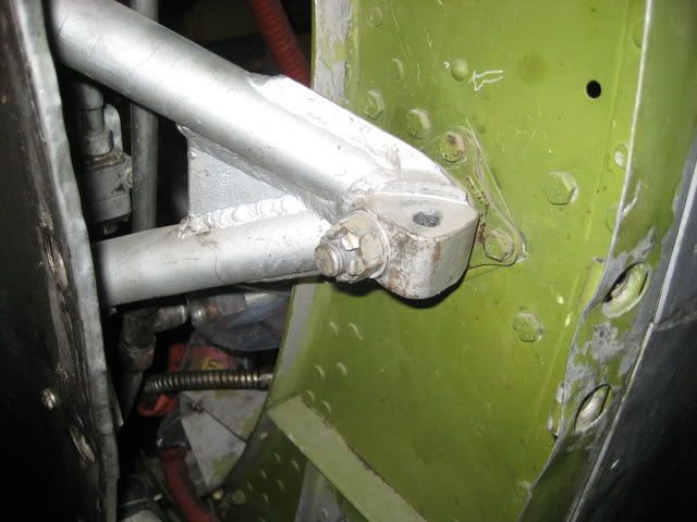

This is where the mount attaches to the nacelle at station 0.
Remove these nuts and off she comes!!

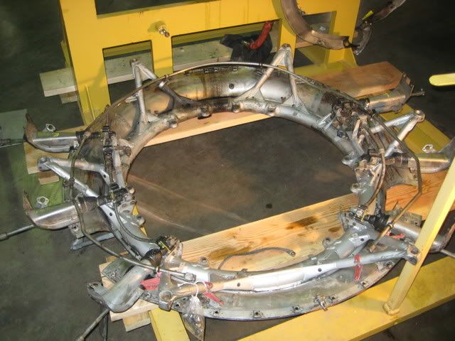

From here we put the engine in a stand for removal of the components necessary to take the mount off the engine.
Mark is having way too much fun here!!
That was easy :D

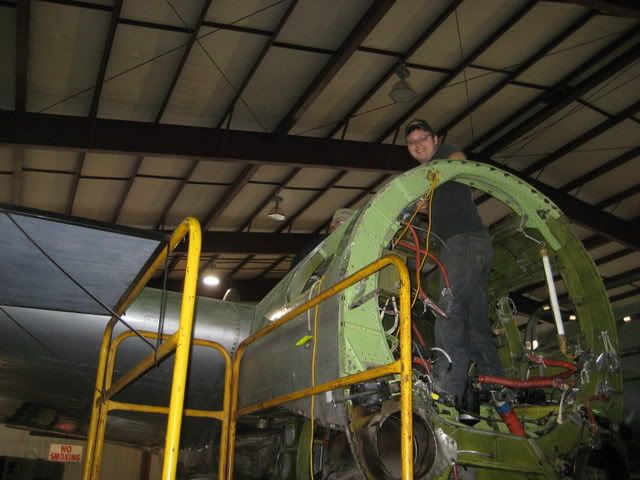

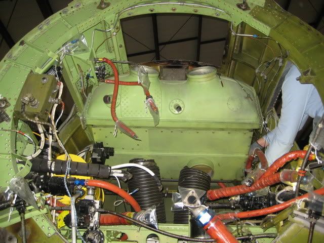

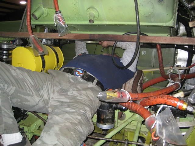

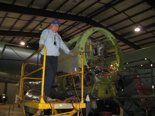

The next thing we needed to do was to remove this intercooler plenum.
The current setup has this intercooler plenum not being used as designed. With no turbo superchargers, there was no need to cool them so all that stuff was removed many years ago and the plenum is basicly empty. What Gary and Nelson came up with was to remove it and put a replacement induction trunk that Nelson designed and fabricated, in it's place. This gives us a load move room back there and saves weight.
This shots places me under the darn thing, so when it comes loose I can hold it on my chest? Not really, you do see the board I have placed underneath it so it doesn't land on me. Mark Russell and I wrestled that thing outta there and we called it a day. Miller Time!
The next day Mark and his helpful hand, Wes Miller, came out to help. Wes is an A&P student out here at the Midland College. They had to reattach the hardware that was removed from the intercooler door actuator that we had to disconnect, to gain access to the plenum mounts. The intercooler door is now locked in the closed position! Isn't it great to see them having so much fun getin dirty!

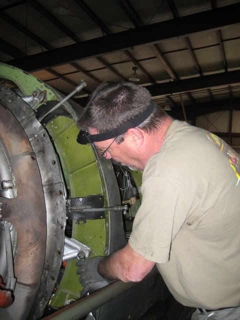

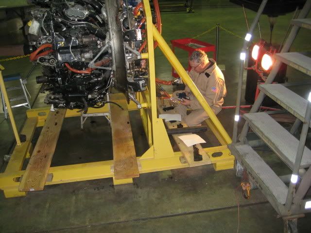

He is working on taking the accessories off the #3 engine so we can get the engine mount off. Looks like he found a good use for those flight suits we had to buy a few years ago and never wore!! NO offense Charlie!

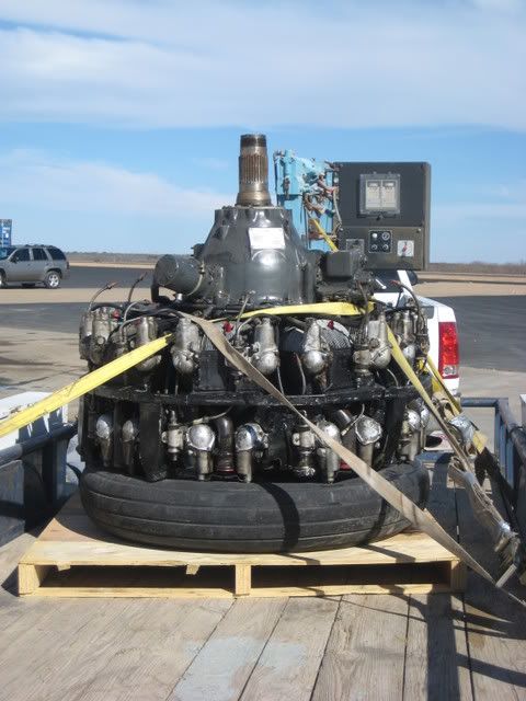

Here we have Ray Pearson helping Mack with getting the mount off the #3. Yes that is an approved engine stand for a boat anchor! Actually, this engine just had a nose case chip light which was found to be caused by a nose case gear tooth that broke off. This one could be repaired without too much trouble. It's for sale, make offer!
She's Off!! Now it needs cleaned and inspected!
