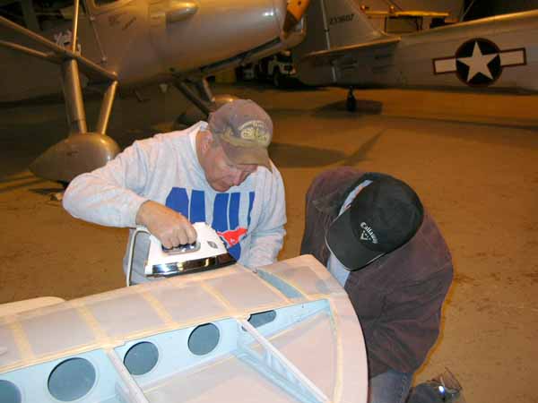

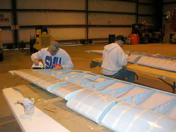

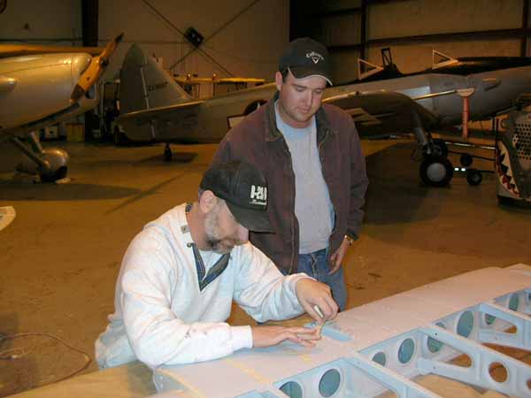

Here is a brief update on the recovering of the B-24's rudders and elevators over in the High Sky Wing hangar. Below, Chris Trobridge applies tape over the rivet heads under the supervision of Lance Sommers, who is an A&P and is training other Wing members in the art of fabric work. Chris lives in Lubbock but comes down some weekends to help out with Wing chores.
While Chris works on one rudder, Bill Coombes has glued fabric onto part of the other B-24 rudder and is now using an iron to carefully shrink the fabric.
A close up of Bill and the iron with Lance advising on the proper techniques. Bill has experience at this with large R/C aircraft but says this is a bit larger scale than he is used to.

In my experience in building RC aircraft, the iron is only used to seal the edges of the covering and a heat gun is used to shrink it. Wouldn't it be easier in this instance too to use a heat gun?

I'll answer this one for Randy. It is crucial for the heat range to be uniform when shrinking the fabric, particularly initially. You want the fabric to slowly be shrunk, a little bit at a time, so that it lays down properly and doesn't bend or warp any of the underlying structure, among other things. The iron is the only way to do this accurately. We (or they in this case) actually got one of those fancy little laser temperature thingys and used it to calibrate the iron. They put a mark at 225, 250, & 275 degrees (I may be a touch off on those figures, as I don't have the book in front of me at the present). You shrink the fabric in stages with the iron, NOT all at once with a heat gun. Sure, it could be done, but it's going to look like crap and it'll surely have some areas that will be too loose or too tight.
I'm nowhere close to being a fabric covering expert, so I'm sure there are better ways to answer your question, but I hope that helps.

We have Poterfield hanging from the rafters of our hangar that the fuselage tubular is all tweaked because someone used a heat gun to shrink the fabric. Poor thing is destined to hang from the rafters.

Thanks for the info guys, definately makes sense. I know when shrinking the fabric on our little RC planes you can induce a warp in the wing if done improperly. I didn't think that would be the case in a larger metal structure, but it seems that the problems we experience scale up to the full size as well.

A heat gun gives you a diffrent temperature depending on how close you are to the fabric. An iron gives you a constant temperature across it's surface. The important part with the iron is to calibrate it so you know exactly what temperature you have. Too hot and she melts right through the fabric!
Another point to add to that is that you need to keep the iron moving over the large surfaces. Again, I don't have the book in front of me, but I think it's like a foot every second, or something like that.

Gary - thanks for answering the technical part of the iron vs. heat gun, since I'm only reporting and not the expert. We are very fortunate that Lance has a good bit of fabric experience, so we are doing it how he and Gary want it done.
