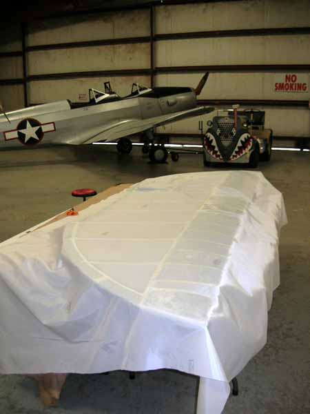

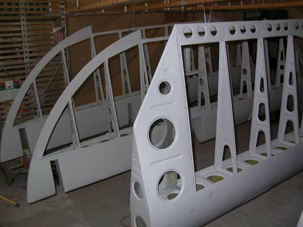

Just a quick up date on the B-24 rudders and elevators we have been working on. They have just been primed and we are starting to recover them. Here are a couple of images of the work in progress.
This is just the first step and I'll try and provide more images as we go along.
We don't have a cat in our hangar, at least not one we know about, but our trusty Flying Tiger tug stands guard in the background, next to our PT-19A.
Randy

Thanks for the update Randy! The Rudders and Elevators look good in primer...
I love the PT-19 8) and the Tiger Tug :lol:
