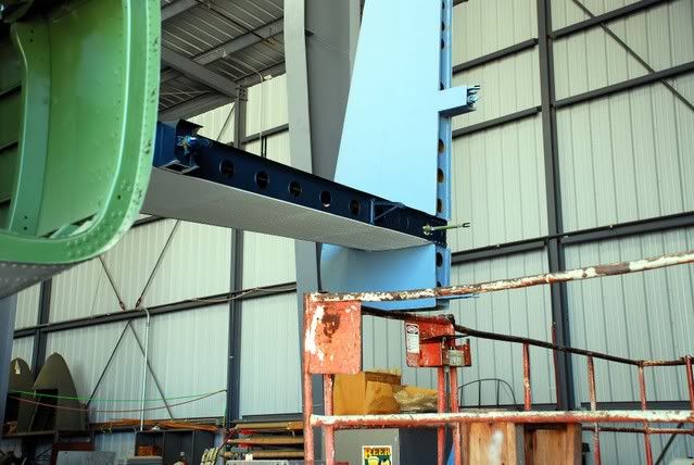

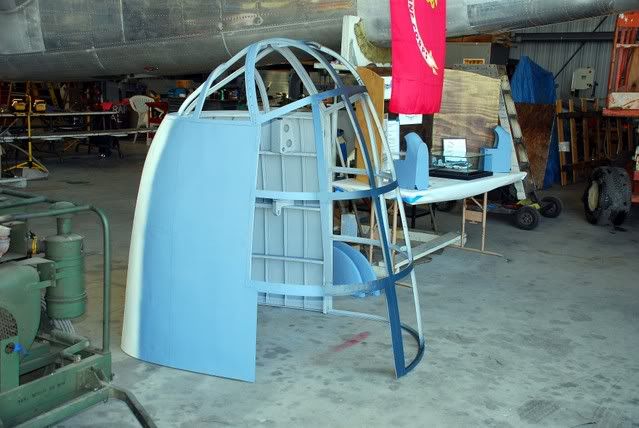

Dan Newcomb wrote:
The holes are stuffed with paper to keep the paint out. These areas are covered with plates that we paint separately and will install prior to the rudders and elevators. The holes are known as lightening holes. They make the structure lighter and allow for inspection and access. As we proceed I will continue to take photos and you will see how it all comes together. We will paint the control surfaces off the bird as we use a different paint on fabric.
D
I get it now-I think I actuall see a couple with their covers still on. It seems funny that they cut a hole to lighten it, then cover the hole up...Like you wouldn't loose very much weight in the process. Lighter materiel on the cover plates?

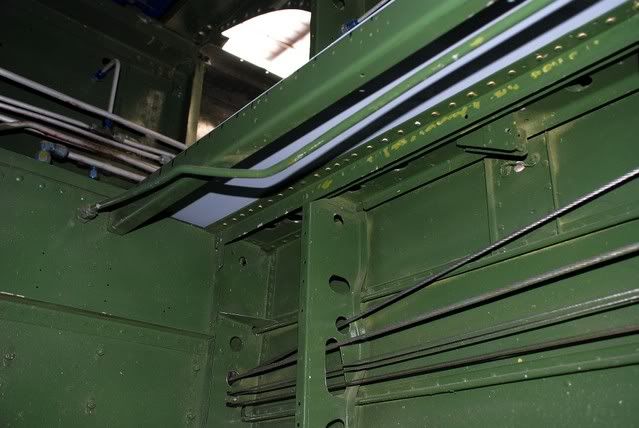

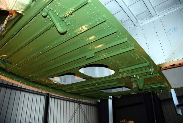

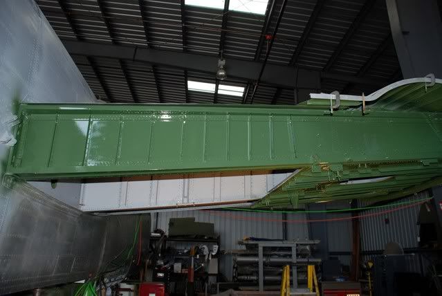

It is always an adventure driving down to CMA. It was 81 degrees when I left my house at 0530 and 59 degrees and IFR when I got to the hangar two hours later.
Scott beat me in and soon Ken and the cable guys showed up along with Dave and we also had a brief visit from Tim later in the day.

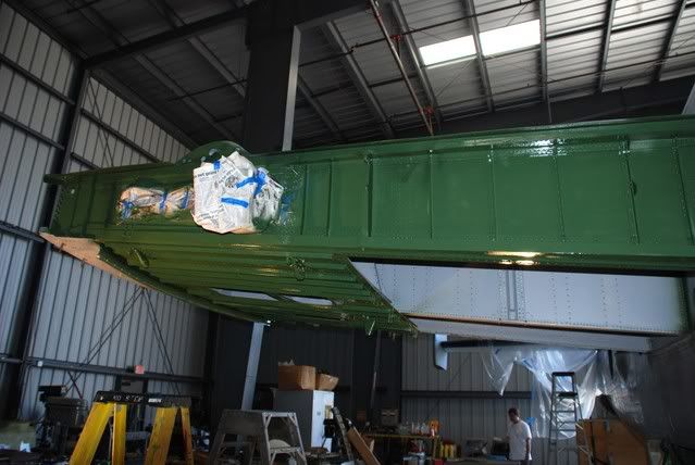

The clevis bolts arrived yesterday ($247 worth) so I think we have just about everything we need for the right main. Scott and I shot all of the rivets on the wing that we could with the exception of one area around the rear inboard tank where the up lock goes. Both halves of my brain (Marc and Jeff) weren’t in the hangar for consultation but I think there are some parts that have to be installed before we shoot the rivets. I don’t see why we can’t shoot the green paint under the wing ASAP but I am probably over looking something.
Scott and I shot up a shelf above the front crew hatch for Iran but I need to shoot a couple of more rivets that I missed to finish the job. Ken continued with his project forward and the cable guys cabled.
When I dropped down out of the pass into the “valley of h-e-l-l” it was 112 degrees! Thankfully, as I pulled into the garage at the house it had cooled to a pleasant 108! Beer never tasted better.

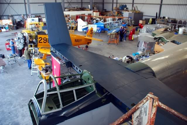

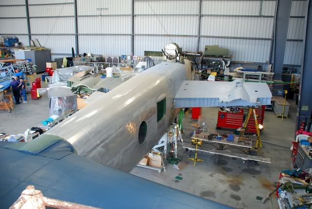

We all got together yesterday for a rare Monday workday. We will start to hang the right gear next. We will also continue with the priming and painting. We have got to keep the corrosion monster off of our backs!
THE REAL BRAINS OF THE OUTFIT
BRAIN"S DAD
PAINTED AND GOOD TO GO!
