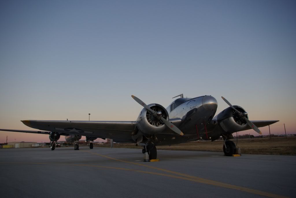

Hi Mark and welcome to WIX :!: It would appear that "Taylor Maid" has gained some nose art :?:
