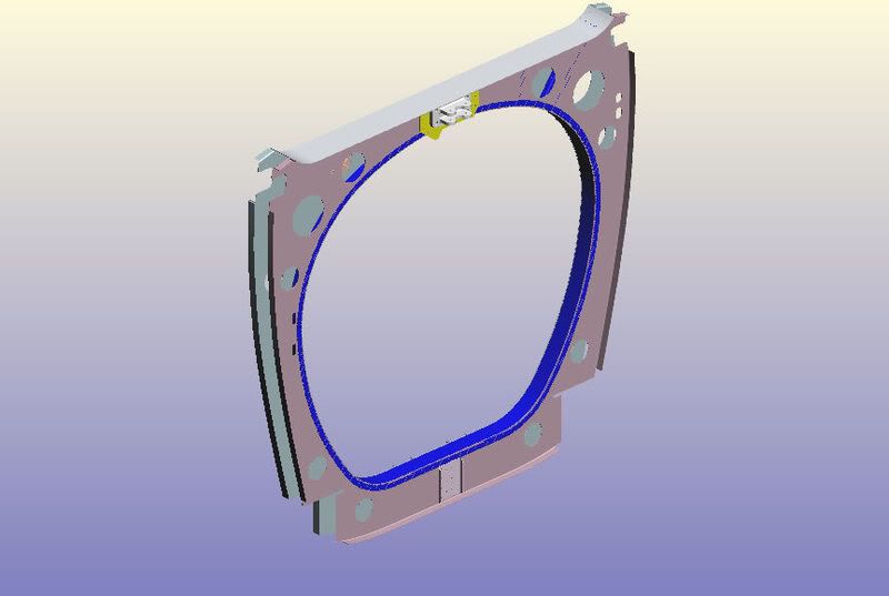

Hammerforming... click here and watch the first post...
http://spitfireprojecta58-27.blogspot.com/
Rolling...
and capping is the blue bit....
Any questions??

I,m missing some info in my old text books but is it possible to anneal T3 back to 0 for hammerforming?Some of our frames were cut in the wrong stuff and I don,t want to waste material.Some of the Spit frames do have tight curves around them.. :roll:

Yes Rossco,you can do a partial anneal or a full one,a partial uses a temp of around 340 deg c and then air cool the parts,after you finish forming resolutionise the work back to temper using 488-499 deg c and then age harden(96 hours).You can even re cook it to T4 or T6 if you like baking!!!Mil-h-6088 is the spec if you want accurate info on temperature & heating times,cheers,Pete
