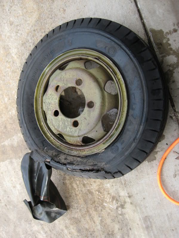

Oh, it's best if one doesn't try to air up a tire that has been sitting flat for twenty years, not to mention that the tire is over sixty years old:
:oops:

I had maybe 10 pounds in the thing when the sidewall gave way and the tube popped out. My original plan had been to inflate it just enough to expel any water that was still in the casing. It worked---all the rancid water ended up on me. :toimonster: The other tire is holding air just fine, so I'm batting .500. Holedigger is right about truck tires making a mess when they cut loose. We used to do lots of truck tire repairs/changes at a shop I worked at (1970s), and we didn't use a safety cage until a ring popped off and hit the ceiling fifteen feet above us. We built a cage and bolted it to the floor that afternoon.

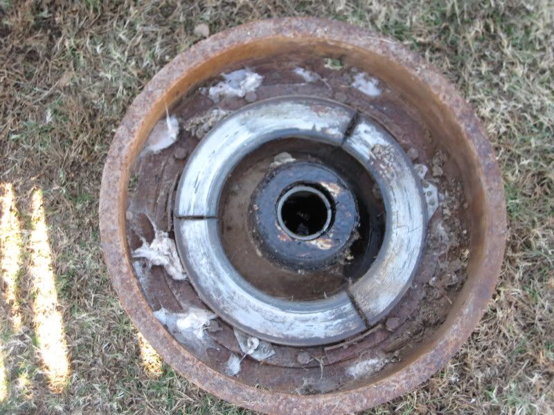

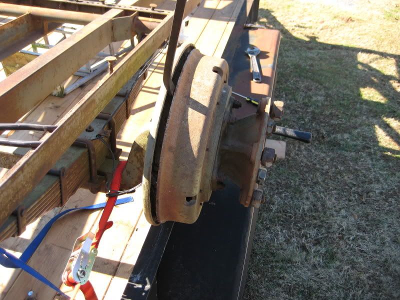

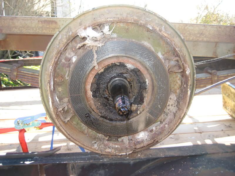

Well, I got one of the stinking brakes disassembled. I started by loosening up the drum from the shoes by using a rivet gun, brass drift, and finally a BFH. Then I pulled the outer wheel bearing out so the assembly could be tipped from side to side. Finally I was able to get a prybar between the backing plate and drum and work it off the shoes. Mud-daubers had made nests at each of the four vent/inspection holes in the drum and it was full of rust, dirt, and spiderwebs.
One down, one to go--then on to breaking down those truck wheels. :roll:
