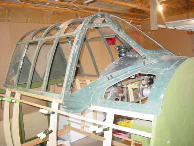

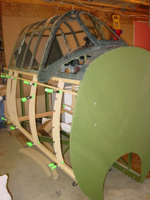

PostPosted: Mon Nov 05, 2007 1:04 am
And the madness continues...
Many, many thanks to Steve Dennis for hauling the "new" canopy section back to God's country for me.
This section actually fits further aft, but I just couldn't help pinning it up with the windscreen for a few pics.
The Sea Wolf will live again (or I'll go quite mad trying). :wink:

That looks very cool my friend, VERY cool....
A person has no idea how huge that thing is from the pictures. It is one big beast!
Steve :wink:

Mr. Dennis speaks the truth. Size-wise the TBY is comparable to the TBM. I'm 6'2" and was on a step ladder for the pics. The beast won't fit through the garage door with the glass on.

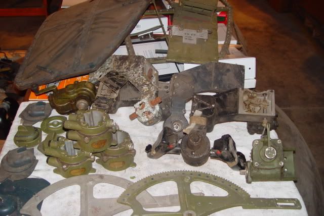

I sure wish I had some better images to work with. Hint Hint! If I could only see some clear photos of this beast's turret, I think I could find more parts. Are there any turret manuals for the TBY in existence? Here's a shot of some of the parts I've found so far. I'll post more soon. It's not much but it's a start.

You're killing me, Albert! You know full well that this stuff has dropped off the face of the earth. I'm convinced that what you're finding is all that anyone is ever going to find. Now I just have to figure out a way to afford all this stuff (and it ain't gonna' happen before 2008, as SWMBO is maxing out the VISA as we speak! :wink: ).
If I had more/better pics or documentation I would send it. As far as I can tell, Convair simply referred to this turret as the "Emerson Model 139". The microfilm I have of turret parts is all but invisible--at least the frames I recall peeking at. I can try another look, but probably won't get my hands on a projector to use until close to Christmas.

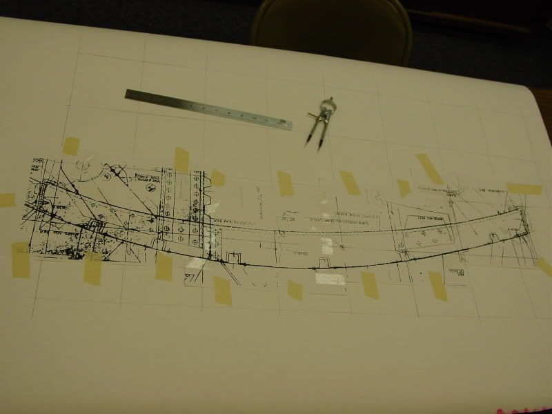

have you found any plans by which you can machine parts for this sucker?

Interestingly the National Archives owns microfilm of the TBY engineering drawings (or what's left of them), copies of which I purchased in 2005. As already intimated by Albert and others, the quality of microfilm images leaves a great deal to be desired. On the average roll, perhaps 50% of the images are clear enough to be usable, 30% appear as ghostly apparitions, and the remaining 20% are completely blank. Also, the originals were drawn in a multitude of scales, but microfilm converts everything into one image size. The pic shows an example of an average guy's attempt at enlarging a microfilm image back to original size ala cut-n-paste.

Hey Dan some food for thought.... You might want to consider setting up another computer with some 3D software like SolidWorks or Mechanical Desktop or the like and forget trying to piece together Xerox prints from the film. I'm finding that it's a whole lot easier and faster to redraw the prints on the computer and tons easier to fill in the gaps on the drawings.
By drawing full size and utilizing a lot of the automated tools within the software, it's pretty quick to pop out a good drawing. Also by building it in a 3D system, it is fairly easy to "assemble" the parts in the computer and from there make educated inferences and guesses about missing drawings and develope good prints for those items.
The software can be a bit pricey, but it's worth it at least to me. Also. manual film viewers are pretty cheap to buy and have sitting on your desk. Just remember that if you buy it on fleabay, they can be heavy, so much so, that shipping runs as much as the purchase cost.

Hi Craig. All excellent suggestions and ones that I've considered. If I were blessed with a bigger bankroll I probably would shoot for the software approach, but you know all about making choices right? Should I buy software or pay the kids' dentist bill? Should I buy a microfilm viewer or some more 2024 sheet? Heck, Vought-Sikorsky and Consolidated-Vultee weren't designing and building these things with CAD and CNC, so why should I! :wink:
