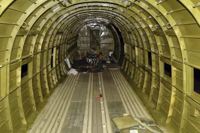

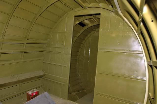

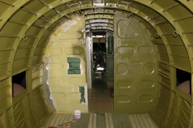

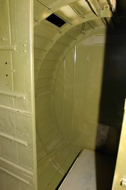

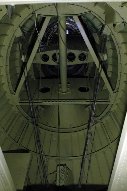

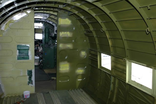

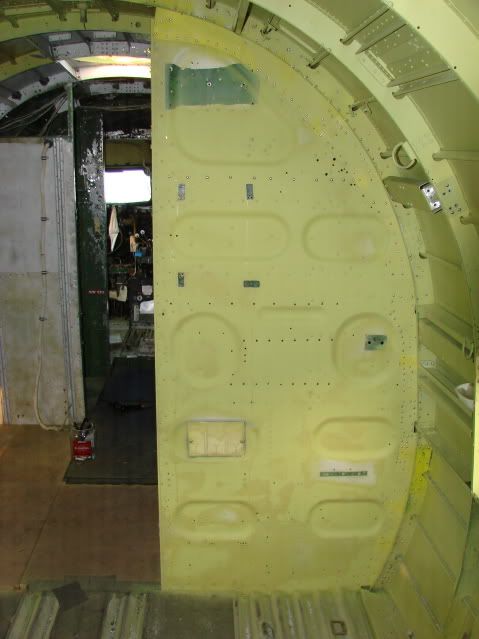

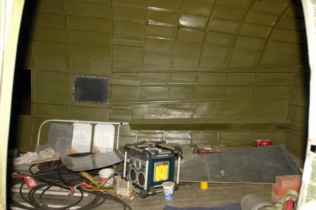

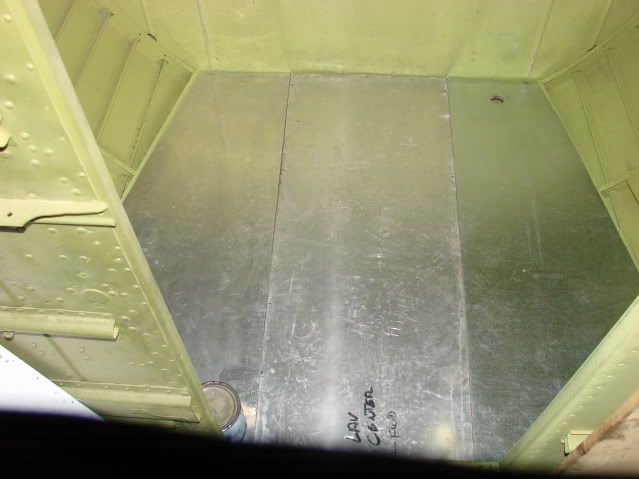

So the restoration is moving at full steam! Had a couple set backs this month and some things spring forward. The Radio/Nav. Room Walls, if you dont remember, were relocated sometime after the war forward shortening the Radio/Nav. Room. We have drilled them off the plane early in 2009 and plastic blasted them. We have been in a slow stage of recondioning the walls and actually adding the nearly 5 inches of sheet metal that was cut off to make them fit further forward in the flightdeck. I'm Proud to annouce that the RH wall is installed and the LH side is almost completed and put back in! This means that we can start painting the Green interior finally into the troop compartment all the way back to the tail compartment. The latrine was also stripped, and the tail compartment. They all have been primed and are ready for paint. It actually has started but I dont have photos to share yet. I do have the primed photos below to inspect.
The Floor in the Latrine have been completly remade and are getting the covering this week.
Other progress is the side exits doors are ready for paint shortly, then reinstallation, the troop seats, which I dont have a pcture of have been repainted already and are awaiting installation. The Bathroom Toilet, Urinal, Sink and Cabinet, troop seats, and troop seat backs will all be installed prior to 1 Jan.! Very Exciting stuff!

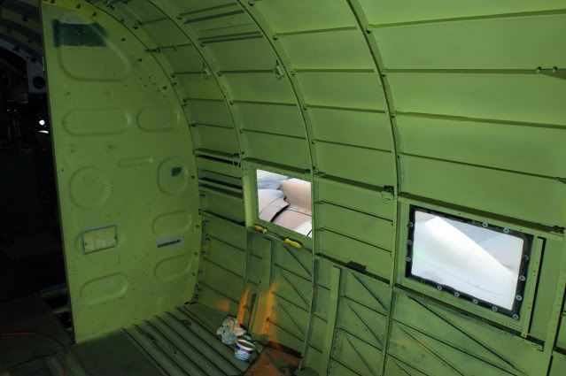

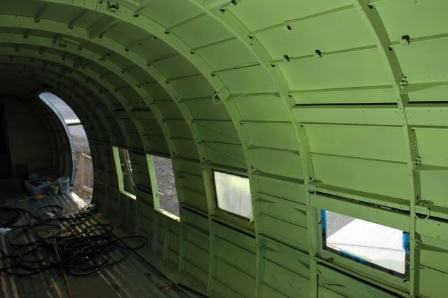

Painting Updates today!
With the string of good weather, and the fact that the sheet metal, and other repairs are complete in the fuselage and cargo compartments, I have started painting the interior. Paint has been color match to Douglas WWII C-47B color hue charts. PPG has graciously donated all the paint for the restoration!
These pictures are at the end of day 2. Yes I see the bare areas! :) Not done. The latrine still has some areas to finish, then a complete walk thru to get bare spots and apply a good second coat.
As you can see we are still working on the LH radio/nav room wall. Hopefully 1 more week and itll be done too!
