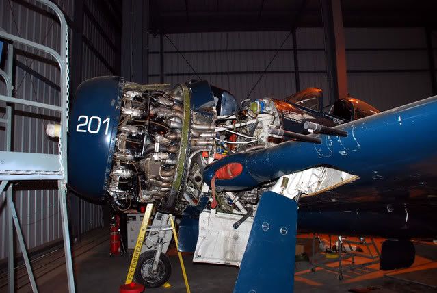

I will be heading down to CMA tomorrow to work on the PBJ after taking last week off. I will also check on the status of the aircraft that are going to Chino’s POF event. I believe the C-46, Hellcat, Bearcat and Zero will be going. I will be at Chino on Sunday the 20th and will take as many photos as my 2gig memory card can handle. All of the Bear’s exhaust stacks are being replaced with new ones and hopefully she will be ready in time. I will update in a couple of days.

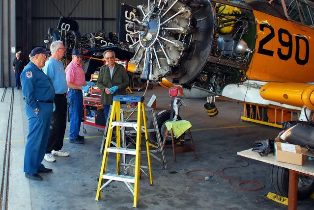

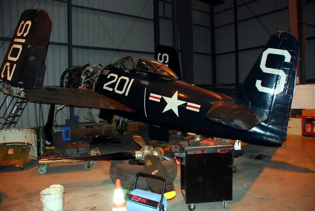

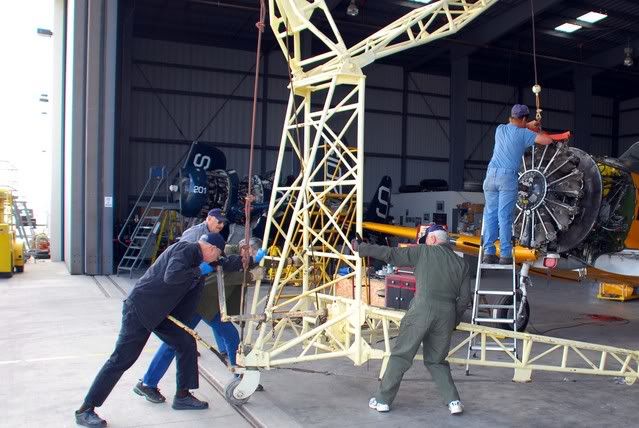

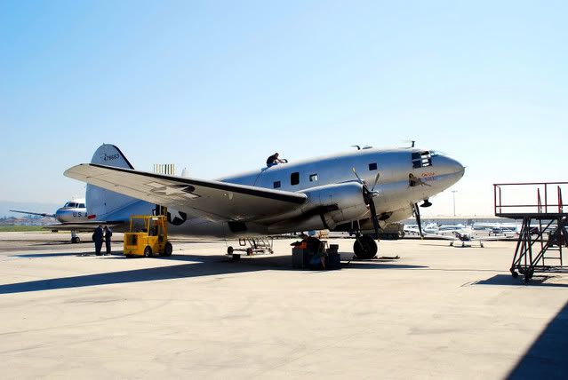

Thanks for asking Alan. Not much to report on the PBJ as we hit a few stumbling blocks. We are trying to replace a stringer in the nose section that supports the flooring next to the crew hatch. It isn’t a standard angle that can be purchased and our first attempt at bending it failed. We succeeded the second time around and sent it out to get hardened. We continued shooting rivets on the right wing and the cable guys are working their magic on the control runs. Not much to see on the PBJ so the photos I am attaching deal with other planes. The C-46, Hellcat and Zero will all make it to Chino next week for the POF show. The Bearcat is a couple of weeks away from flying as work on the oil coolers and the replacement of the exhaust stacks continues. Our SNJ 290 is getting a new engine after the crew discovered the splines on the propeller hub are shot. With all of the work we all have to share the load. This time of the year we have got to “keep them flying” as they say. Several of us are going to Chino next Sunday and the Nikon will be with me.
I've heard that chroming of the splines can be done on the crank to repair that in some instances. If you need another crank call Dennis at Sun-Air Parts (http://www.sunairparts.com/). I happen to know that he has a core right now... :wink:

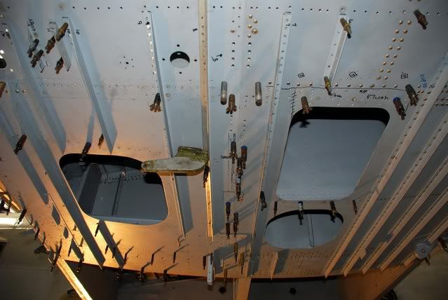

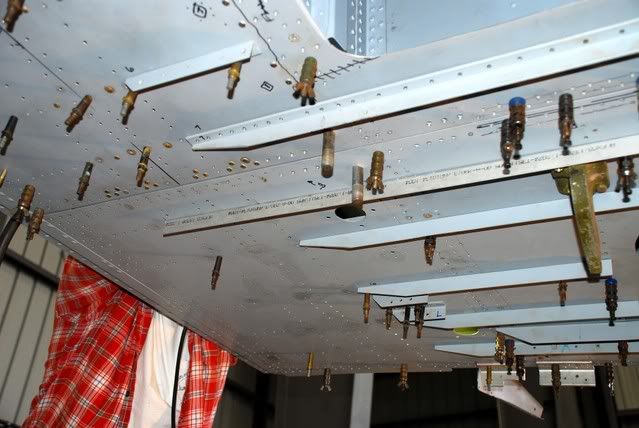

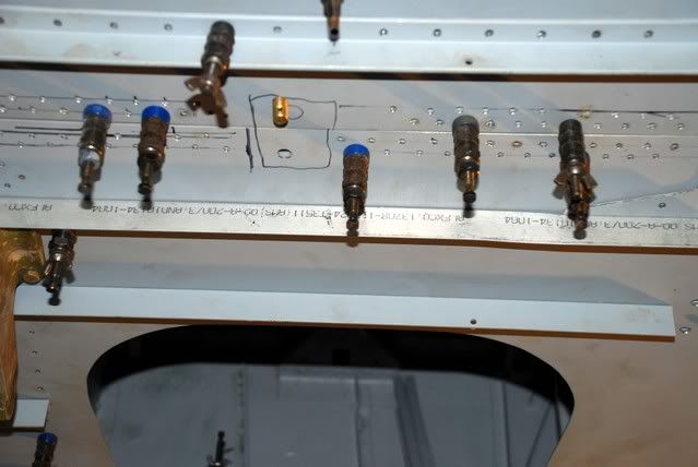

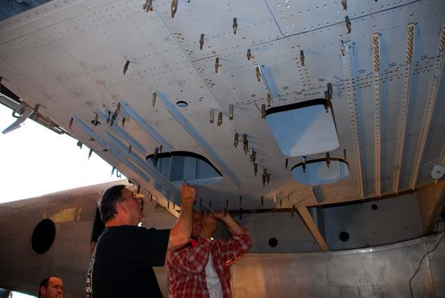

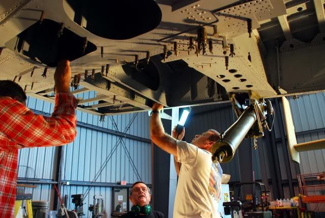

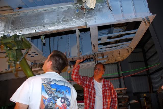

We had a good day yesterday! We were finally able to put the rear lower panel in place on the right wing. We put the front panel up April 17th and it took a month to shoot up so I expect about a month to finish the rear panel. Soon we will be in a position to hang the right gear. What a day that will be as we have been on jacks for over two years. As some of you know this area of the wing was so totally trashed with corrosion and about all we were able to save was the upper skins and thank God the spars and castings. About 80% of what you are looking at is brand new.
The boys get ready to install the aft skin.
Up she goes
Now if we can figure out how to remove Ken's head from the bay..
