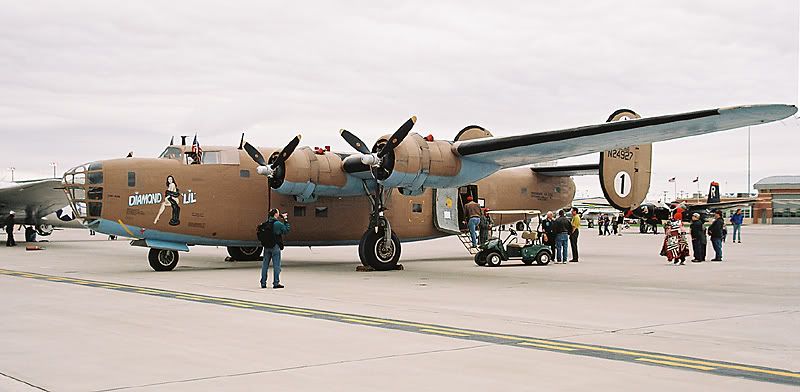

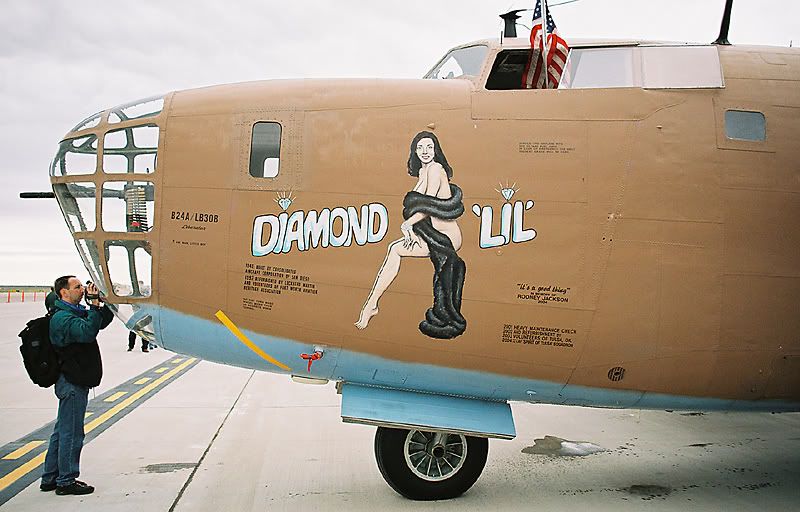

Was looking at my photo CDs and came across my Airsho 2004 photos, guess this photo I took in 2004 will be my last time seeing the Lil, cannot wait to see all Garys work and HOPEFULLY you guys can come to Houston this year so I can see her twice, since I am planning to come to Midland this year.
