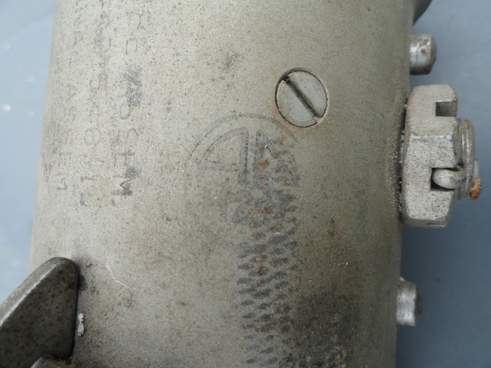

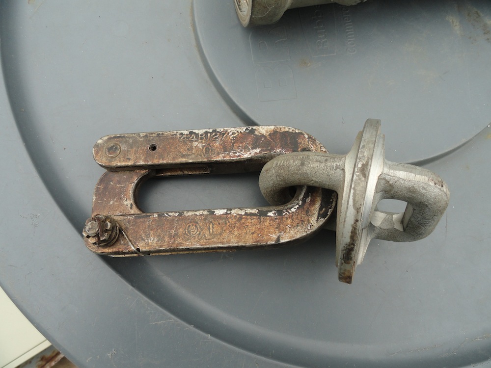

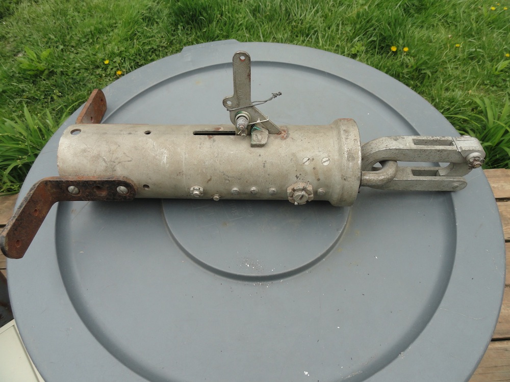

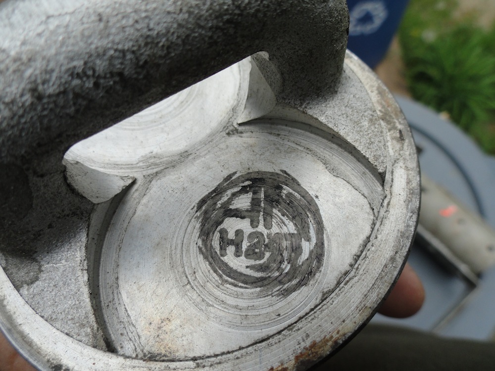

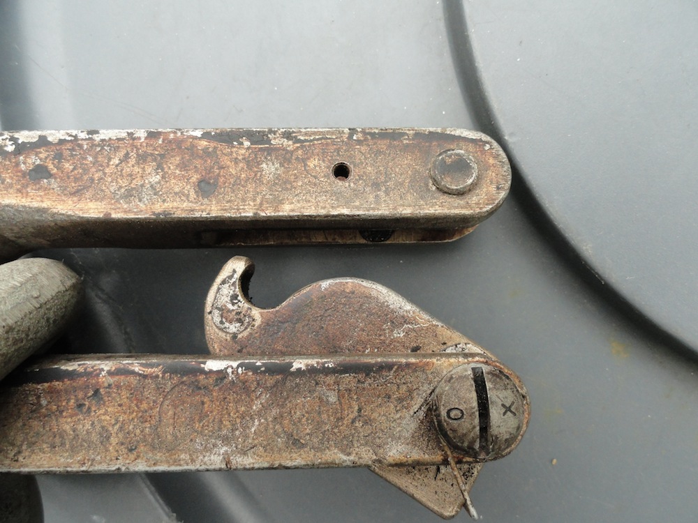

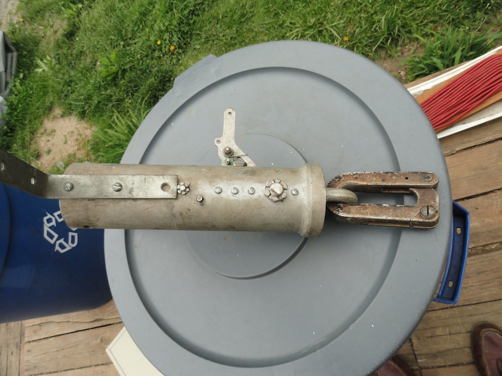

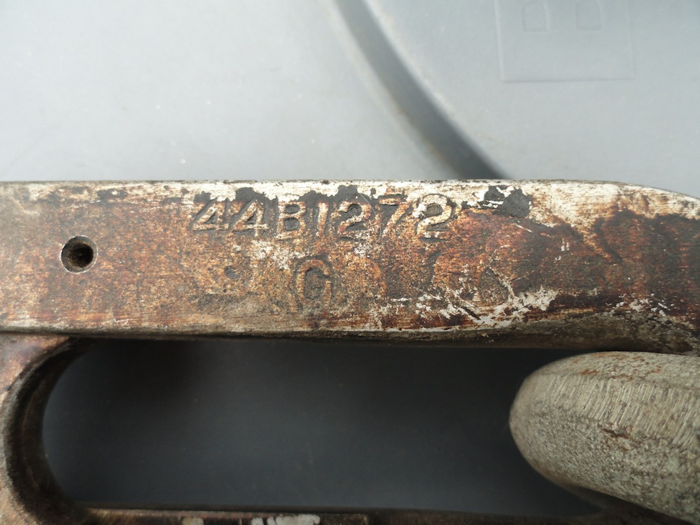

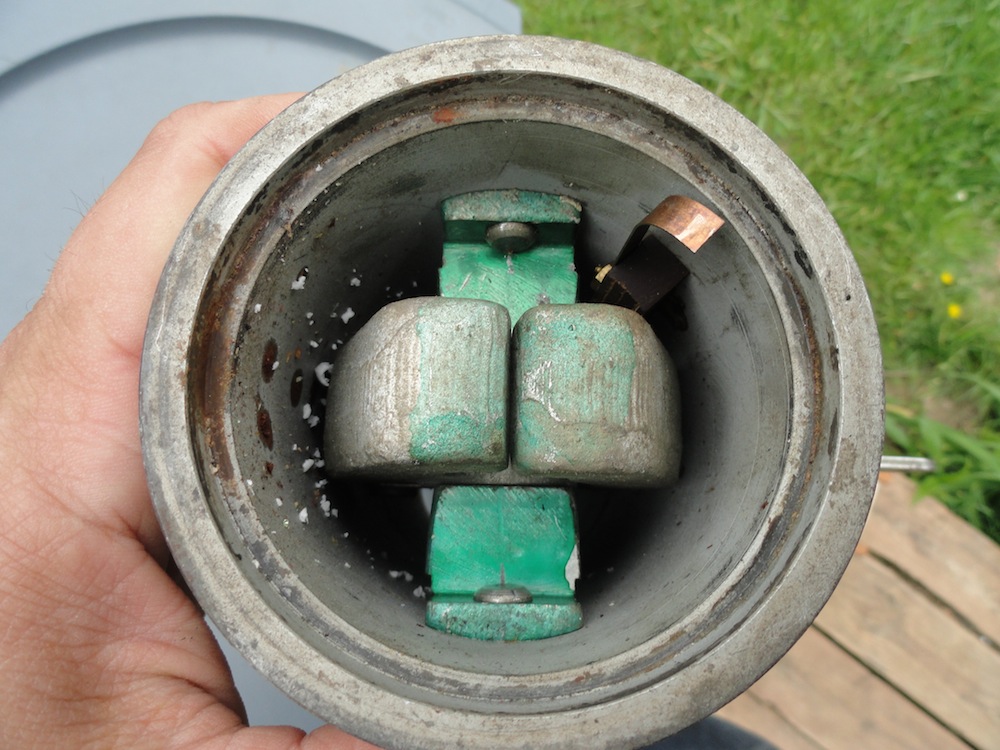

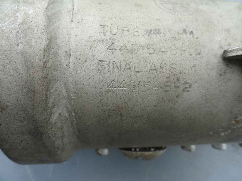

Here is what I picked up. I found two of these. I know what they are, but want to see the other equipment they attach to. Both of them are NOS. The assembly numbers are pretty clear in the photos. I also have the glider brake chute releases. I had a chance to buy C-82 Glider snatch winch gear but passed on it.
REMEMBER THE SERGEANT PILOTS!

The Handley Page Halifax in the National Air Force Museum of Canada at Trenton, Ontario, has the tow release installed but it was used to tow the Hamilcar glider and is significantly more substantial than the one illustrated.
