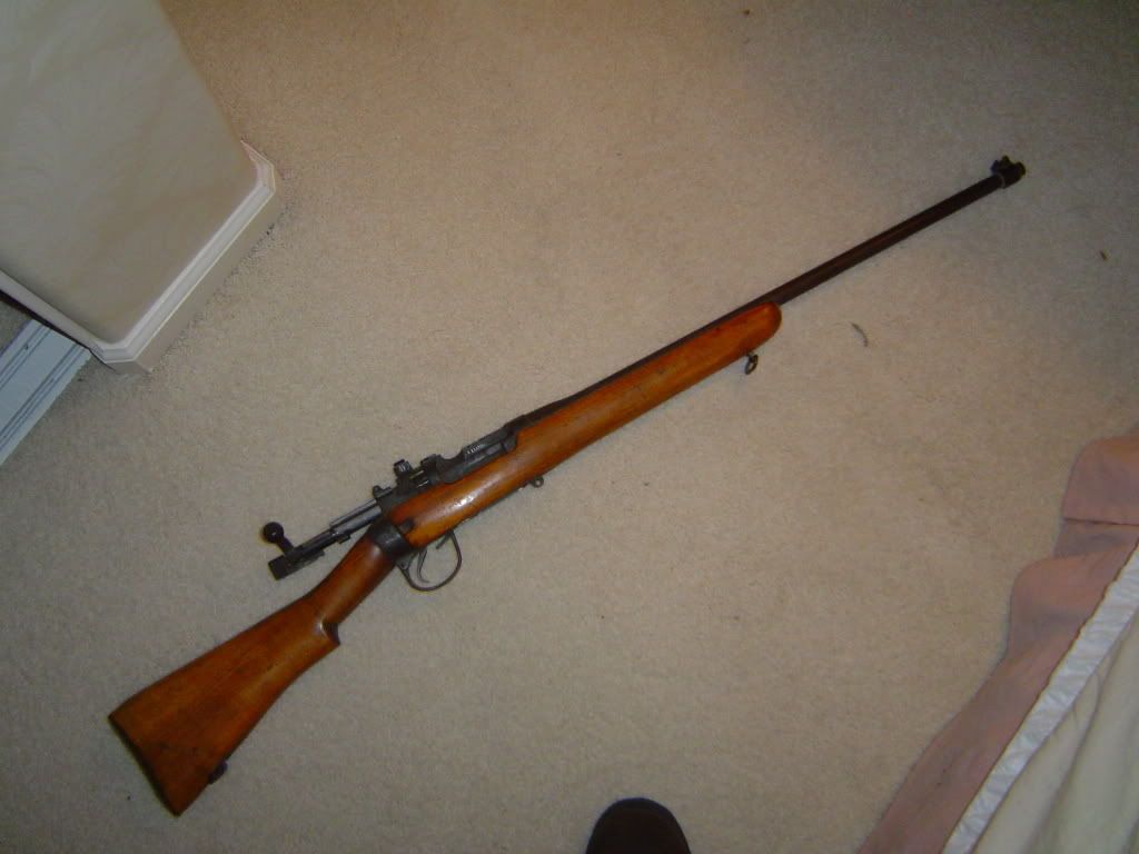

My dad showed me this rifle he wants to give to me. He got it from his dad. Neither of us knows what it is, or exactly where it came from. It appears to be military in origin. Who can ID it for me?

I'm no expert but it looks like some sort of Lee Enfield rifle. Do you have the magazine for it?

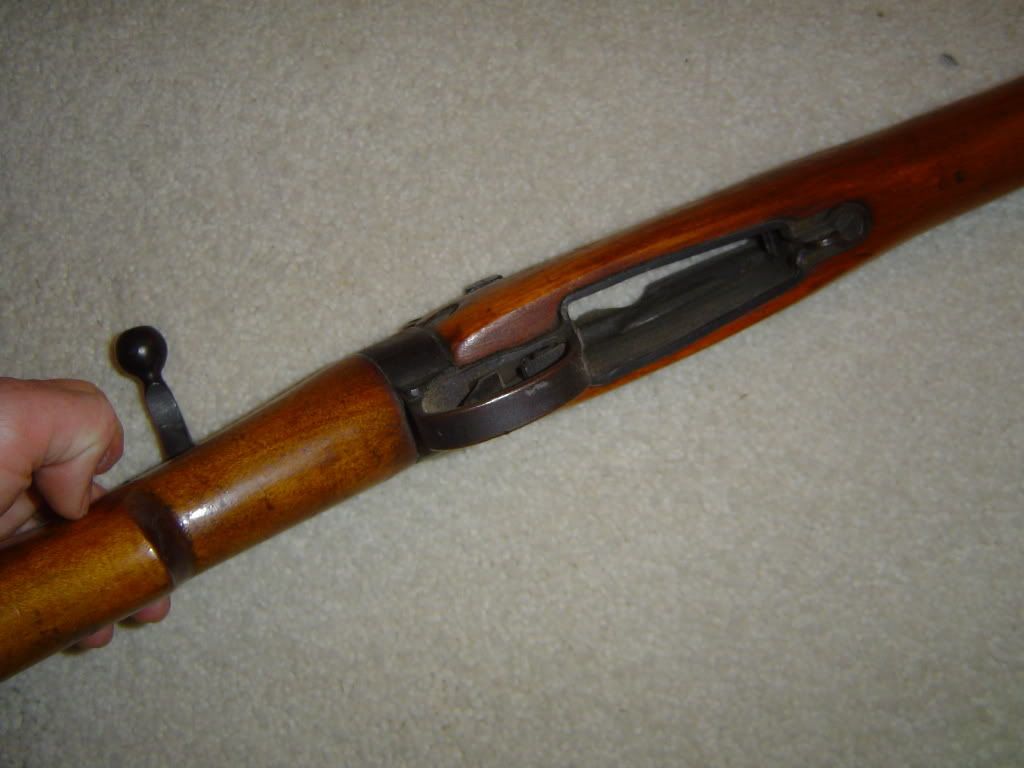

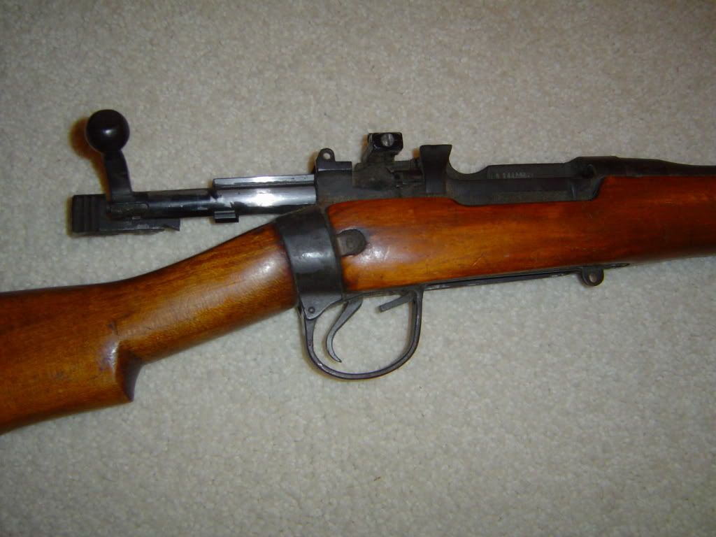

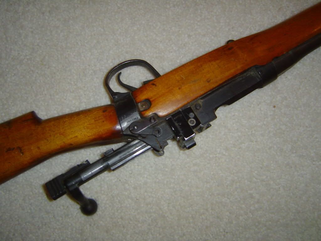

"Sporterized" Short Magazine Lee-Enfield (SMLE) No.4 Mk. I*, standard longarm of the British Empire in WWII.
Should be .303 caliber. The magazine(10 rd.) is missing, the stock has been cut back to lighten it, by about 60%45. The forestock is shortened, and the upper handguard is missing.The flip sight has been replaced by an aftermkt. peep sight. You also appear to be missing the front sight blade and foresight protector. Also your original forward sling swivel has been replaced, as the band it goes on is not there.
It was probably armory remanufactured in the 1950's, as it is showing the No.4 Mk I/2, type Mk2 cocking piece, but has the early original style bolt lock.
The serial number appears on the left side, on the band around the rear of the bolt. I can't read it. PM it to me or post it here, and I can tell you where made, etc...
ID'd enough for you?

I knew someone out there would get it. Dang Robbie, you are good. I thought it might be an Enfield of some sort, but it didn't look like any I had ever seen. I posted that right before I left for the airport to fly from San Jose to Seattle. My girlfriend and I, stopped for dinner and I just got home.
A quick call to dad gave me the serial number of FA27555. My dad didn't believe me when I said I'd have an answer by the end of the day.

Curtis- As suspected, your SMLE started life as a standard No.4 Mk I, and was later armory reconditioned to a No. 4 Mk I* or /2... The Serial number indicates it was manufactured by Fazackerly (indicated by the "2" at the beginning of the number) in Lancashire, England. I have one also made there.
If you look close, on the left side of the receiver below the sight(may be covered by your bolted on sight) you should be able to discern the date of manufacture, unless it was intentionally and fully removed during overhaul.(Mine is mostly removed, but the date can still be made out- 3/44)
