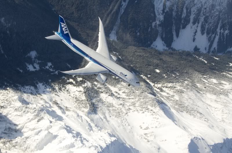

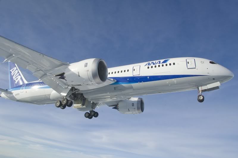

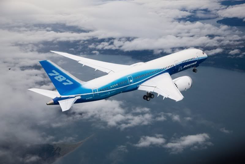

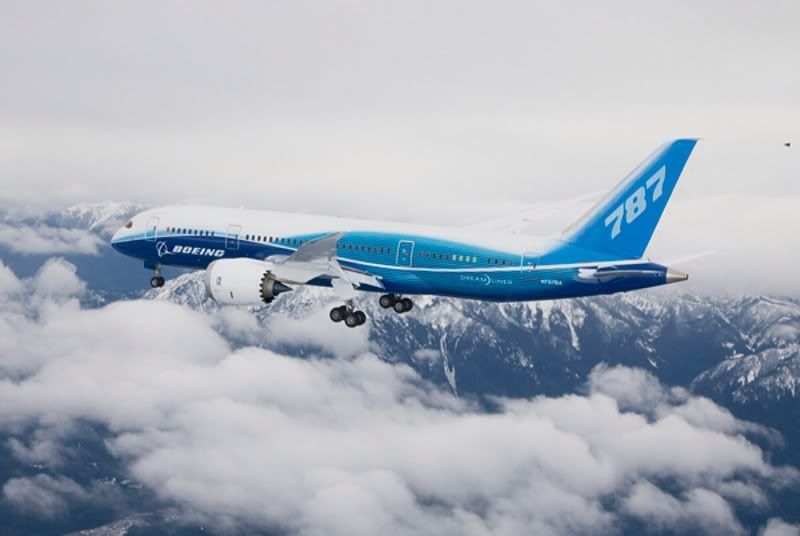

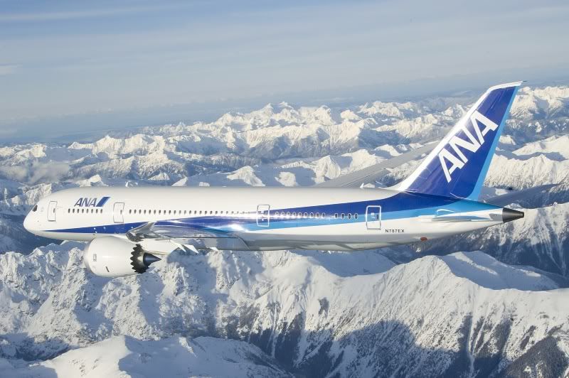

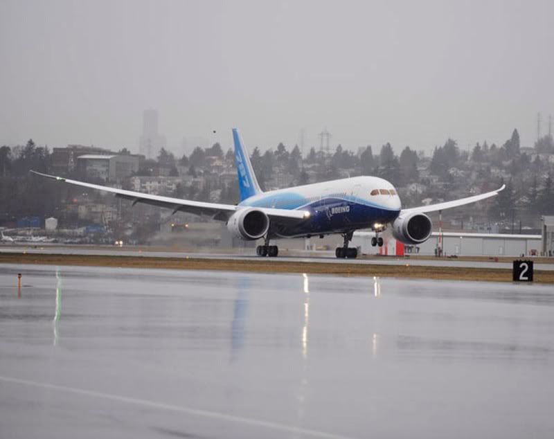

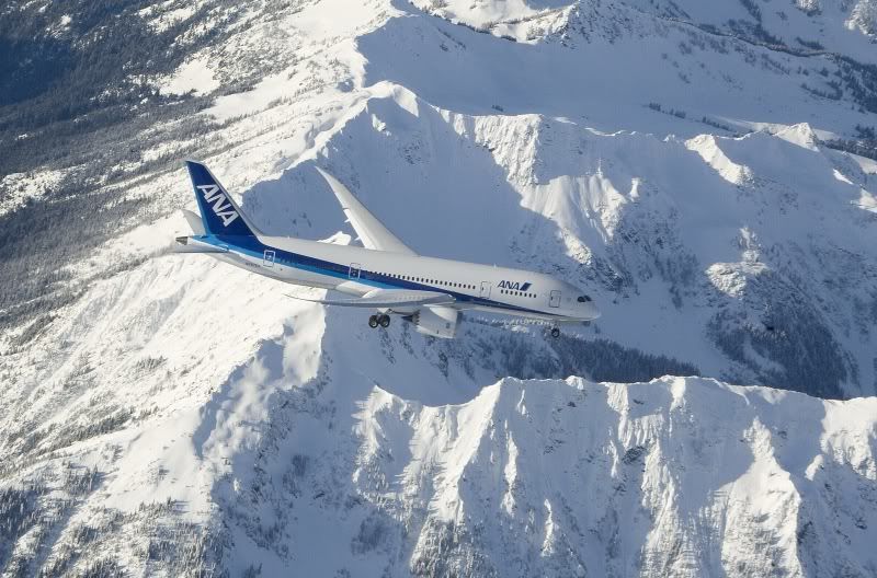

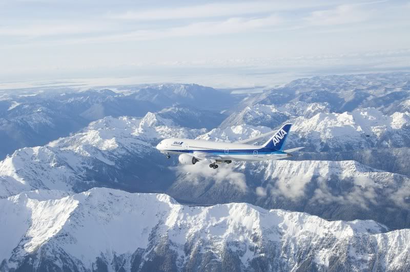

That's pretty.
Ryan
PostPosted: Fri Jan 08, 2010 1:18 am
That's about a close second to a Connie!

OH BOY!!!! STALL TESTS!!! I loved doing deep stalls in big airplanes when @ BADWRENCH! MD-80's were like big 182's and 767-300's really moved the old horizon around-
Ain't she pretty?

So what happened to 'winglets'? As on the 737-800's? Or are these the new and improved 'winglet lite' on the 787?
Also, I remember the initial design had a vertical tail like a dolphin.., does anyone know why that did not work out?
Thanks!
S.
PostPosted: Fri Jan 08, 2010 1:04 pm
Posts: 877
Thanks!
It has winglets there are flatter than traditional ones. Boeing started the flattened winglets on the 777. Now the 747-8 will have the flattened ones as well. The 787-9 will have the more traditional wiglets. The initial artist rendition of the 87 was probably meant to confuse the competition?

Well, hats off to you guys in Seattle for getting it flying.
Personally I think it is no prettier than any of the other stovepipes that I eat stale pretzels in every month, but it has been a long time since commercial aviation was any kind of a beauty contest. I look forward to seeing those flappy wings go up and down beside me in future years.
