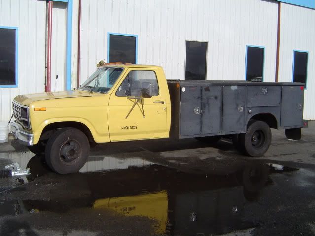

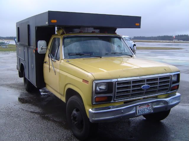

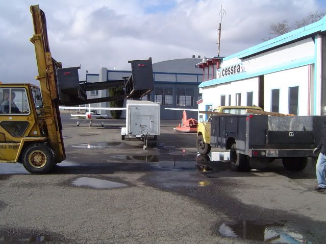

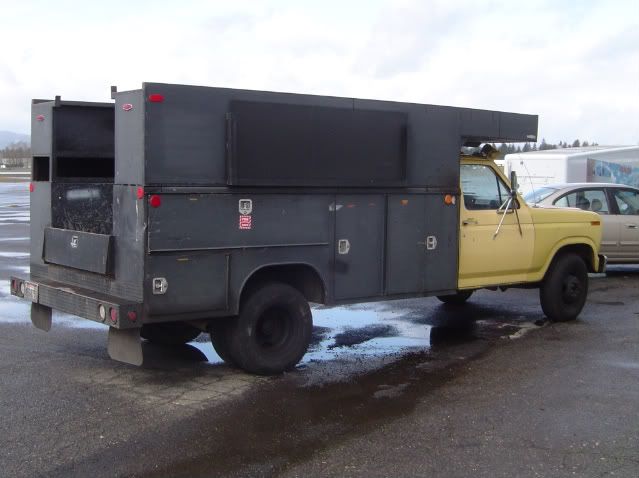

Well here's the truck.
We just got it today. Looks like a fuel truck already, right. :?
:shock: Ok, use some imagination. :lol:
I spent most of the day getting ready to remove the top rack.
Not as easy as I thought it might be.
Finally after some fancy work with the largest fork lift I could find on the airport, and a few close calls. We got it.
If you want the rack, make an offer (you haul). :D
The side lockers will stay for fire extinguishers, sump buckets, spill kit .... and the tank should fit nicely in the middle.
Next, prep for paint.
