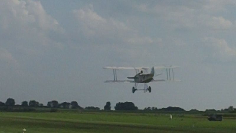

On June 23, our Airdrome Aeroplanes Sopwith Tabloid made its first flight.
This is a two seat (side by side) replica of the aircraft that made Sopwith famous. Our plane is painted to represent a RNAS SS3 variant from 1915.
Harvey Cleveland graciously did the honors.
We plan to use this aircraft as a transition aircraft for folks moving into other WWI style replicas.

Power? performance numbers i.e. cruise speed, take off / landing distance, handling? it looks beautiful! I love the craftmanship that goes into an early design reproduction :D

It is powered by a Valley Engineering 2332cc VW engine with a 2.47:1 reduction drive swinging a 90" X 66" Culver propeller (the original was 92"). It weighs 791 pounds empty and should have a gross weight around 1320 pounds.
Wingspan is 26'. Two seats, side by side.
We don't want to make any difinitive claims on speed other than it should perform similar to the original. The Video of the first flight gives you a good idea of takeoff performance.

It is! It is light on the controls... but not too light. It is very responsive and jumps off the ground when you add power.
