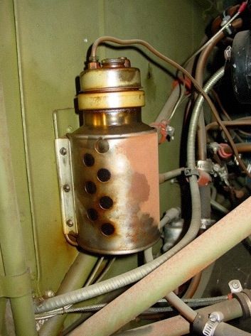

Hi. I am new to the site and look forward to learning lots from you guys!! I have a '29 Brunner Winkle Bird, Model B that I am currently restoring. As with may restorers, when I see another Bird I try to photograph it for informational purposes. My Bird is currently in lots of pieces and this has helped on more than one occasion! I took pictures of a Bird in California and upon returning home and sorting through them I cam upon one that puzzles me. Located on the forward right side of the firewall is a glass container with a thin copper tube out of the top. Does anyone know what this might be? The California Bird has a 100hp Kinner installed.

jim
we rebuilt our BK about 40 years ago. we still have it and i fly it regularly. i have all the drawings for all the models.. send me a pictures and i'll see what i can come up with for you... wrightj@canby.com... i have about 1700 hours of Bird time and climbing.. we did an STC for the eng mount as well as the eng and are using a B5 Kinner (125)... we shock mounted the front so the eng won't shake the acft to death.. have all the drawing for that also..

This part?
My bird doesn't have one, nor does the CK I am pretty familiar with. I showed the picture around the hangar today and the best guess was some kind of electric fuel pump?

Espresso maker?
Seriously, that's an interesting device. Maybe an oiler? There is a Wright powered Bird in the hangar across from my Stearman and an OX-5 Bird in the museum. I can have a look on Saturday.

astixjr wrote:
Espresso maker?
Espresso Maker? I want one for my Bird.
I realize that this info was in Jim's email to me: This part is on a Bird BK...Kinner K5 engine.
I hand't thought of an oiler of some kind.

A deairiator that works on siphon like your cars overflow tank perhaps?

I heard from Jeff who thought it looked like a battery vent bottle to hold baking powder to neutralize acid prior to venting overboard - saving any damage to metal/fabric/paint. However....... I do like the idea of the espresso machine!!

I think this is a static atmosphere for one of the early Pioneer vertical speed indicators. I have seen converted Thermos brand bottles similar to this used on Fleets including one that I bought from a poster on this site for a Fleet 1 that is based on my home airport. The one thing that makes me question this idea is that they are not generally mounted forward of the firewall.

eric
you may be correct... i haven't seen one of those for years

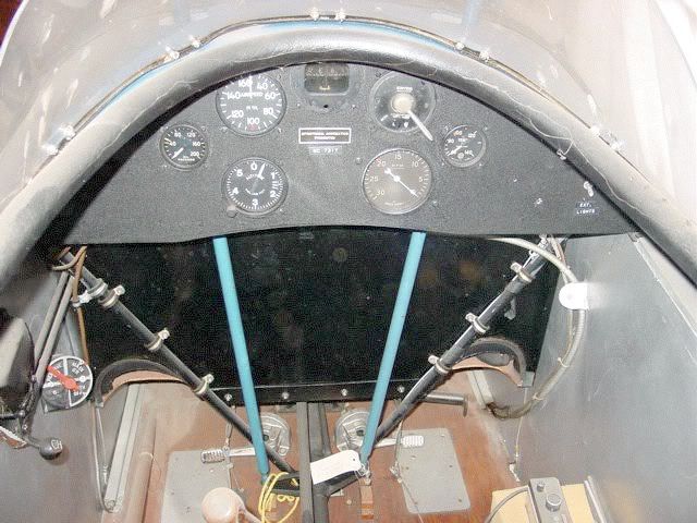

Thanks for all the good information. I have contacted the folks who own the Bird with the mystery part but as of yet, have not had a reply. I am going to try to attach a photo of the instrument panel - mostly to see if I have figured out how to post pictures. It doesn't appear to have a VSI but, as we all know, that doesn't mean that what may have been associated with prior instruments was necessarily removed......
Thanks again for your help!!
Jim

I showed the photo to John Cournoyer and he said it was indeed a pressure tank for one of the early instruments. I can't remember if he said VSI or Altimeter. I was wrong. It's not an espresso machine.

Mystery solved. But....... I was looking forward to espresso!!
