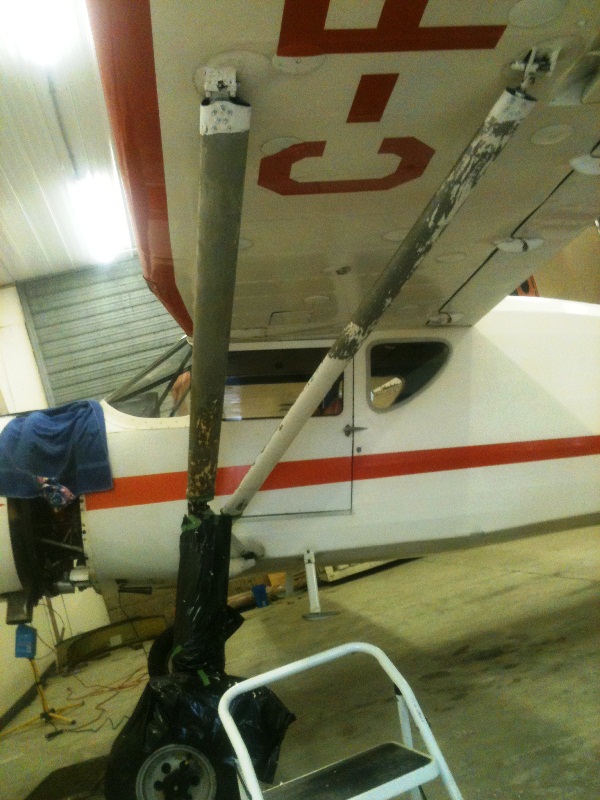

I was particularly pleased to see EKC in the sunlight because I'd been stripping and painting. The port struts were losing paint, chipped and peeling with too many touch-up jobs. So I got busy, bought a new respirator, and did this,
And this,
Then I used a recommended primer, a 2-part epoxy from Randolph. What horrible stuff... Why, oh why, are so many modern coatings designed to become tacky in :30 seconds? It was impossible to keep a wet edge. Sure, I know, everybody else always sprays, and doesn't use a brush. But with good prep, and a good brush, and good paint, it is very possible with the right technique to get a very fine result, even on metal. Anyway, you can't see much of it in the photo, but there are brush marks and "overlaps" galore here...
So 2 days later I attacked it again, wet-sanding until my arms ached. It worked, but with a better primer it wouldn't have been necessary. And then I used a topcoat which was the absolute opposite, a lovely polyurethane from the marine world, called Topsides by Interlux. That stuff is gorgeous to work with. I added 10% 333 Brushing liquid to slow down its rate of cure, and the result was exactly what I wanted. As it drys it levels miraculously, and tightens, and all the hills and valleys level out. Very little tendency to drip or run.
You can't see it well in the cellphone image, but it dried glassy smooth with no stroke-marks. (A very good brush, and applying from bare-to-painted, tipping carefully at the end and then not going back.) A couple of guys who viewed it after just naturally assumed it was sprayed. After my frustration with the primer, I was tremendously pleased.

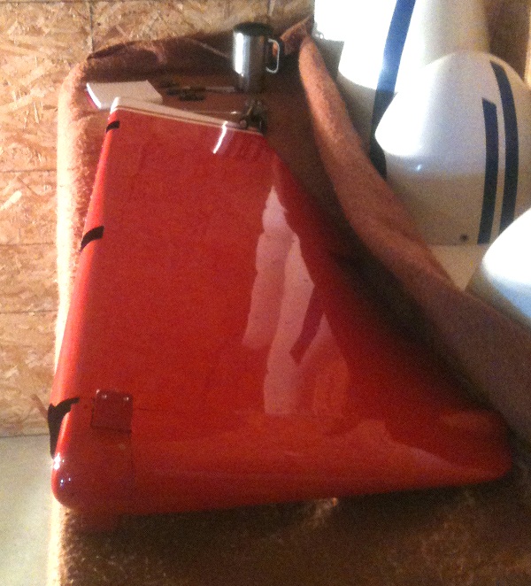

Then loaded up my toolbox and supplies and some other parts I'd been working on, and flew to Edenvale to work on Robin's airplane. (!!!)
She had found a replacement RV6 rudder. Ours had hangar-rash from before we bought it, a crease on the lower edge. [pre-purchase photo]
Robin found a fin and rudder from an RV6 that unfortunately had had an accident, but since all the damage was at the front end, these tail parts were untouched. A careful inspection showed no stress marks, no cracks or breaks in the paint. The previous owner was quite glad to see it flying again, so he charged her almost nothing.
So, off with the old!
