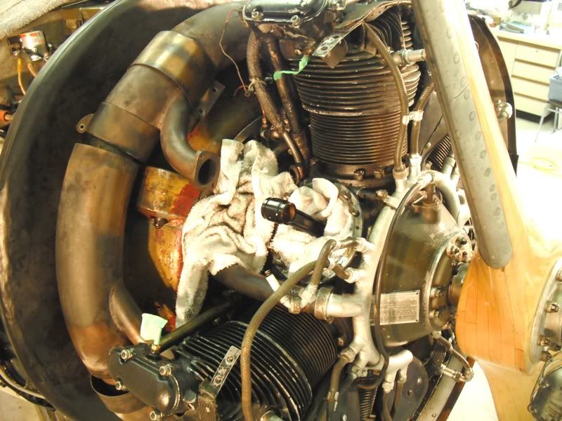

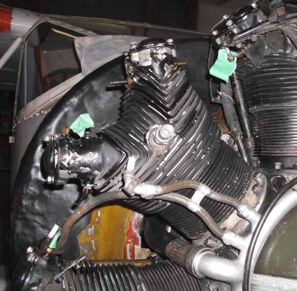

Then Stan arrived at the hangar with a handful of cylinder wrenches, and we commenced further Warner engine disassembly.
With a bit of finagling, we got #2 cylinder off. (The exhaust uses an interior "intensifier tube" to get hot air for carb heat. It makes the exhaust pipes very hard to remove.)
And there it was on the bench!
But wait, what's this? Is that push-rod-tube actually crimped?
PostPosted: Tue Jan 10, 2012 11:03 am
Posts: 1672
Oh fer Pete's sake... look at that.
This engine has been leaking oil since we bought it, and the bottom of #2 cylinder has always been wetter than the rest. That crimped end must have happened during the last time the cylinder was installed. Then the rubber sleeve which fits over top of it, and over the nipple on the crankcase, didn't quite cover the crimp completely, and thus the thing leaked. I wonder how much came out? Maybe a cup an hour? That's messy! And also expensive at $8 a quart, for several hundred hours.
Anyway, it's an easy fix. We'll make that crimped end nice and round again, and also use a longer sleeve (just ordered from Aircraft Spruce).

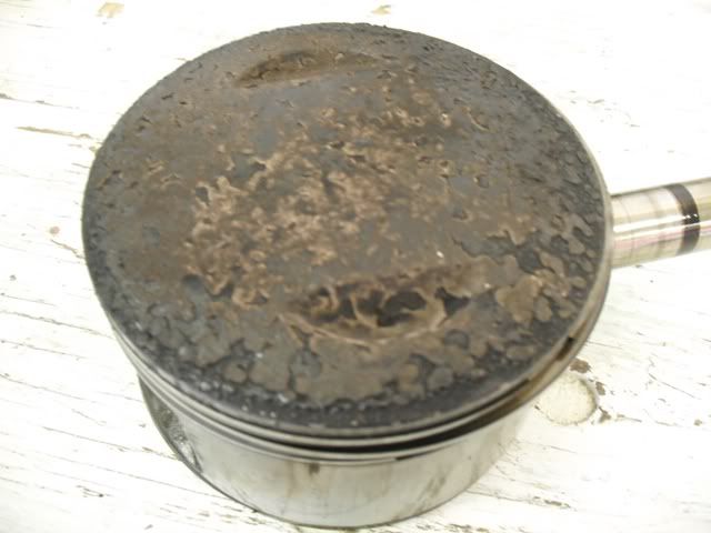

Stan came while I was flying and got the cylinder on.
New piston, rings and exhaust valve. I'm sure glad I spent the extra money and bought the Spitfire Guy's collection of parts. And we were fortunate to find an "old guy" engine rebuilder who in his personal tool stash had a rig that would re-grind a fresh surface onto the exhaust valve seat -- apparently it's not a simple set-up in the Warner.
The new piston does not look like this anymore...

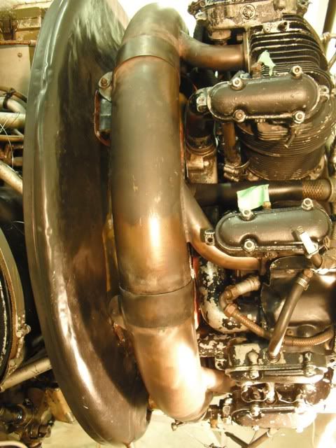

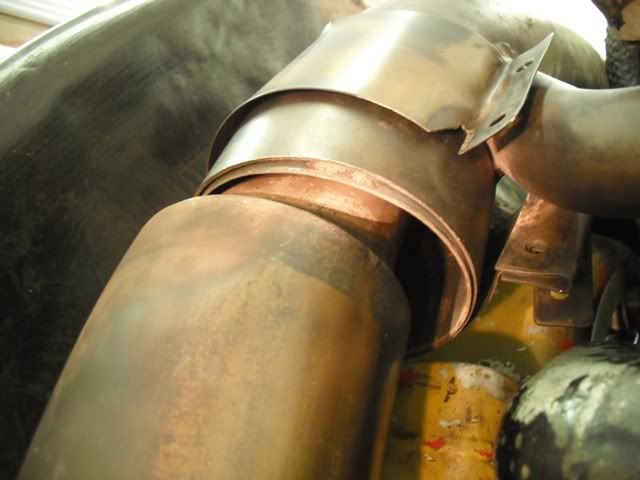

So Stan had me re-install the exhaust manifold. That's an awkward bloody assembly of parts. I needed 5 hands to line everything up. Each section is individual, and inside there's an intensifier tube threading it's way down to the carb air intake.
PostPosted: Sat Feb 04, 2012 11:57 pm
Posts: 1672
Eventually, with enough fiddling and enough skin removed from various knuckles, it all lined up and the joining collars fitted into place.

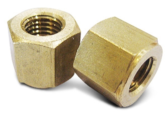

Then I spent most of a day running around town trying to buy some brass exhaust nuts, and a few other simple bolts and bits of hardware. Total waste of time. All I could find was car-grade stuff made of zinc-plated steel that I won't bring near the airplane. "Coned" lock nuts? Where did they come from?
The exhaust studs on a Warner are 1/4" fine thread, and if a ferrous nut corrodes onto it, and siezes, then later if you try to get it off, you end up turning the stud out of the head -- bad idea, considering the labour involved if a cylinder has to come off to put a helicoil in for a larger thread. About half the studs on this engine have had that done over the decades...
Anyway, I'll order some brass exhaust nuts. No big deal. But it would be nice if a town the size of Barrie had something beyond what you would use to build a chipboard house. (Rant now complete.)

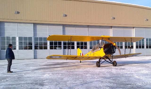

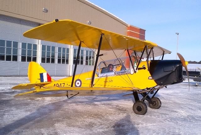

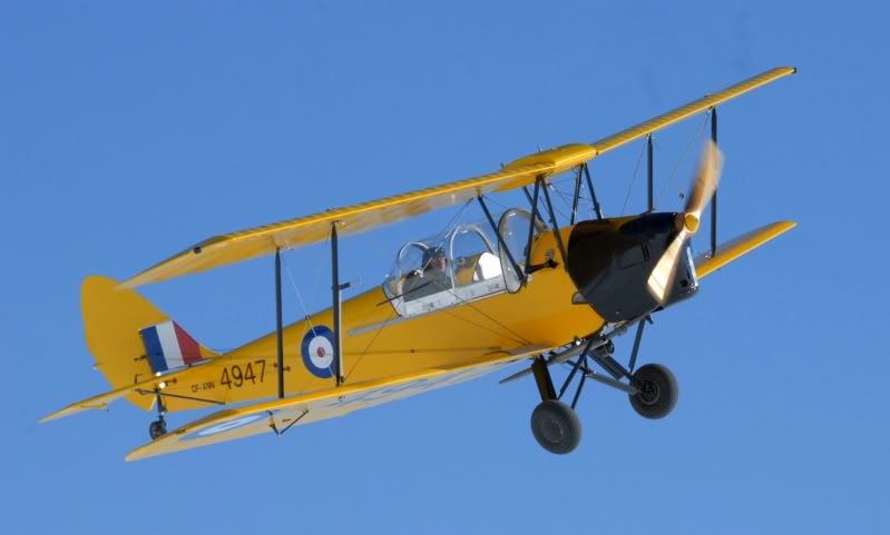

Then got to Gatineau for a test-flight in the Tiger Moth. It's now finished it's re-assembly and since we have a gig for it coming up, it needed to be flown.
There were a few tweaks to be done, so while low-ceilings and poor vis kept us in the hangar, we sorted these out. Then went flying on a glorious sunny winter morning. I have no photos of that yet, but here's one from same time last year -- the day was just like this!
After a short flight I determined there were some rigging changes to be made, so back it went into the hangar, but I understand it did indeed fly at the ski-plane rendezvous at Montebello. Success!

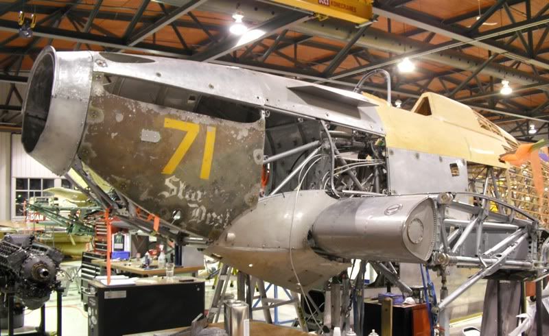

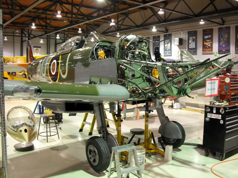

Lots of work going on in the hangar. The Spitfire engine is out for a good once-over.

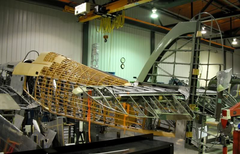

And the Mark XII Hurricane is starting to look like an airplane.
We even stuck the WWII nose-art cowl on it to make sure of alignment -- I doubt we'll use it in service, of course.
A long way to go yet, but a very great deal has been done. Those are newly rebuilt wings propped up beside it. I believe completing it will be a high-priority item for next winter. Right now we're busy with Annuals and other work, to be ready for the 2012 season.

Thanks for the close up on the cylinder work, don't forget a very teeny dab of ANTI-SIEZE on those threads. I'll bet you were the only guy in town looking for brass nuts and in this day and age stores don't stock stuff that just sits the shelf, and that sort of stuff can't be found @ HOME DEPOT AEROSPACE.

Those 1/4" brass nuts can be purchased under the Continental part numbers of either, 21247 or 22022. The A-65 Continental engines found on Cubs and other planes take these.

I did get a few photos of the Moth test flight. It was cold out on the ramp, particularly as it didn't start right away. The impulse mag wiring got sent to the other switch during the repair, so we were trying to start it on the wrong one. Took a while! But when we selected the other one on she fired at the first swing.
Dave

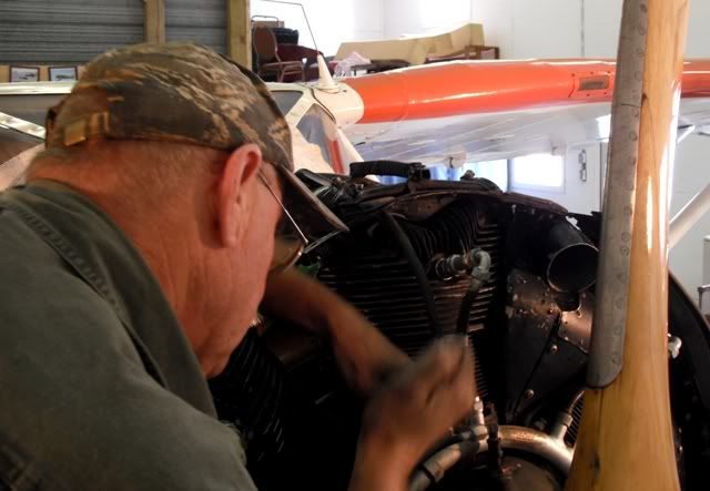

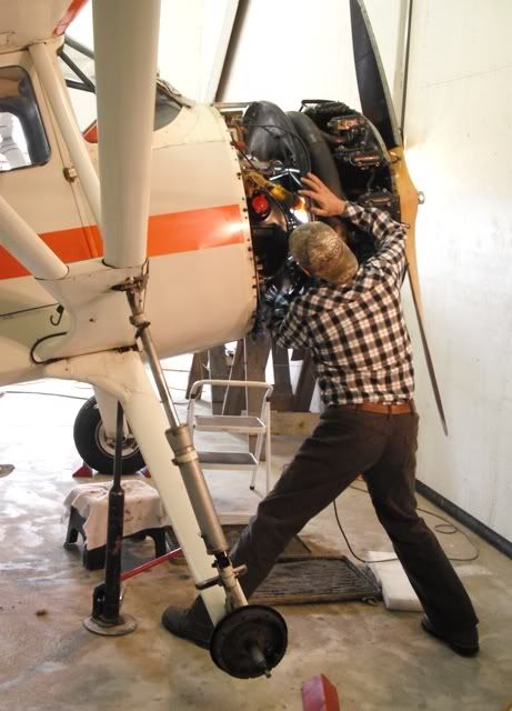

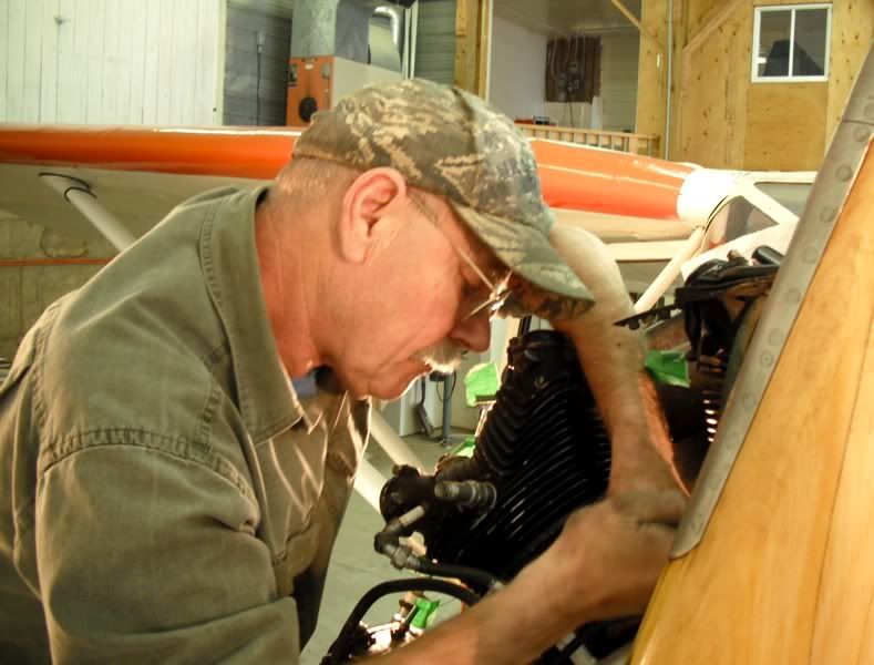

Finished the Annual on the Fairchild. Always grounds for relief! I pulled all the fairings and inspection plates, and loosened the rocker covers and so on, so Stan was able to get it done in one long day.
Here he is barking the skin off his knuckles putting the lockwire back on the oil filter screen. (Which was clean -- always good to see.) That's one of those jobs I'm happy to pay him to do -- very difficult to get at.

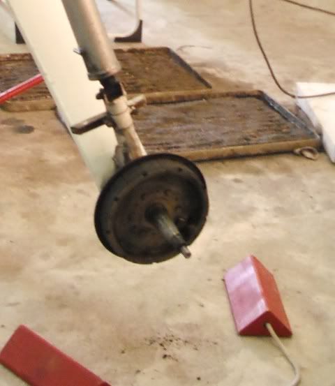

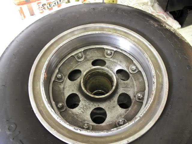

When we took the wheels off, I was pleased to see that the springs were not rusty. (The Old Spitfire Guy had troubles with that.) Probably the fact that it's a heated concrete-floored hangar has made a difference -- with him the aircraft was stored in an open-front hangar on a dirt floor. And the drums and pads were fine. Just pack the bearings with fresh grease (guess who got to do that!), and back on they went.
I've been very conservative with brakes since we bought it. I very rarely use them to "make an intersection". I let it roll, then do a 180. So far we haven't had any trouble with the hydraulic-bladders, and I don't want any.

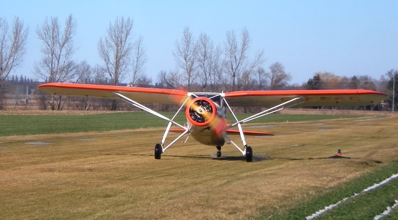

An engine-run revealed no leaks (er, no new leaks) and all well, so 2 days later I was joined by Matt W, a friend from the Edenvale Classic Aircraft Foundation, and we got it airborne.
First, I did a test-flight, solo of course. The weather was spectacular, a wonderful break, unheard-of in Mid-Feb around here. No snow, and temp was +5C. The strip was clear, with the ground still frozen, and most of the puddles still hard, although I tried to dodge them on each take-off and landing just in case.
Lovely to get her airborne again after a 3 month layoff!
All was well, so Matt hopped in, and we wandered away.
