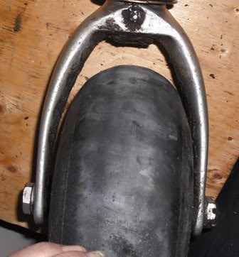

And the tailwheel had developed a shimmy, bad enough that I stayed on grass for the last several months of the flying season. So, this...
Now looks like this.
When I took things apart, there was quite a bit of play in the trunnion attachment bolts, both at the wheel, where you can see one of the sleeves partly drawn out...
And at the other end of the trunnion where it attaches to the airframe structure, and there are stepped sleeves. Both sets of sleeves have worn, and have allowed "play", and need to be replaced.
Dave

And the tailwheel was looking pretty bad...
So I have a new one coming from Dressler. (At a price that made me wince.) It's a 10.00 SC, and they're hard to find. I could have modified the rim according to a particular Kit, and used a more common profile tire which would be cheaper, but I decided to stay stock.
