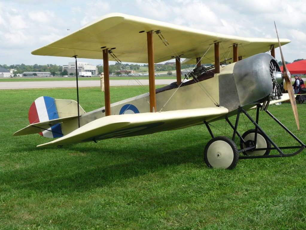

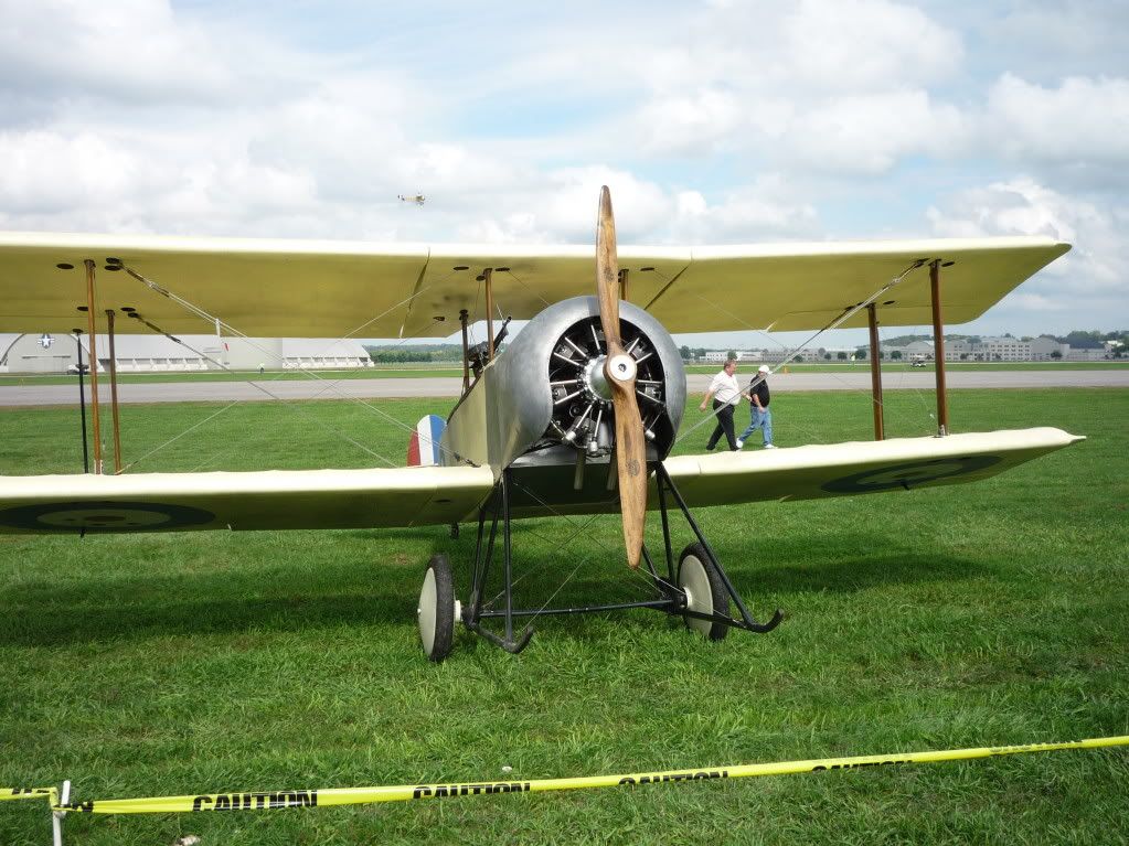

Quick update on the Sopwith Hamble Baby Landplane: Have just finished all the paperwork and N8184 is now registered and waiting on inspection. Have added the decking and replica Lewis gun. Here are photos of her at the Dawn Patrol Rendezvous:

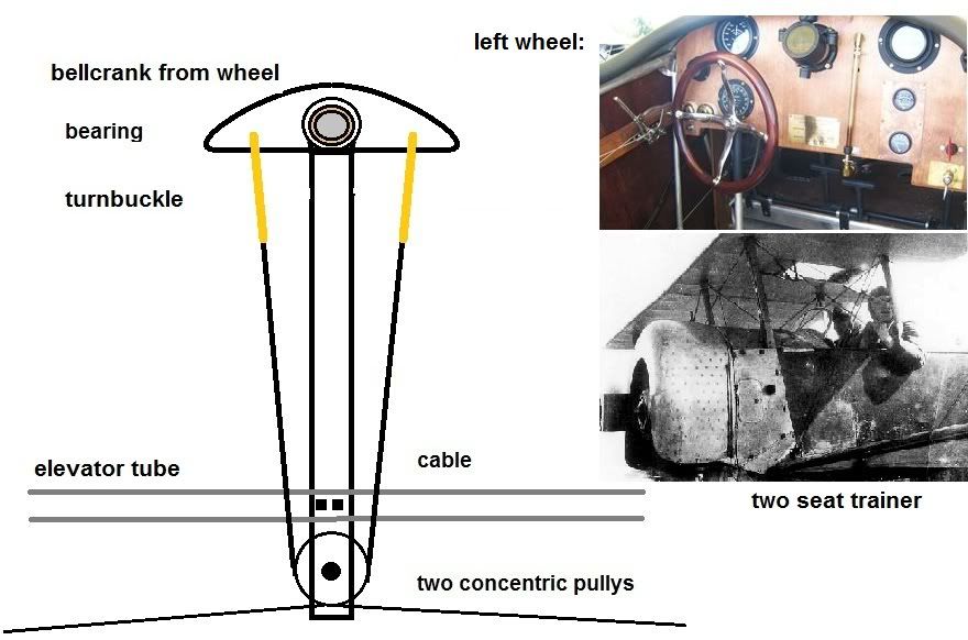

We've decided to go with an aileron wheel as the original tabloid/baby series. With my big legs, the wheel allows full aileron throw better than sticks, especially when two side by side. We will use a left sided pilot and right seated observer/instructor.
The concerns voiced have focused around aileron effort; Well, this is the original mechanics so the experience should be the same, which is the goal.
Similarly, the left sde also has a rudder bar to complete the experience, replacing the pedal assembly shown in the below photo of the work in progress cockpit...

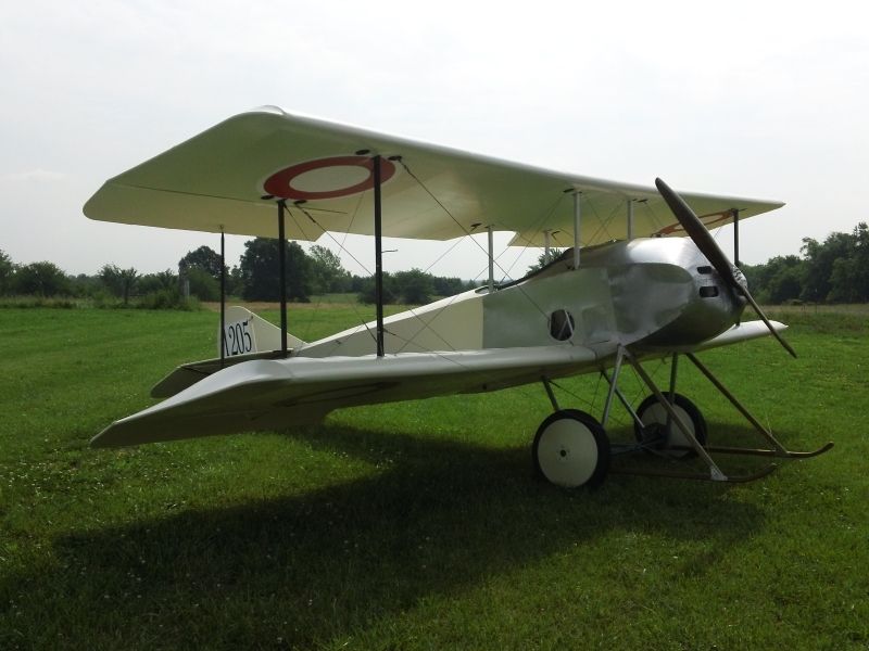

This replica is a prototype for a Airdrome Aeroplanes series of kits for full size replicas of the Sopwith Tabloid/Schneider or Baby. There are several suitable engines depending on version, and the aircraft can be built to a two place side by side if desired. The level of detailing is left up to the builder. This aircraft, N8184, will probably have very Cub/Champ like flight performance with the control character of the 1915 original airplane with the unbalanced ailerons and rudder bar. The use of modern materials in construction makes it a good deal safer than the original.
Attached is a photo of the Sopwith Tabloid version, this one a two place with dual controls, which received its Certificate of Airworthiness a couple of weeks prior with a Valley VW redrive engine and Culver propeller..
