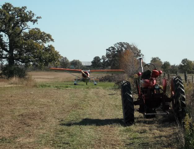

Then on South to the family farm, where I landed on the strip for the first time. It's a Moth/Stampe airstrip, 1600 ft, trees and one end, a fence at the other, and 30 ft wide. Some caution is required. But it all worked out.

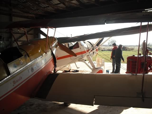

Work complete, we squeezed the Fairchild into the hangar beside tractors and the Stampe, and had a great dinner.

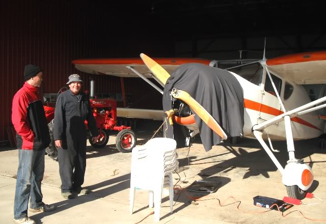

Next morning, in the frost and chill, we improvised some heat, and after an hour she started right up.
Last Friday she let me down. It was cool, about 8C, and I tried starting with no pre-heat. No luck. Pulled a few plugs and didn't like what I saw -- obviously I've converted a large quantity of lubricant into carbon. Cleaned them up, then back to normal -- a good start.
Regarding Warners, Andy, gentlemen, how often do you generally clean the plugs? Looks like about every 50 hours, to me.

Dave,
Since we only fly the Waco RNF about 50hrs a year anyway...that is when we clean ours. Our Warner runs rich (no mixture control) and generally the plugs are black but with no oil and very little Carbon build-up....unlike my Jacobs which are always oily and get carbon.

Beautiful airplane! I can almost smell the the two cycle oil and the fresh cut wood. It's nice to see the well cared for old Farmalls too. I can't afford an airplane but I have restored several old Tractors. Nice "A" and "H" there. Hugh

Yes, the tractor collection is pretty comprehensive -- Internationals from the 40s and early 50s. They're still working machines. The only diesel on the place is in the 3/4 Ton truck he uses to hauls the tractors around to shows. All the fieldwork is still done with the tractors I grew up driving. (I had a hell of a right arm at age 16 from wrestling with the "ball" on the wheel of a Farmall M. Wish I still had an arm like that.)
Actually, with the price some of these antique tractors are fetching, airplanes are beginning to look cheap.

Nice, A gasoline McCormick W6 with a loader. The gas start/diesel run ones, (WD6) the exhaust was on the other side of the hood. I have shed room at home for tractors and no room for a runway. I insure the few that I take to the shows for about $10.00 per year with a '67 Impala convert. and a '56 IHC pickup. An airplane needs an anual, hanger w fees and a wee bit more for insurance. But I would find a Navion if I didn't have other family matters to attend to first. Someday---. Renting a 172 is not all that bad. At least it's flying! Hugh

That is one tight airstrip. A crosswind could be just a bit of trouble!!! :shock: I love the old Farmall Cub, brought back memories! Drove one of those in my youth on our farm in WI, that and our big one, an Allis-Chalmers.
