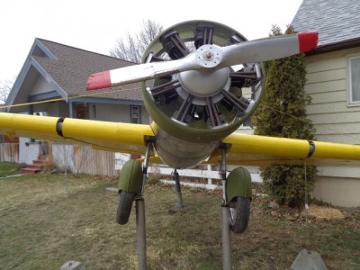

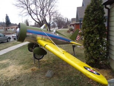

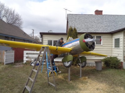

the plane is now mounted on poles in front of my house at 523 Stephens Ave in Missoula.
I will update the flikr account with new photos
