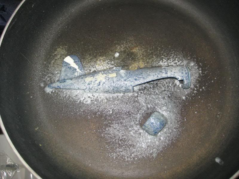

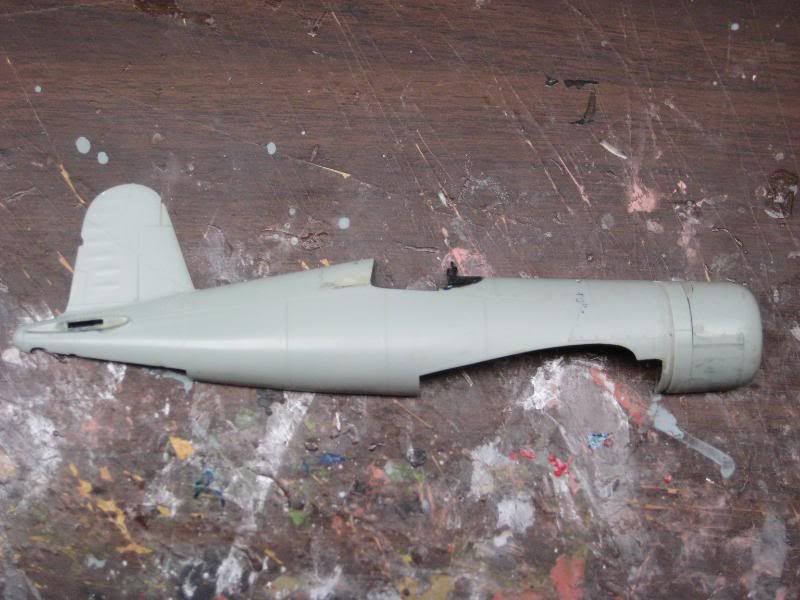

Believe it or not, I'm stripping an ancient 1/48th scale Otaki F4U right now. It's marinating in Easy-Off oven cleaner and it works great without attacking the plastic.
Test your Ferrari's plastic composition by spraying the cleaner on a bit of parts tree and let it sit for four or five hours. Then wash it thoroughly and inspect to see if the Easy-Off did anything to the plastic. Since your paint is fresh I would think a short bath in the cleaner would be sufficient. My Corsair was painted in 1979 and it's taken about three hours and two baths in cleaner to fully remove the paint. It may also require some light scraping with a soft tool (my thumbnail works perfectly). I've used it for both foreign and domestically produced models and never had a problem. One odd issue though--Easy-Off won't touch Testors flat black for some reason.?
The worn-out frying pan works great for a catch basin, BTW. :wink:
