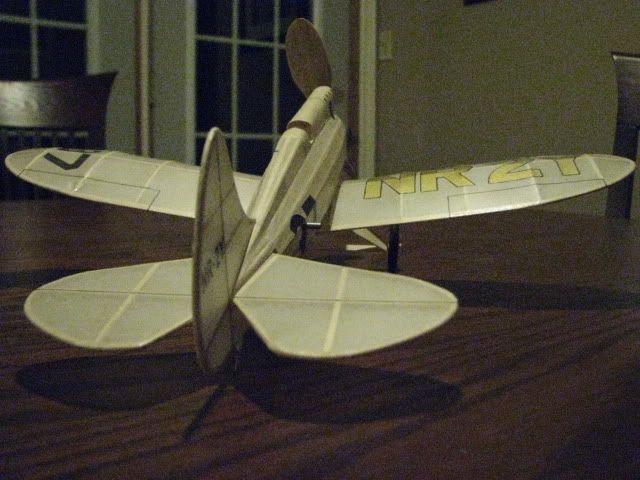

This is my latest effort, the covering was done using exactly the process described above, plus I added markings I cut from tissue before I sealed it with Krylon. Panel lines and stuff were done carefully with one of the thinner-inked ballpoint pens (a Sanford Uni-Ball, I think).
