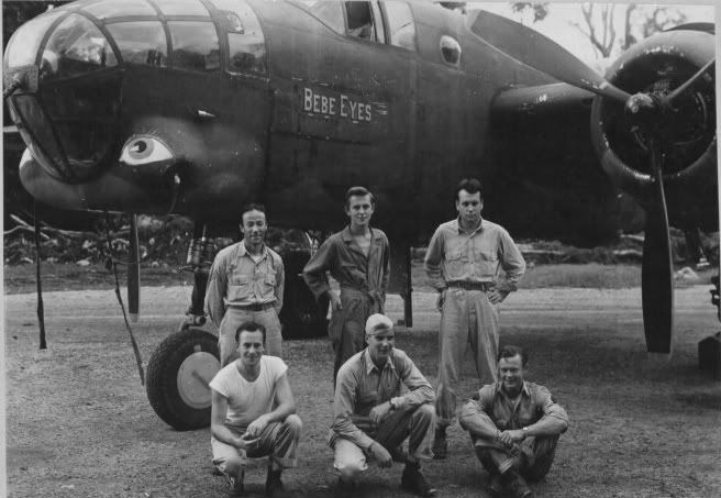

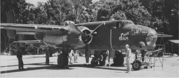

Couple pic's I have.
Mike

Thanks, Mike! Excellent! Any idea where those pics were taken?

18th Combat Mapping Squadron. Espiritu Santo, New Herbrides. Aug 1943.
